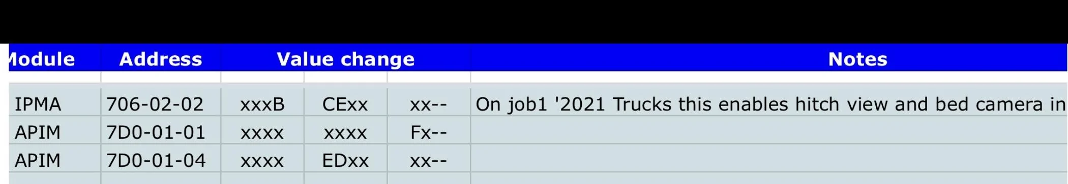

I’m pretty sure those with rear cam only would be able to enable rear cam in motion with Forscan. I’ll look at your vin @TJSparky and let you know what to change to enable it

@TJSparky
Make this change
7D0-01-04
03E4-8800-40XX

Thanks Jesse! I tried this but the dash went a little crazy when it was enabled. However that was with an older version of the APIM.
Nah. You don’t need any of that. Try the change I made above and you should be good. As long as what I see online matches what is in the truck

@TJSparky
Make this change
7D0-01-04
03E4-8800-40XX
Jesse- With the 40XX part, do I actually put in 40xx or is the xx saying leave what is already in place. My stock value shows
7D0-01-04 03E4 - 8000 - 4083
The XX IS THE CHECKSUM. It will auto correct the last two of each line is the checksum and changes
THANKS JESSE!! IT WORKS PERFECTLY! You Rock man!
