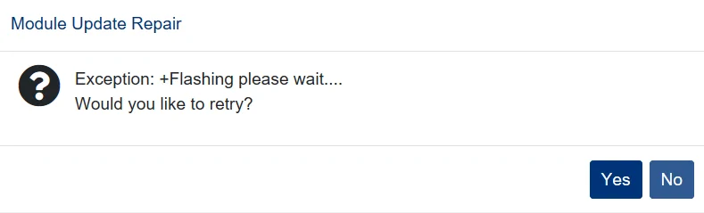

I'm having issues performing the TSB to get past the stuck APIM. The ethernet step keeps failing with Exception: +Flashing. Please wait....Anyone else have this issue? I'm wondering if it's because my laptop doesn't have an ethernet port so I got a random adapter for that side (the truck to ethernet side I used an approved adapter)

whats your exact error? seems similar to what i experienced at first and had to try a different computer. it wasnt actually the cable, but either my old comp, or the drivers or something.
Hey when you had to switch computers (I'm going to need to do this too) is there a specific process to that? Or just reinstall everything, logon and use the same license code?

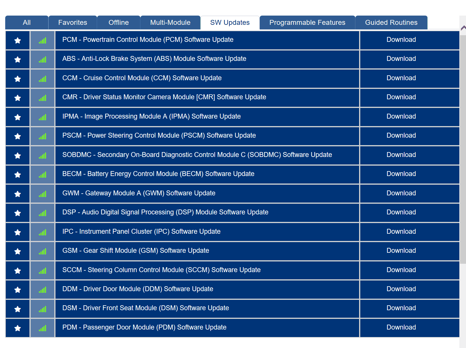

Another question. SORRY for all the questions. So if I get the adapter and it shows all these updates. Is there an order that they should be installed. Thanks.
yes, you need to remove the license from comp 1 before you can use on comp 2. check the menu in fdrs.
I start with the gateway module (GWM) if an update is available. If an order is required for the others, FDRS will let you know.
turbopilot
Sep 8, 2021
743
1,224
Prescott, AZ
2023 F150 Powerboost
In my case GWM was not available until I installed the first APIM. During my 2 day process there were several times selecting one module installed 2 or 3 modules with the same download. All very confusing for a newbie because the same modules would reappear again after installing other modules. In the end I think I installed the APIM module 3 or 4 times. All a blur now but I felt like it was never going to end as the same modules (obviously with a new version) kept popping up.
So true. Basically FDRS will have updates that are prerequisite for others, so the others aren't available until the prerequisite updates are performed.
The APIM is a great example because you won't see the APIM update that follows the one you DO see until the one you see is performed. FDRS won't let you skip ahead.
As stated, the Gateway module is always one to do when you see one available because all the modules on the truck rely on the role the gateway module plays in the update scheme. Think of it as the router/switch to the various networks onboard. You have an ethernet network, a USB network, and a few CANbus networks.
Another module I jump on is the TCU. It's very critical too for the truck to communicate externally via cellular or WiFi.
Next I like APIM updates because of its crucial role and its the one we most interface with from a screen point of view.
Following those 3 I love to see anything that the IPC and IPMA have to offer because they are feature rich visually.
