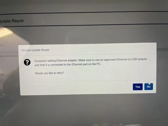

My truck was at the dealer for 2 weeks and they assured me bluecruise was installed. Of course my truck is still stuck on 1.7 with the grayed out update button. I decided to take matters into my own hands and bought the mongoose, required adapters, and frds license. I am able to get most of the way through the module repair utility and keep getting stuck on the part where I plug in the Ethernet cable/adapters. I tried 3 different adapters including the star tech that’s listed in the TSB. Has anyone successfully run the module repair using a Microsoft surface? Any help is appreciated. And if anyone in the Houston area can help get me unstuck I’d gladly compensate for your time. Here is a screenshot of where I’m getting stuck:

Many folks here got past that point without ever using the TSB method. Have you tried the traditional update method in FDRS?

I was lucky enough to get past 1.7 the old fashion way before the TSB came out, so I can't say I've been down that road before. But I do have a brand new windows 10 laptop and dozens of USB adapters for work, so I'de be happy to take a swing at it if you want to come by one evening. I'm on Grand Parkway south of Katy and north of Sugar Land.
