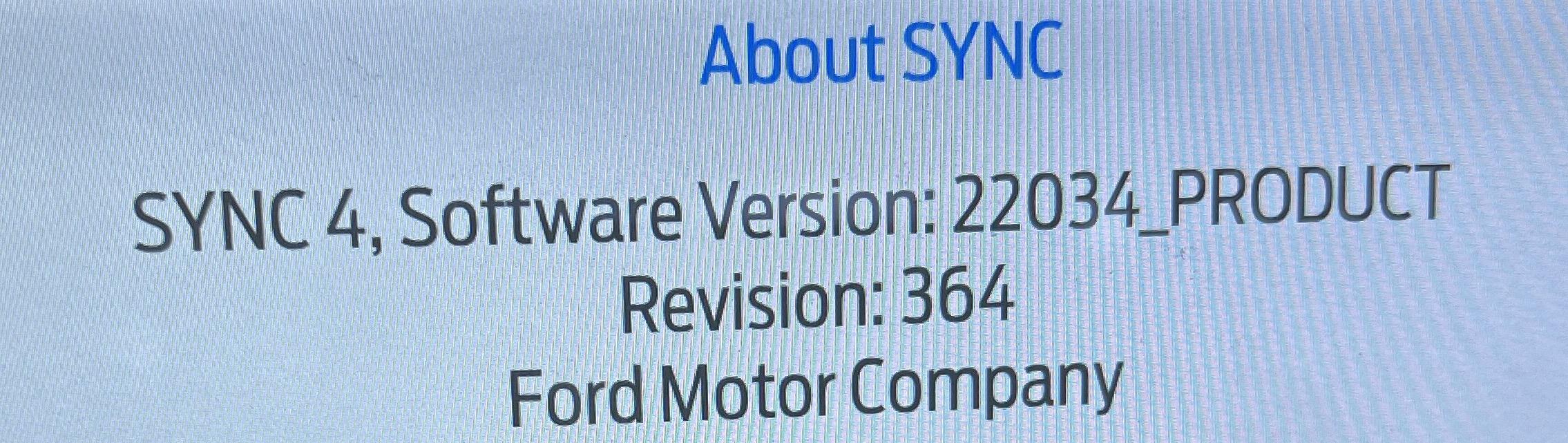

Success. GWM finally loaded followed by a new APIM update that loaded fine as well. Took three days before Ford would allow the final GWM update that turned on BC.
Thanks to all on this thread that made it possible for an FDRS newbie to get this done. I started this process just to get the APIM/TCU unstuck for OTA updates. I got it unstuck with FDRS but overnight no OTA action so I decided to proceed to get BlueCruise working. Two full days of turning the truck off and on.
Things I learned:
* Best to have a fast, up to date Windows 10 computer.
* Fast USB thumb drive
* Fast internet connection
* A power maintainer to keep voltage over 13.
* A lot of patience.
* If you are starting from the stuck 1.7.1 update there is no way to bring the truck up to BlueCruise using the $50 two day FDRS license.
I have a tech background but no experience with FDRS or Ford module updates. Everything I learned for this effort came from this forum. Thanks to everyone giving me a hand.
