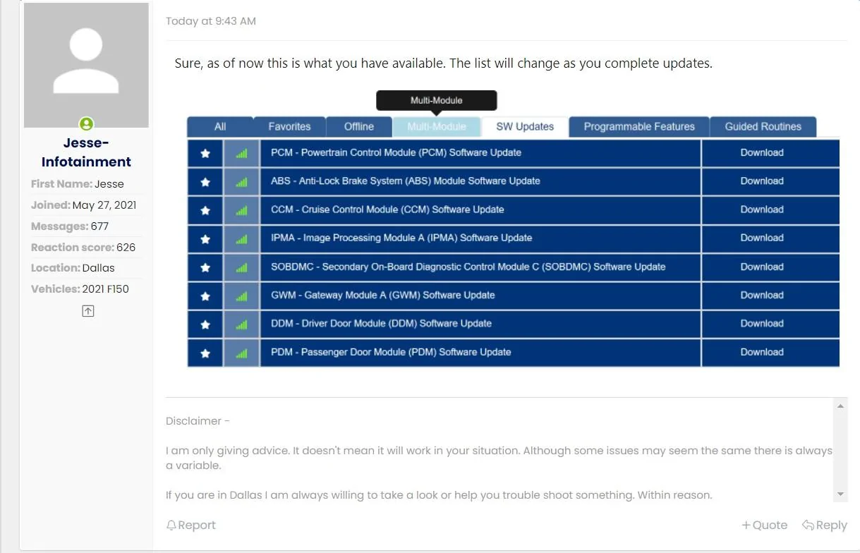

A couple of days ago you ran my VIN# and came back with these available updates. I have a 2021 job 2 truck, is there any issues you can see with me doing these updates? I'm not planning on doing them right away, just trying to get up to speed with the whole FDRS process. Thanks......
Ford F-150 ECU module programming guide using FDRS Screenshot_6

@Jesse-Infotainment
No.. just take your time and follow the advice on here. For the updates you have stay away from the nano.
