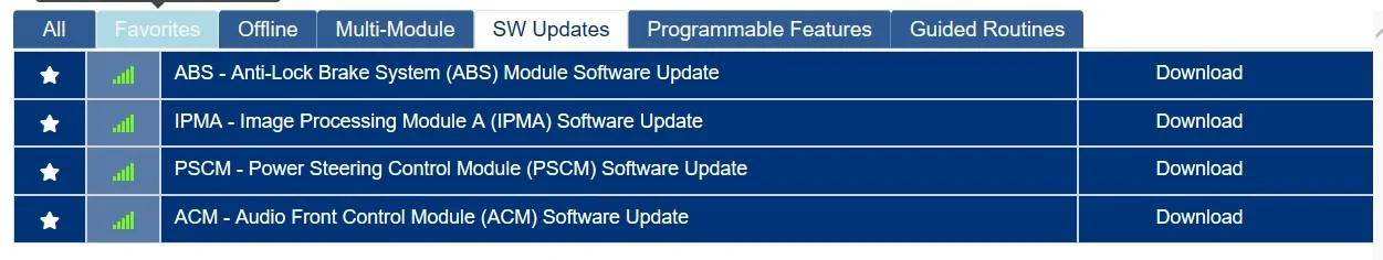

So I've been stuck on 21281 revision 244 with my 302A for 2-3 weeks. Checking FDRS every other day and nothing new was showing up.
For some reason, an IPMA + PSCM update showed up today (ABS was a few days ago, just didn't do yet):
Is this IPMA update safe with a nano (I don't have a CCM to brick, no adaptive cruise here). No reports of anything being bricked outside of the CCM yet so seems so... (was eventually going to get a Mongoose still but its been out of stock and the price in Canada is fun)
So nobody ever done PSCM with a Nano? These updates are calling to me to do them :LOL:
