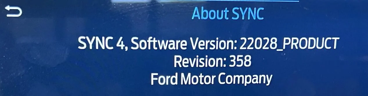

With the help of all these posts I was able to do the TSB-2150 APIM/TCU update and unlock the truck for updates myself.
Racing against the $50 two day clock, I have made my way through a full page of FDRS software updates. I have looped through three APIM and GWM updates. Each time the GWM fails on first try then runs after the truck rests for a while. I am now up to Sync4 Software Version 22028_Product, Revision:358.
Seems every time I finally get the GWM update to run a new version of APIM pops up. My $50 ends tonight so I may have to buy more time if the GWM module continues to not update. Still getting close to Blue Cruise.
Based on your picture, you're only 1-2 updates away from BlueCruise. I think there's only one APIM update more for you. You should be able to finish tonight if the truck cooperates with you.
