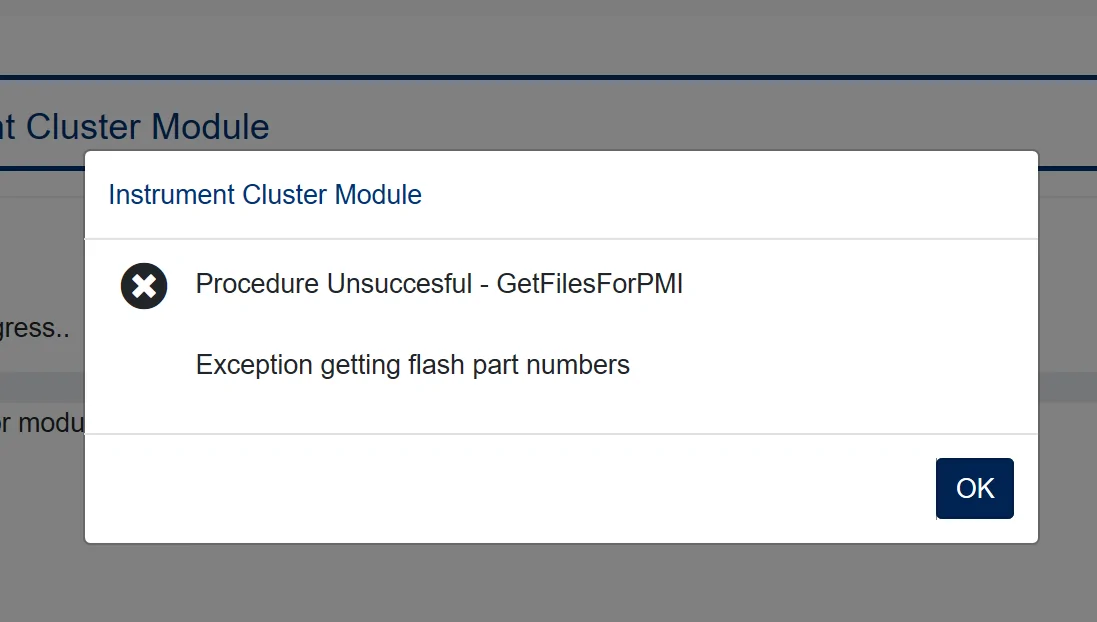

You are where several people were. The FDA is loaded. That’s actually a good thing because it’s the large file. The 188 should be fca and takes about 4-5 mins. You can try a PMI and see if it will now load the fca. If not we would have to side load that file. Yoo poop u won’t get any further until the cluster has the 188 is at fca
Thank you for looking at it! I just tried to do a PMI and received the attached error.
Ok. Well get with me and I can work with you to side load it.
