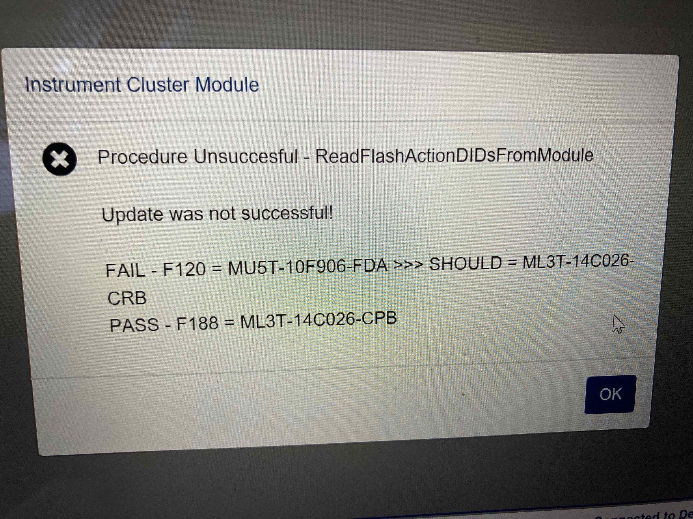

I finally had a chance to spend the day yesterday with a Mongoose and FDRS license. I have a 2021 job 1 and was hoping to finally get BlueCruise.
I had about 15 updates to install. There was no APIM update listed. All of the updates installed successfully with the exception of a GSM update that won't seem to go away and my Instrument Cluster Module. It gave me the attached error and then the update disappeared from my list. My sync version is still revision 244.
I saw a previous poster had a very similar issue a couple weeks ago and reported it solved, but I'm not sure what the resolution was. Any ideas on how to keep moving my updates forward? Thank you!!
VIN: 1FTFW1ED0MFA94376
Did you follow the sequence of module updates shown in the procedure? Jesse-Infotainment may be able to provide some insight as to what needs to happen now. I can tell you that when I started doing my updates my Sync version was already at 244. Based on guidance I got from this forum (before the procedures got published) the sequence was GWM, TCU, and then IPMA, etc. and whenever another GWM update popped up, to always do that one next because the GWM is the key to everything communicating together. And then it was just whack-a-mole until they all got done.
You are where several people were. The FDA is loaded. That’s actually a good thing because it’s the large file. The 188 should be fca and takes about 4-5 mins. You can try a PMI and see if it will now load the fca. If not we would have to side load that file. Yoo poop u won’t get any further until the cluster has the 188 is at fca
