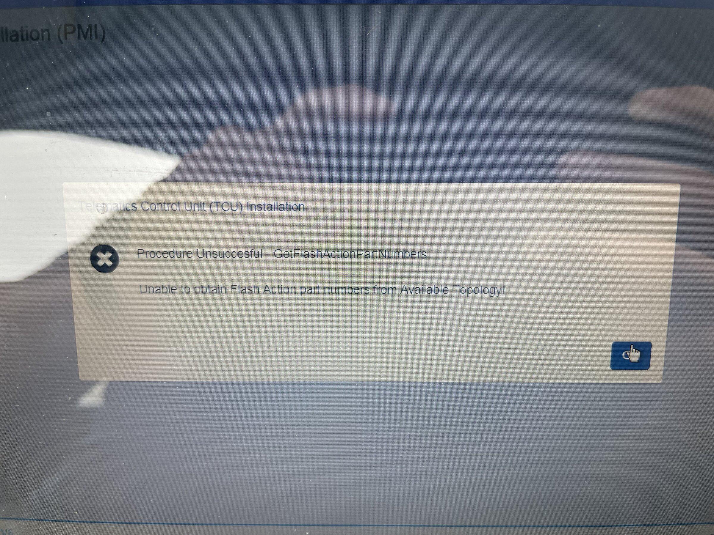

Attempted to do a PMI on the TCU and got this message… ??‍♂
I had this issue when i tried to update too far away from my wifi. May want to log out log back in and refresh the update/download and try again. Make sure your within wifi range.

Oh maybe. Ill retry later. I was connected to my phones hotspot when i tried. Didnt have full bars. That could be it.
