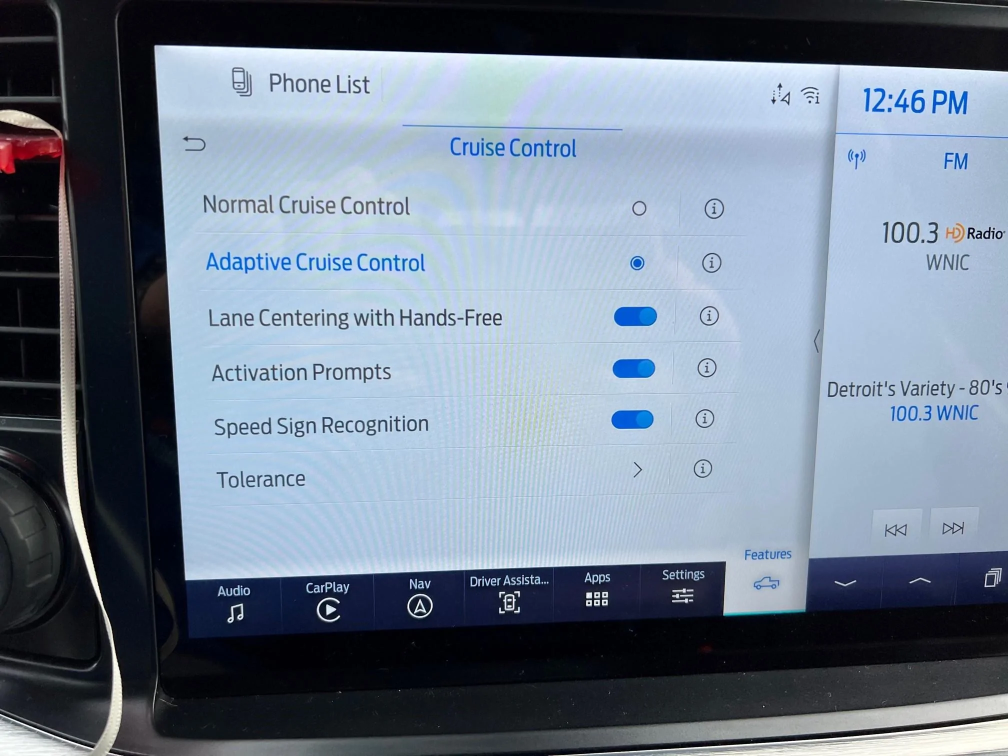

Now that I'm all caught up now SYNC4 (22181) I noticed a few changes.
  • New Audio Screen design.

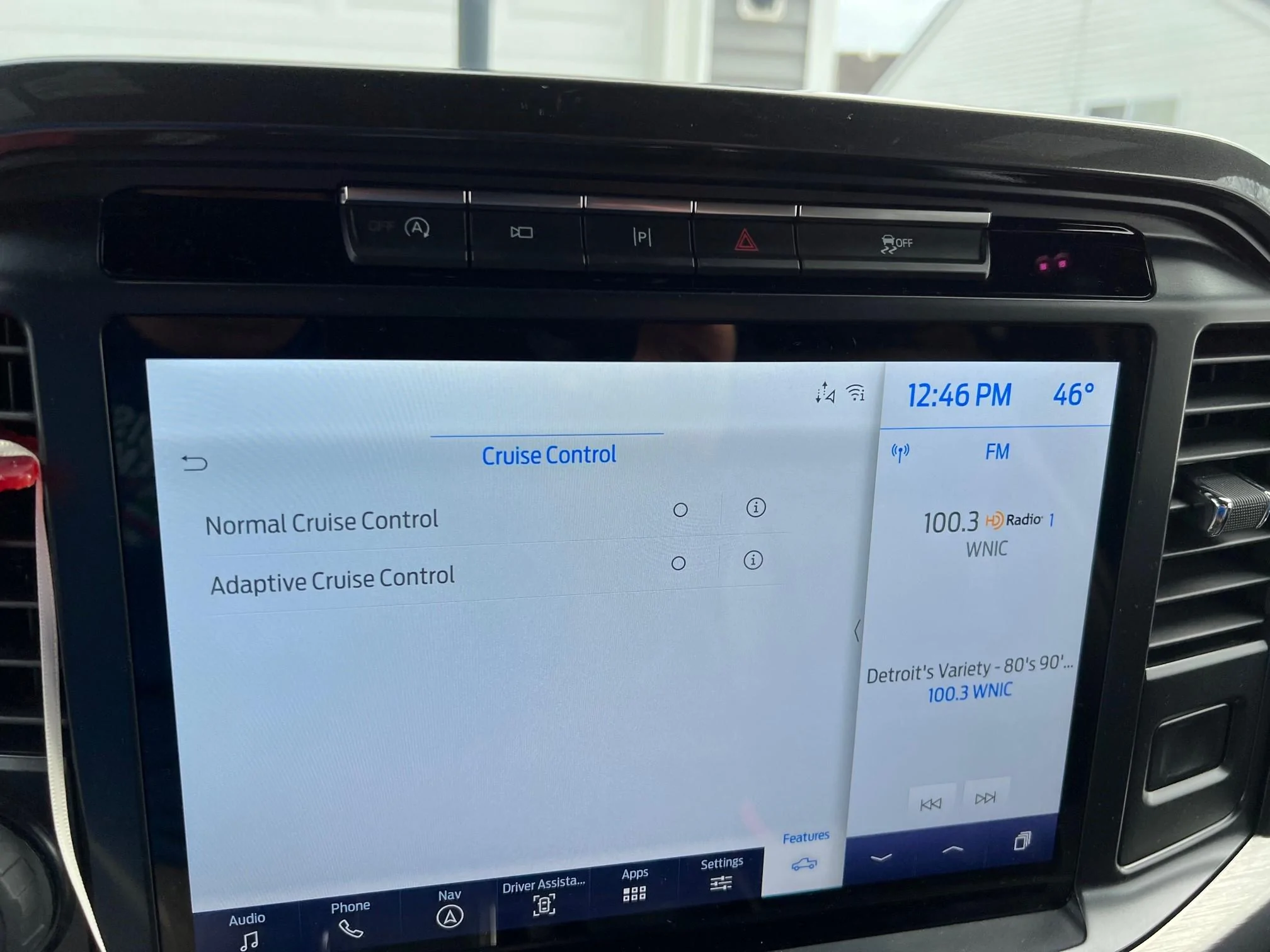

  • As mentioned above the Cruise Control menu bug exists but I'm curious if others noticed their Intelligent Cruise option is missing?
    Ford F-150 ECU module programming guide using FDRS 1
    Ford F-150 ECU module programming guide using FDRS 2

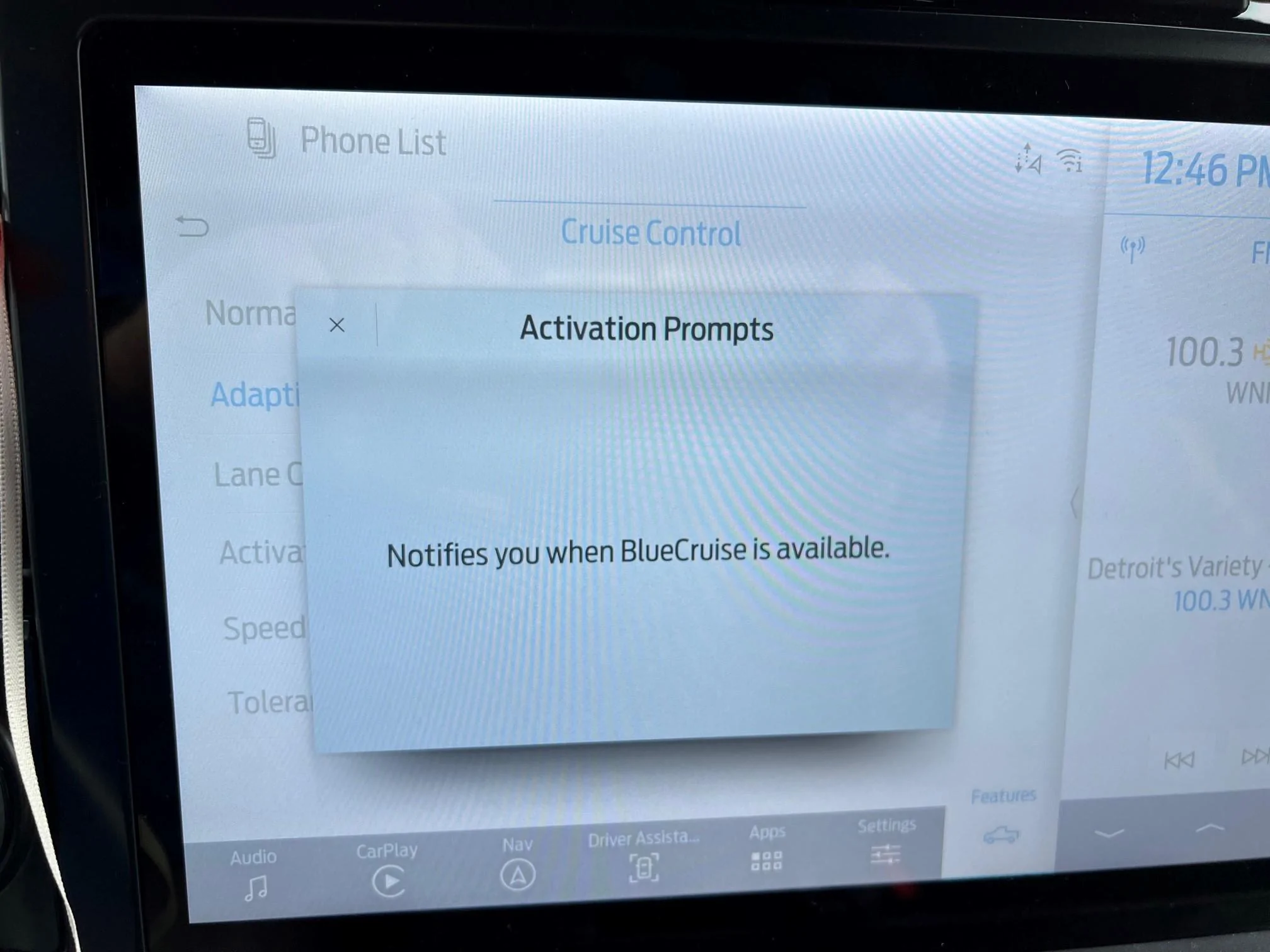

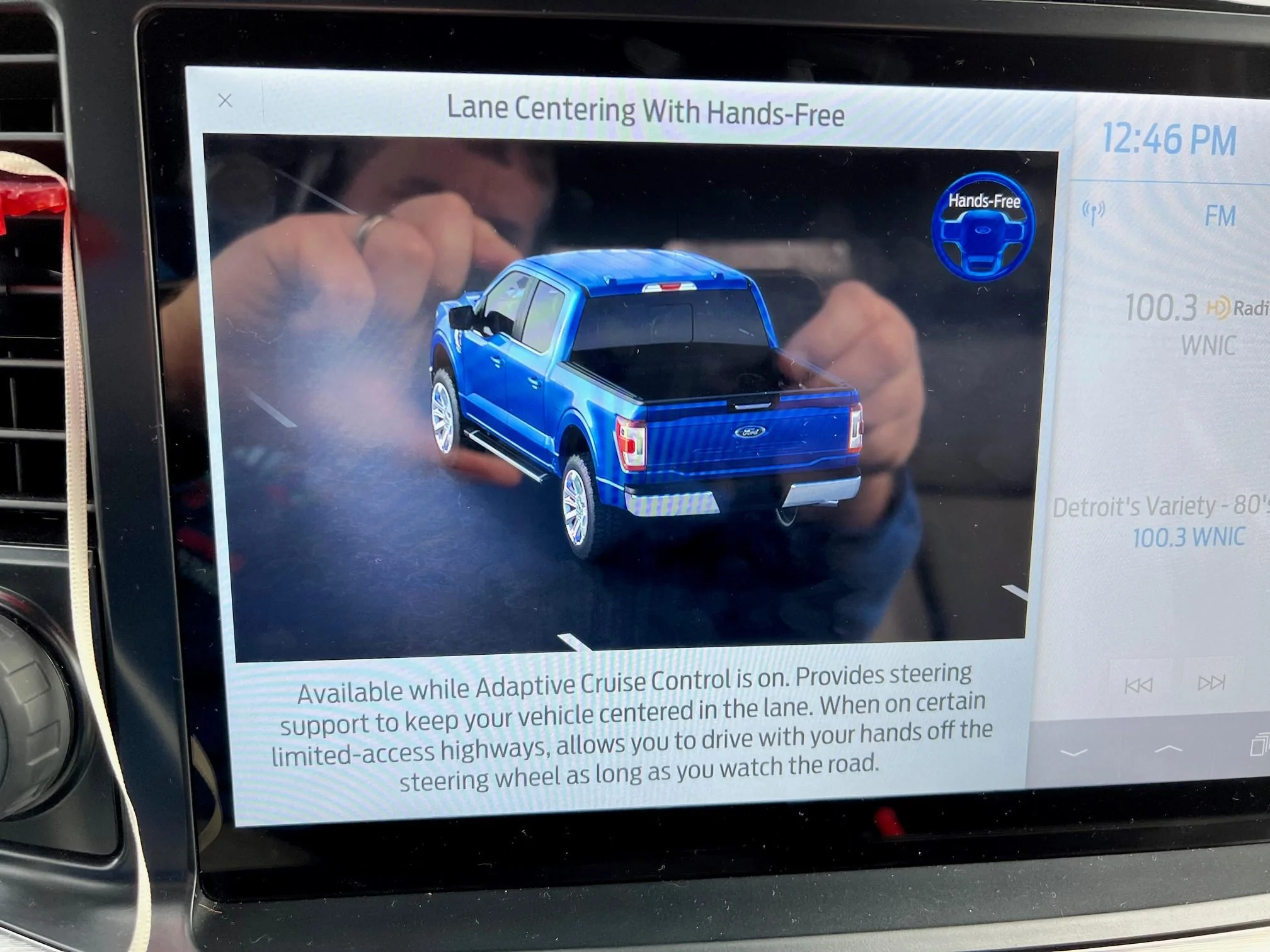

  • It seems this build is ready for BlueCruise.
    Ford F-150 ECU module programming guide using FDRS 3
    Ford F-150 ECU module programming guide using FDRS 4

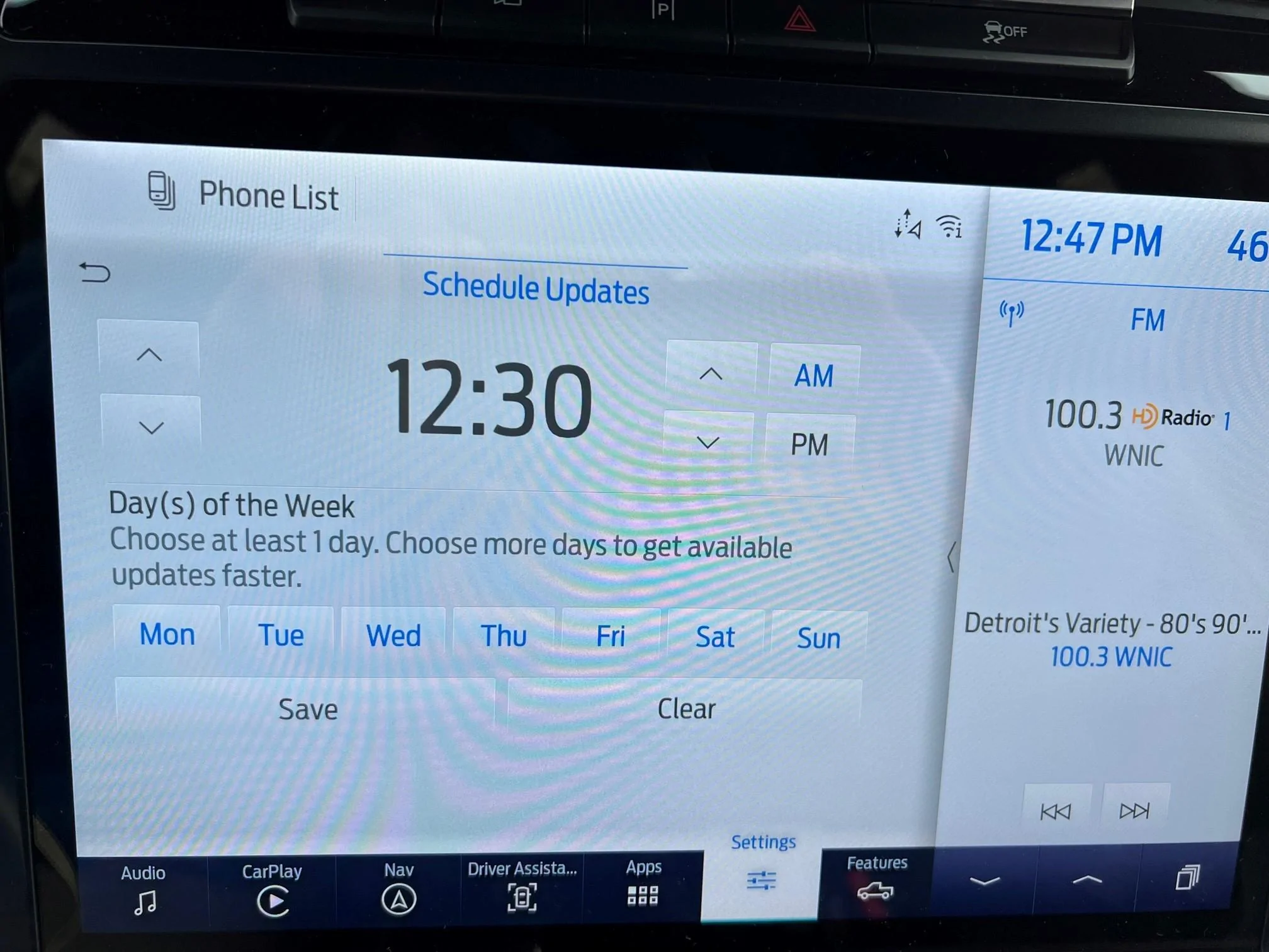

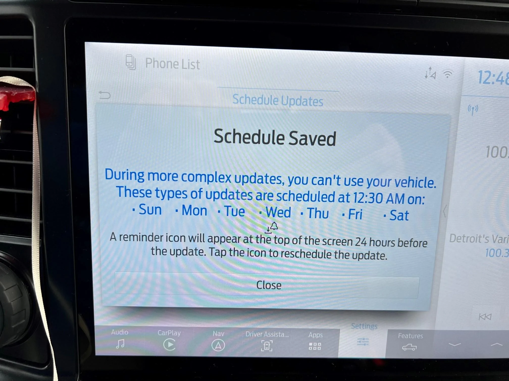

  • The Update Scheduling page has been redesigned and allows you to select multiple days during the week.
    Ford F-150 ECU module programming guide using FDRS 5

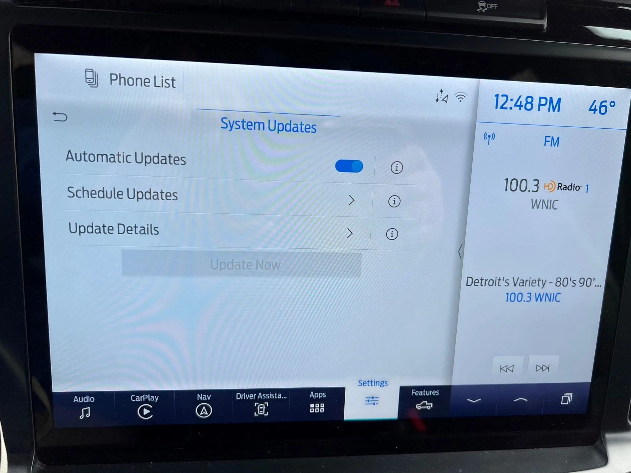

  • There is now an Update Now button
    Ford F-150 ECU module programming guide using FDRS 7

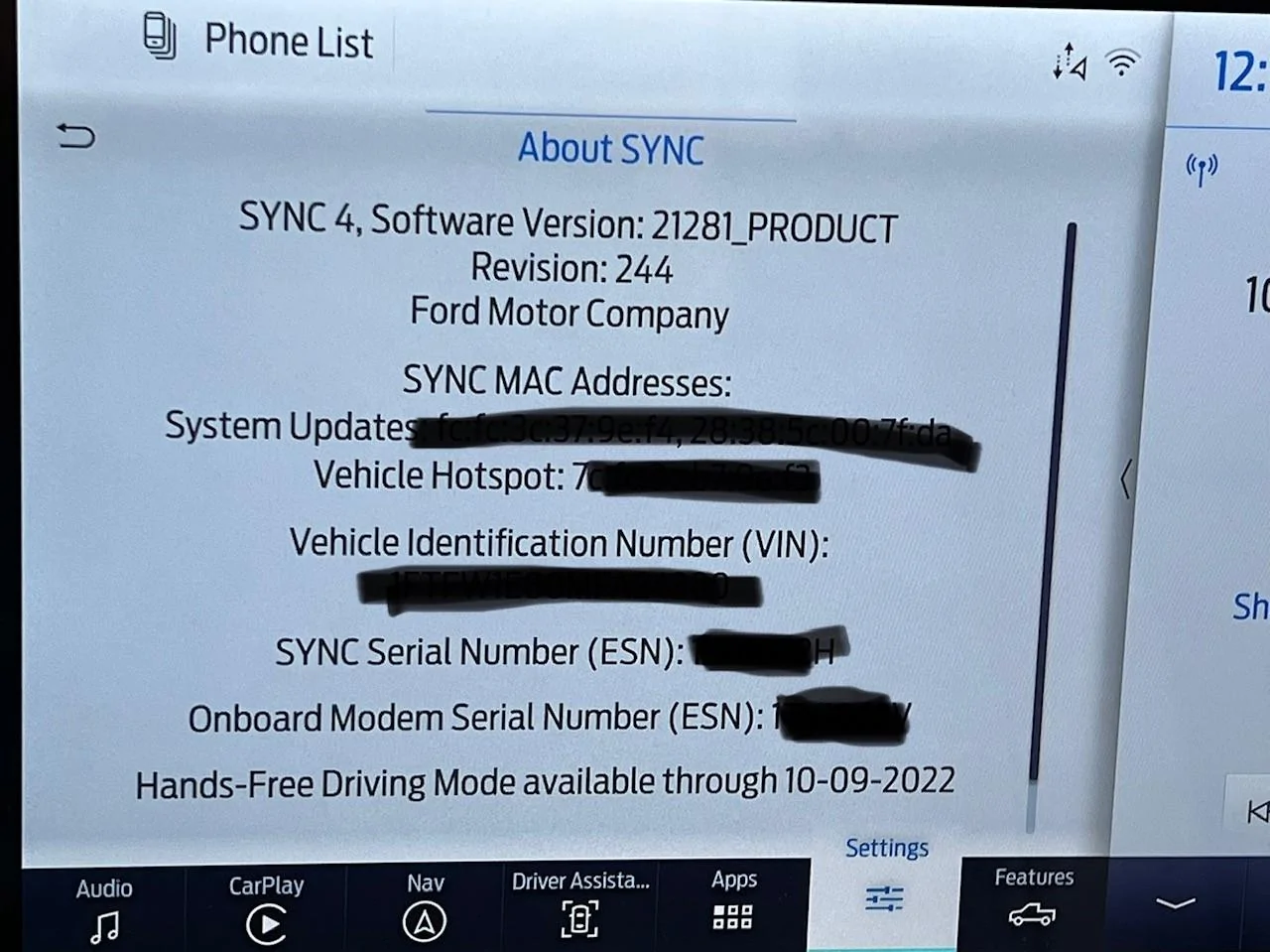

  • I noticed a new line at the bottom of the Versions page :)
    Ford F-150 ECU module programming guide using FDRS 8
