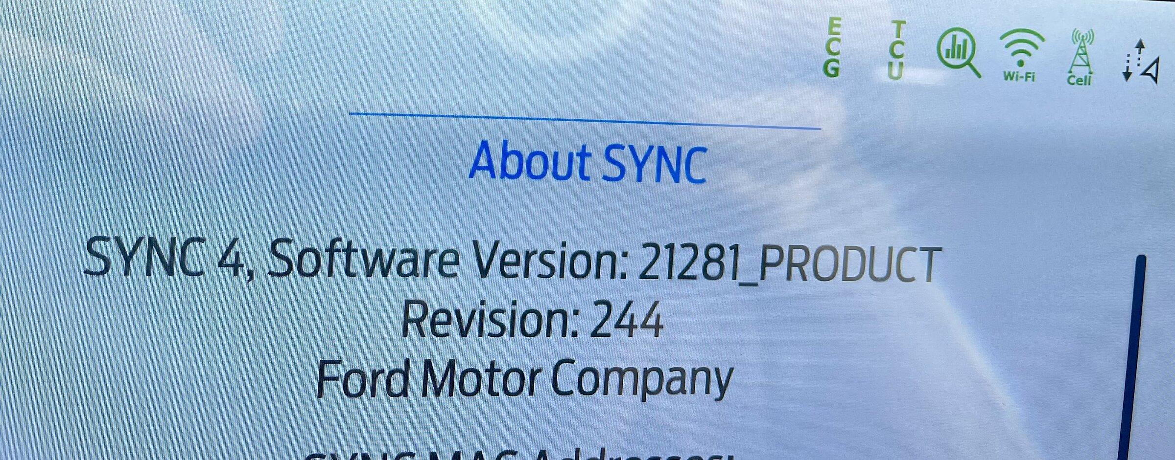

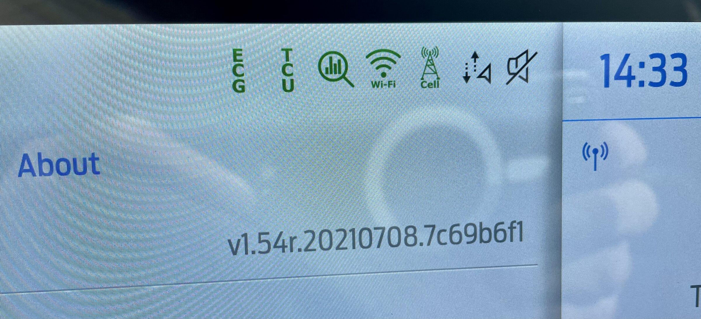

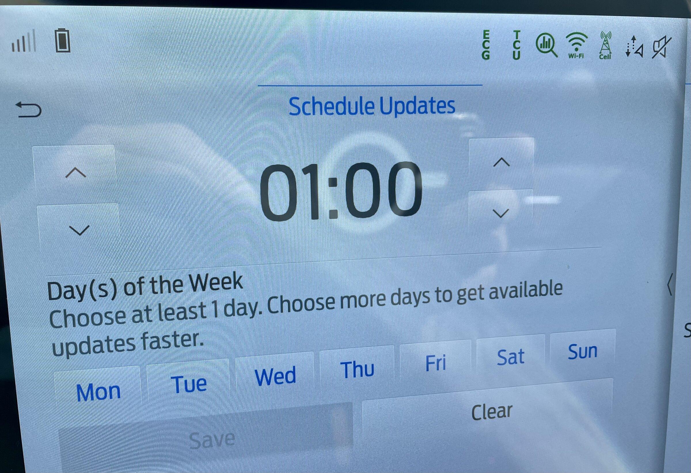

Now that I'm all caught up now SYNC4 (22181) I noticed a few changes.
  • New Audio Screen design.
  • As mentioned above the Cruise Control menu bug exists but I'm curious if others noticed their Intelligent Cruise option is missing?
  • It seems this build is ready for BlueCruise.
  • The Update Scheduling page has been redesigned and allows you to select multiple days during the week.
  • There is now an Update Now button
  • I noticed a new line at the bottom of the Versions page :)
I might be wrong but I believe all we need is the IPC and possibly CMR updates for BlueCruise to be functional on Job 1's.
This is really interesting! What your SYNC is showing is consistent with my 2022 F-150 with active BlueCruise. My old '21 Job 1 truck did not have "Lance Centering with Handsfree" (this option actually activates BlueCruise. The "Activation Prompts" just notifies you on your IPC that you are driving on a road that is BlueCruise approved and you can activate it by pressing the Cruise Control button on steering wheel. It has nothing to do with BC feature activation.
Also, BlueCruise is suscription based service that needs activation (just like your connected navigatation). You should get a BC activation notification in your FordPass app.
