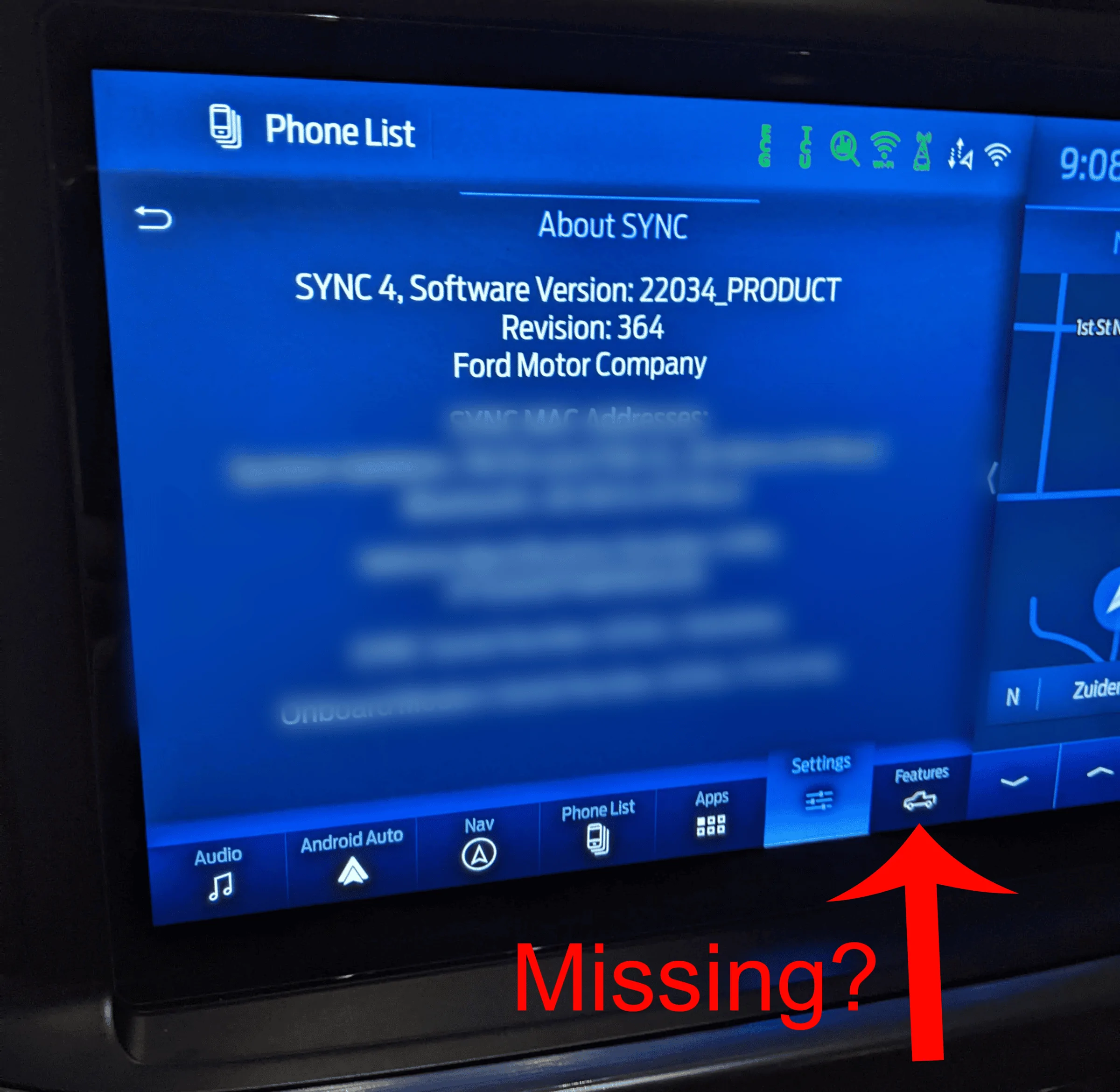

Well I have an odd issue that creped up after I finished my updates to get to APIM v22034. My "Features" is missing. I was there for a few days and now it's gone. No additional updates or ForScan changes have been made since this photo was taken. Anyone else have this? I attached my APIM AsBuilt data from ForScan.
Ford F-150 ECU module programming guide using FDRS apim_missing
The asbuilt shows the Features Domain Button (Not Present)
You would need to change
Alexa HMI (AHMI) • OTA Automatic Updates HMI (OTAAUHMI) • Features Domain Button (FDB)
8 =AHMI Enabled • OTAAUHMI HMI Enabled • FDB Not Present
9 =AHMI Enabled • OTAAUHMI HMI Enabled • FDB Present

Perfect, thanks! I changed that weeks before I did my updates. It's odd it just took now.
