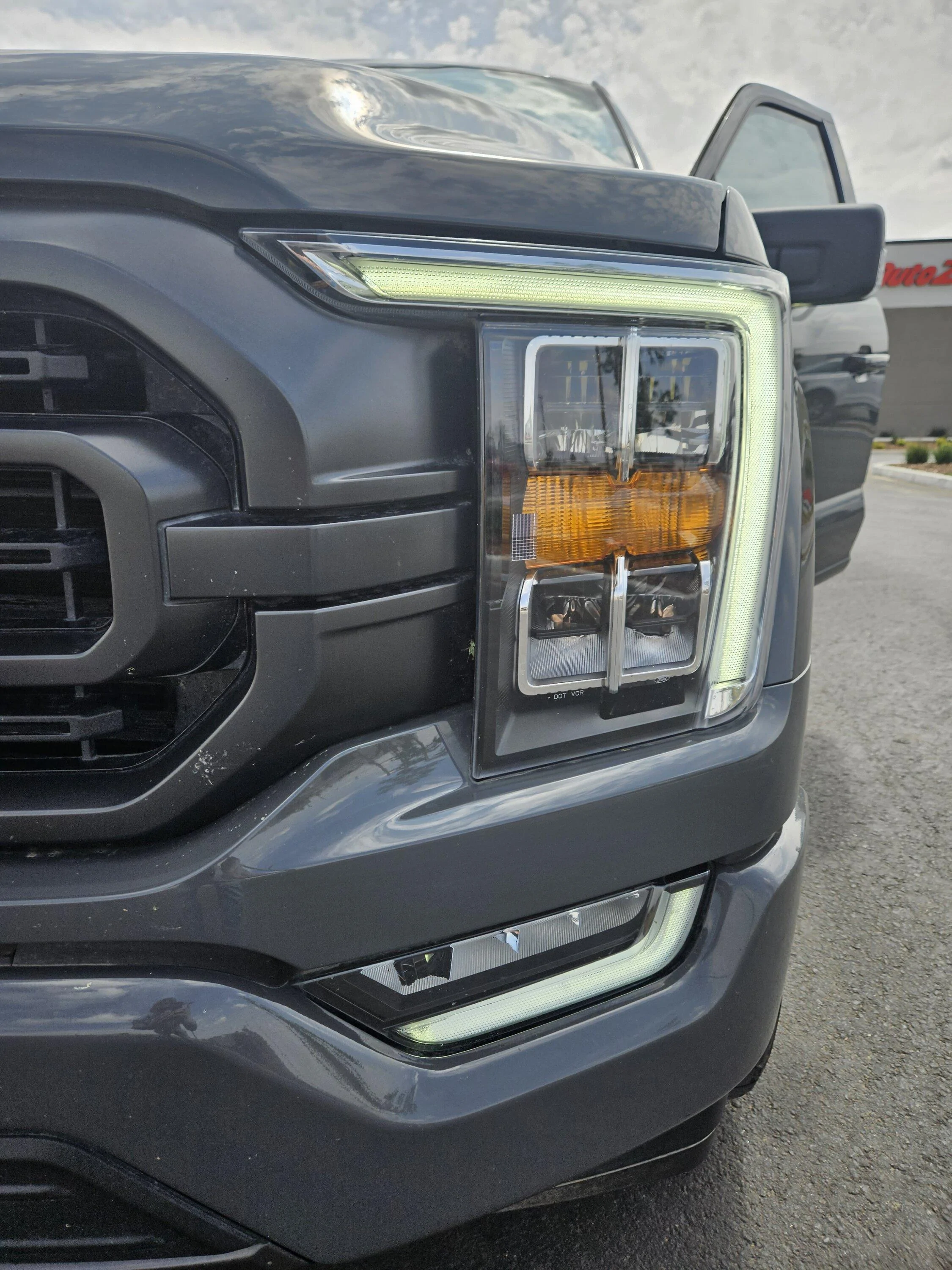

Partially out passenger side DRL on quad beam LED headlight. I know other threads have associated this issue with a previous bad BCM update, but what ended up being the remedy here? Is replacing the module the only fix? If so, what does that entail? I can't get into the dealer as they are weeks out and can't offer loaner vehicle. Would appreciate any guidance.
2021 XLT 3.5 Eco
VIN 1FTFW1E84MKD08344
Hi, I have the same problem, the side lights started almost at the same time which didn't bother me since both lights looked the same but now I started to lose the upper part of the driver's side. My truck is from 2021 and is obviously out of warranty. The extended bumper-to-bumper and top-to-bottom warranty does not cover lights either. The estimate for the replacement at the dealer is almost $6000.
Ford F-150 DRL Issues IMG_7077
I wonder if this is caused by sitting in the sun / heat issue? For yours to fail so closely together is interesting.
