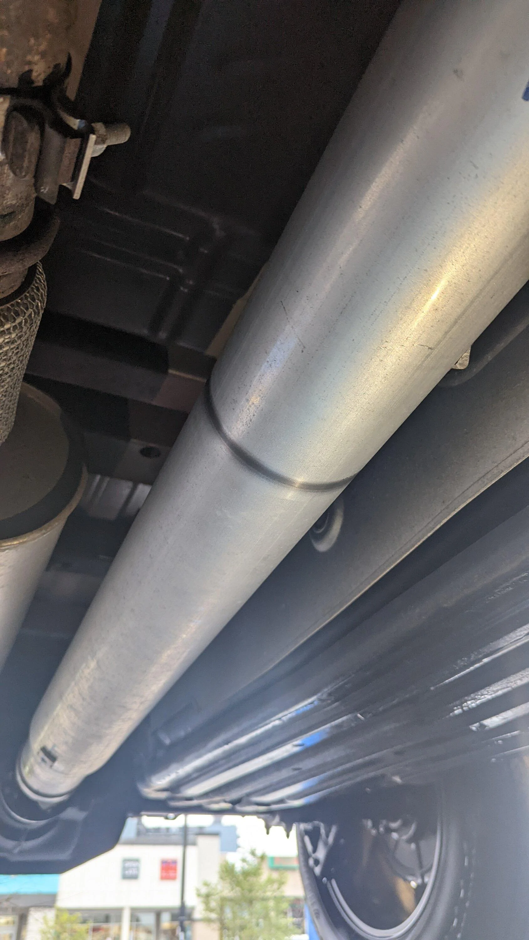

Hi Everyone,
I picked-up my 2021 F150 (2.7L) in June of 2021. In August of 2021, I started having trouble with the driveshaft (shaking at highway speeds, rough idling, loud cracking noise whenever the truck turned into a raised driveway, etc.). Dealer #1 did the typical Ford dance (couldn't recreate the problem, etc.), but suddenly when the driveshaft recall was announced in early 2022 I was told that by Dealer #1 that my truck failed the driveshaft inspection, and shouldn't be driven. A 'unit down' was issued, and I was told to wait until a driveshaft arrived.
Once my driveshaft 'arrived', I dropped off the truck at Dealer #1 - but was then told that there was an error in their system and that the replacement driveshaft hadn't arrived (and it could be weeks before one was available). I was told that another nearby dealer (dealer #2) had a driveshaft on-hand.
I went to dealer #2, and they confirmed they had a driveshaft and held the truck for the day to complete the replacement. When I returned to the dealer at the end of the day, they indicated that they did not have time to replace the driveshaft that day and asked for me to come back. At this point, I was hugely disappointed.
Here is where the major problem starts... The tech was taking forever to give me my paperwork. Then he looked me square in the eye, and said that he couldn't claim for the 'time' they spent on the driveshaft that day, because Dealer #1 had already claimed the driveshaft diagnosis time with Ford. He said that the only way that Ford would reimburse Dealer #2 for their 'time' was if they closed the recall indicating the driveshaft was 'fine'. I was told not to worry, I could just apply for a new driveshaft under a separate 'warranty' claim! I disagreed, but they proceeded to CLOSE the recall file, and now I am stuck.
I am now driving a truck that I know has a bad driveshaft, and have been told that I have to bring it in to get it inspected for the SIXTH time, to start a warranty claim! I have no doubt I will go to the back of the line on the driveshaft backorder list, which means months more of waiting.
Please take a look at my driveshaft (below), and tell me if this is safe to be driving around (notice the 'pitting' of the aluminum on the right hand side of the groove). This truck is shaking when on the highway, and idles like a 1970s Mack truck... We are supposed to leave on a long-planned (and paid-for) cross country trip with our RV, and I honestly don't feel comfortable - but don't know if it's me overreacting to the driveshaft risk, or is the driveshaft is actually fine (please see the picture)...
BTW: I have called Ford Customer Relations and opened a file, but they have been useless so far. They have indicated that it's not possible that a dealer would indicate that a driveshaft is 'okay' after another dealer deemed it unsafe. I am being encouraged to go back to the dealers that got me into this mess, which I am not very eager to do...

Finally an update! It's been a very long haul, but...
- Dealer #1 (where I purchased the truck) brought in the local Ford rep to inspect my truck. He indicated that the driveshaft did *not* need to be replaced, despite the rather deep scoring, because the tolerance level of the recall had been updated. Apparently, the driveshaft has to be 'really' damaged now, to qualify for replacement.
- During the inspection, the Ford rep indicated that Dealer #2 had cut-off my insulator shield (aka heat shield) that runs between the driveshaft and the floor. He indicated that he would order that and have it replaced.
- They also noted the the rear shocks, bushings and leaf springs were defective and ordered all to be replaced.
- It took multiple weeks, but eventually all of the parts arrived.
- It was in the shop for an entire day (7am-7pm), but it was all replaced.
- Interesting note: when I picked-up the truck that night, the service manager indicated that they had replaced the driveshaft as well. Don't get me wrong - I am happy - however, I sort of feel as though I had been told that the driveshaft was okay, to 'cover' for Dealer #2 (i.e. they had always known the driveshaft was bad, and changed the narrative so that they replaced it as a courtesy, rather than throw Dealer #2 under-the-bus). Who knows...
- Now the truck drives much better, and has a much smoother ride. However, I am having pesky computer failures now (blue screens, loss of connection issues, etc.) and there appears to be a slow-drain on the battery when the truck is turned-off. More fun!
