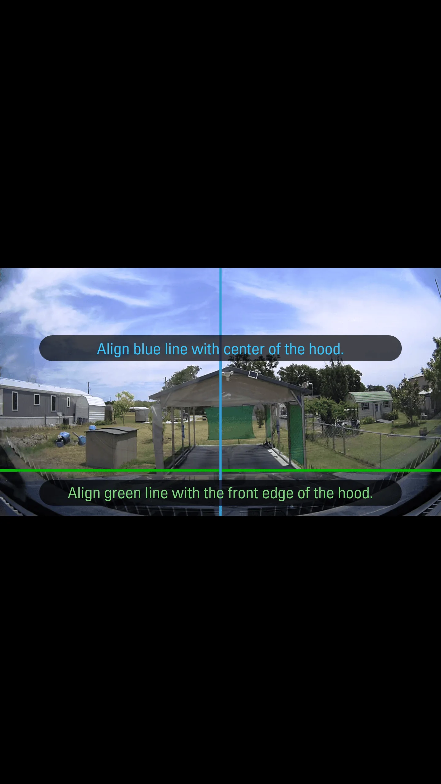

i put in the thinkware U1000 front and rear with the OBD cable for pwr and parking pwr.
its pretty darn good so far, took a bit to get it to talk to truck and smart phone. but once it un screwed the operators head it was easy
video is pretty darn good the video in the dudes comparison is pretty crappy compared to my u1000 actual video, its clear and crisp.
my you tube video is compressed and not good quality upload because i was not going to wait 2 hrs to upload 30 seconds of HD video
watch the deer run across the road in the link
