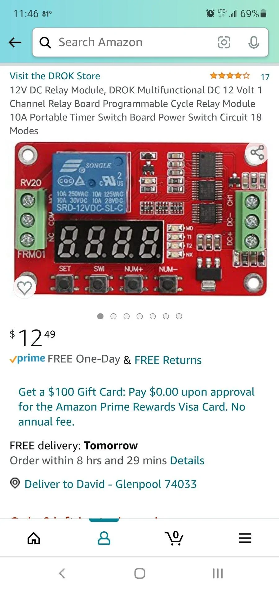

You've convinced me that it makes sense to have the camera shut off after a certain period of time has passed. I like the 2 hrs period as well. Did you have to drill any holes for your hard wiring? I'm trying to find a video of someone doing a hardwired dash cam on a 2021 and surprisingly I can't find anything.

I didn't drill holes. Just found an ignition circuit and a constant on circuit and used add a fuses. You'll also need a timer relay.

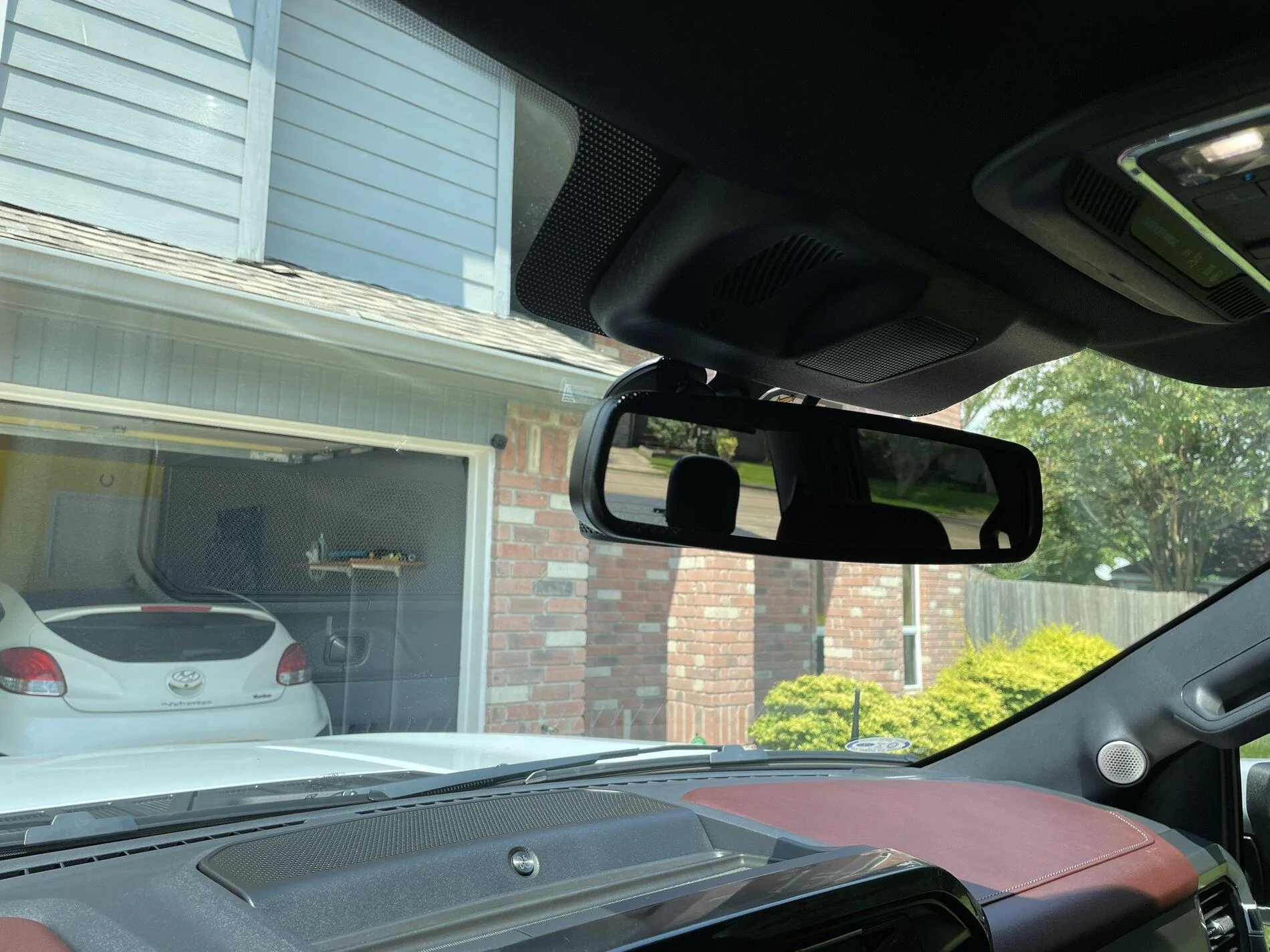

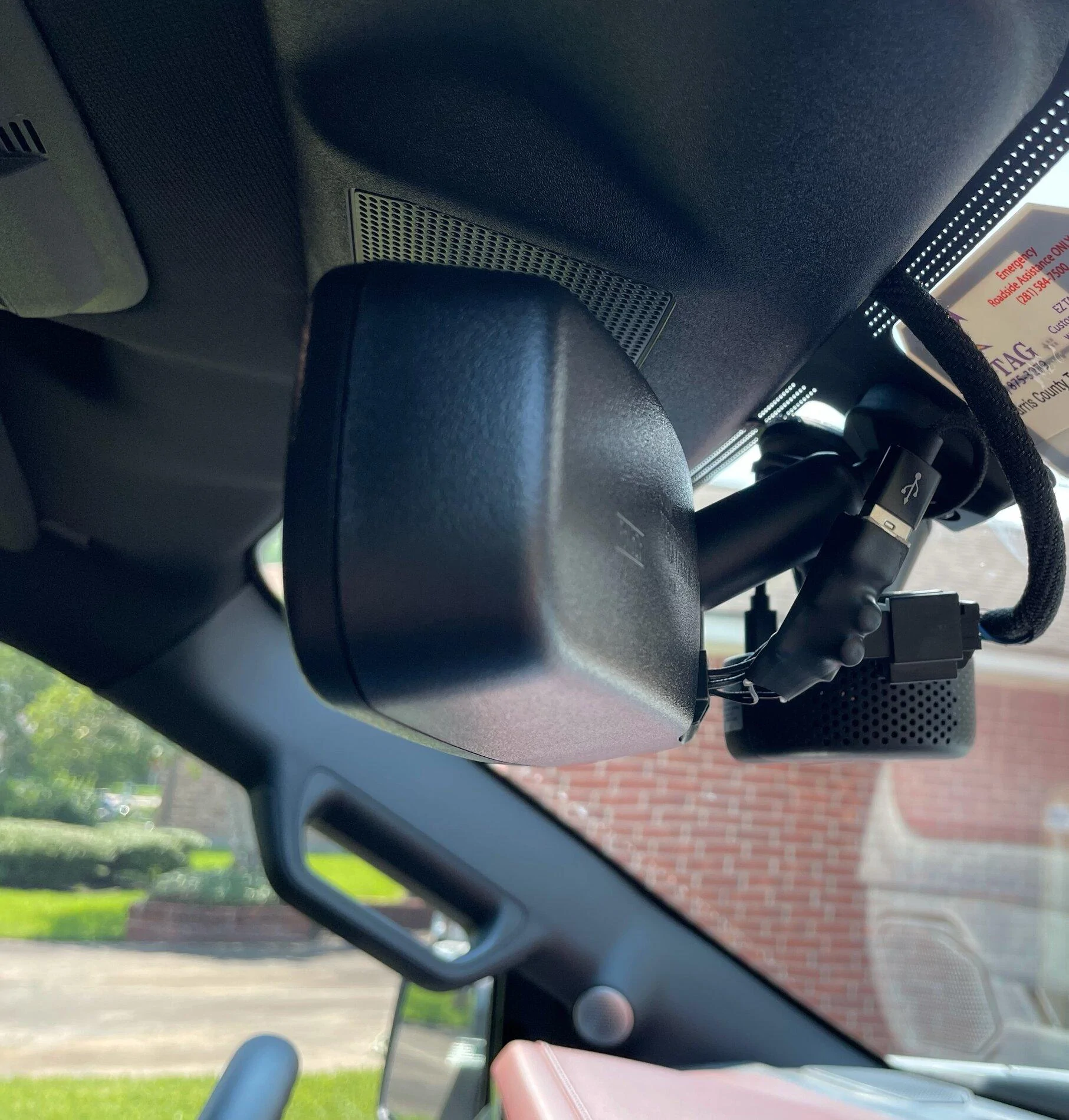

Installed, plug came with needed cord, so yay.
