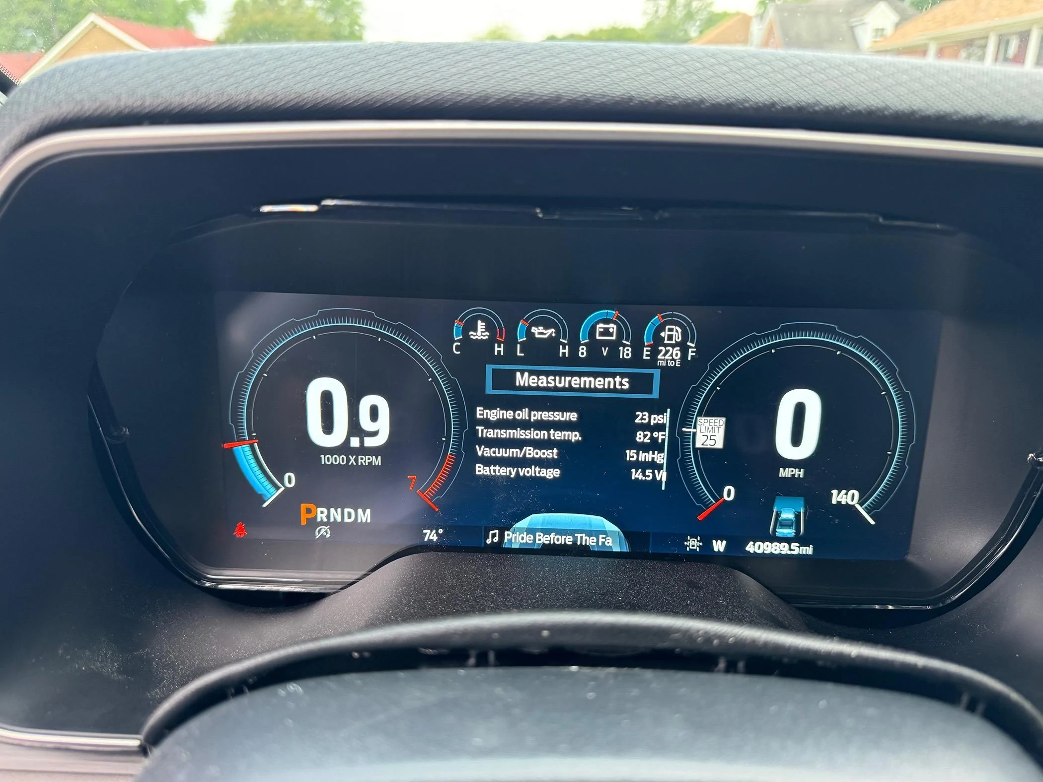

So I have my eyes on a few 12” digital clusters that I want to swap into my XLT, one of those being a raptor cluster. I know @Jesse-Infotainment said that it works in non raptor trucks, but I want to know if anyone has done it or knows if the cluster would function as if it was a non raptor cluster (meaning no exhaust modes, steering modes etc.) assuming I uploaded my XLT’s IPC as built?

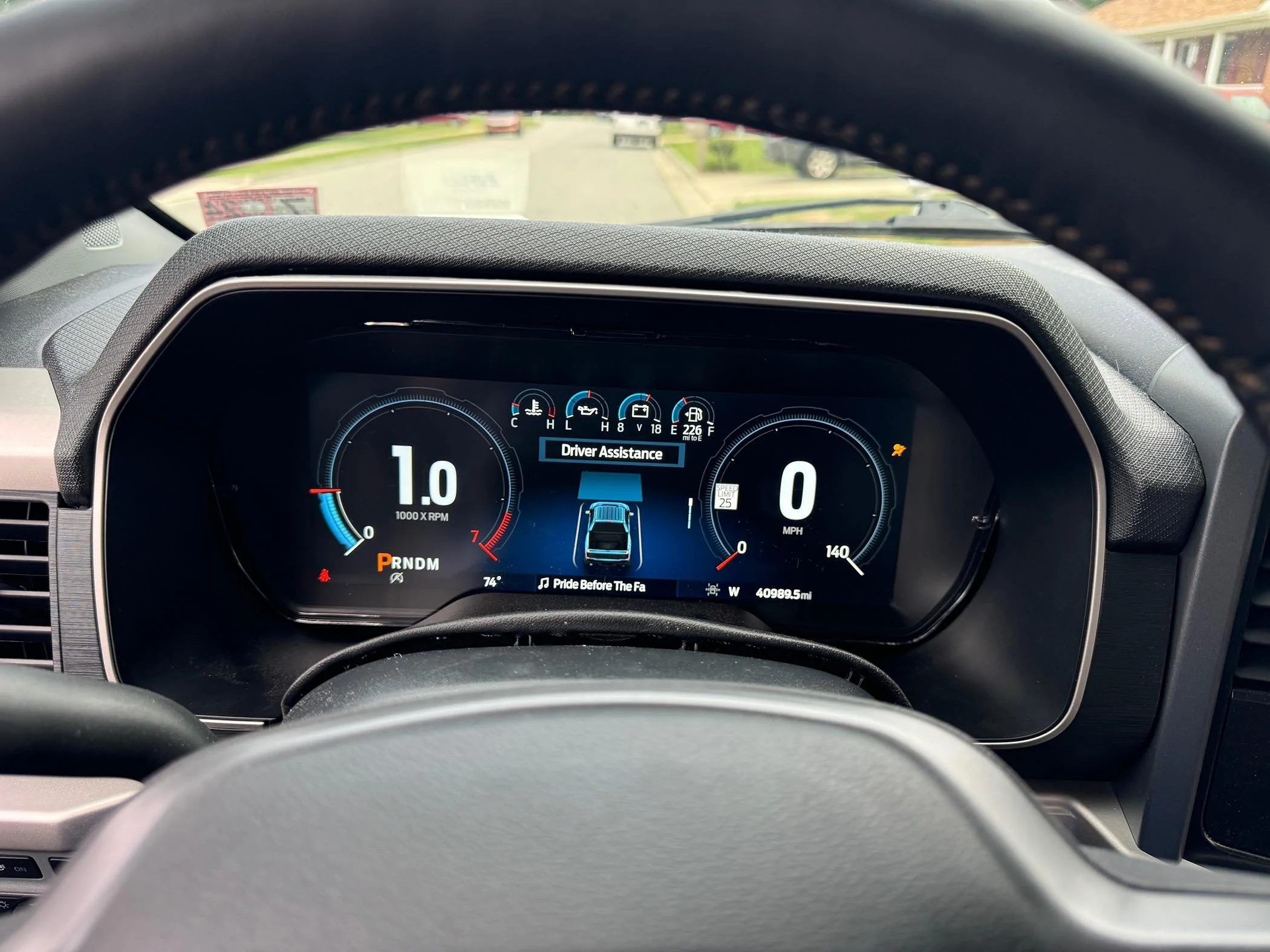

*update*
It can be done! I did the install on Wednesday and once I uploaded my AB, I programmed my engine and idle hours then my miles. Aside from a couple of things I need to re add in Forscan, it works flawlessly. You even get actual oil pressure and battery voltage, you get to keep the raptor info screen which has the my gauges and measurements as you’ll see in my pictures below

The pictures make it look like there should be a different bezel around the cluster.
That’s because I used the bezel from my 8” cluster I still need to get the 12” one

Do you get any measurements (besides voltage) that aren't available in the regular F150 cluster?
I haven’t played around with the other ones in Forscan yet (as far as turning them on to check) but I do know of you have an ecoboost, the boost gauge now reads vacuum as well
So after looking at it, I saw the battery voltage, vacuum / boost, actual oil pressure, transmission temperature, and oil temperature
