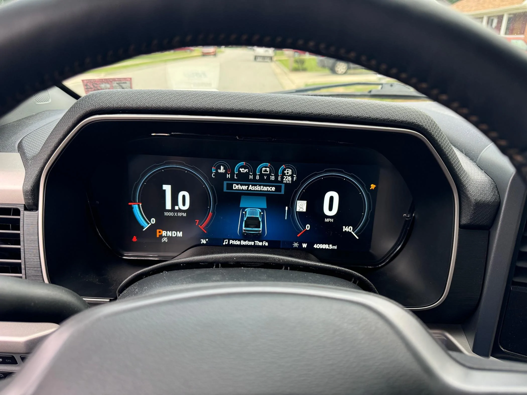

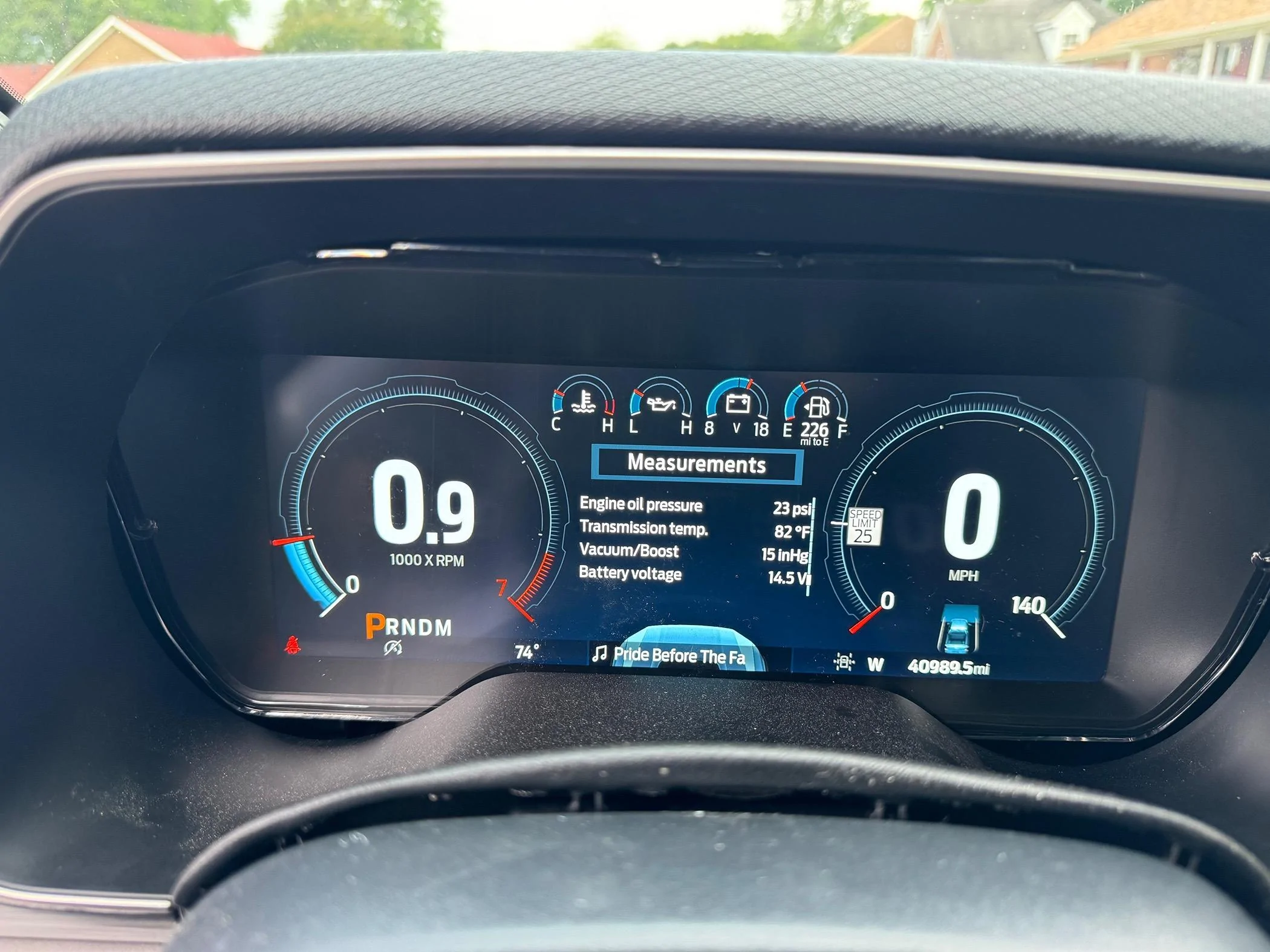

As everyone can see, I have successfully added the raptor cluster to my truck. Everything works as it should and you can even retain the my gauges and measurements screens. AND the oil pressure actually works instead of just sitting in the middle like on the 8” cluster and non tremor/raptor digital clusters
