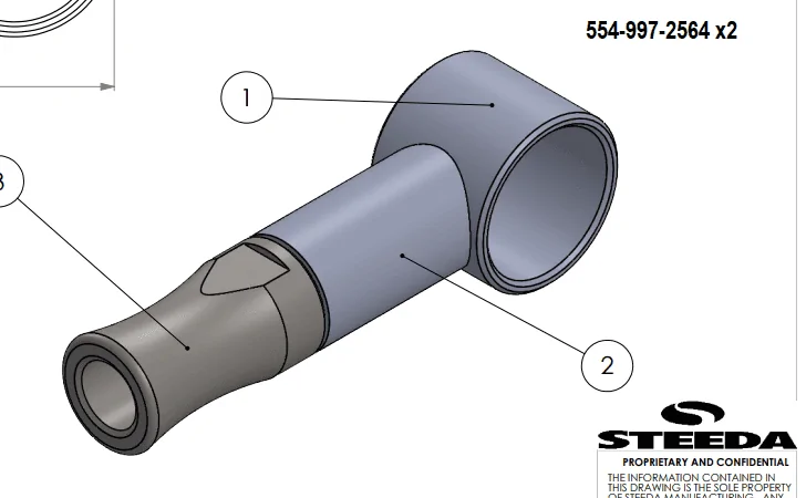

Took a flyer and bought the Steeda 2wd version after talking to Customer Service. I dropped the rear by taking out the rear axle block. Got it in and the bar leveled parallel with the ground with using only about 1” of the threaded rod meaning at least 1” of thread engagement on each side of the end links customer service said minimum 0.5”. I could have come close to parallel even with the block not removed.
With that said I cannot understand the rationale for the length of the end links on the 4wd. As if everyone with 4wd gets a lift. PSA Steeda, lengthen the threaded rod 0.5” and sell it as a 2wd & 4wd unlifted. Then you can market the other as 4wd as “for lifted”.
Just FYI per email exchange with Steeda ....
The only difference between the 4WD (PN 555-1027) and the 2WD (PN 555-1028) version of the rear adjustable bar kit is one end of the end link assembly. The "short-end" needed to convert a 4WD kit to 2WD kit is PN 554-997-2564 (x2 required, 1 for each side, sans bushings so transfer your existing bushings). I was quoted $150 for a pair if those ends sans bushings.
Ford F-150 Anti-Sway bars questions 2WD Short Link End
I don't think I could fab a set of fixed-length short links for $150 in materials and effort.
Nor do I know if the 'dangling bar' bugs me enough to make a change.
Making no comment on Steeda's pricing or kit bundling, it is what it is. Just providing info for those interested.

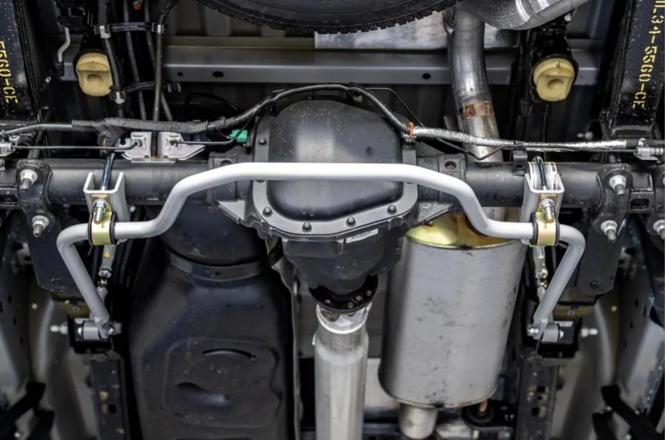

So I installed the steeda 2wd kit (per recommendations on here) on an FX4 w/ blocks still in place. My impressions;
I had to adjust the end links to what must be about max length to get the bar “level”. I can also only use the end setting in the bar tab. The distance between the end links was about 3.75”, not sure how much was left. Evidently the 4wd links are too long, and I felt the 2wd links were too short. Not ideal.
Torquing the end link bracket to the frame while keeping it parallel? Good luck. What a PITA. Maybe with a third hand… a big maybe.
I had to bend my muffler heat shield away from the end link on the passenger side. It was pressed right up against it. Not ideal.
There really is no flexibility on where you can install the u-bolts on the axel due to wires and brake lines. This prevented me from centering the bar in the rubber bushings. The images in the instructions also do not look like my 23’ PB. Not ideal.
Before you bother trying to bolt the bushing carrier in place, put the u-bolt in a vice and spread it - it was about 0.5” from actually fitting. Not ideal.
This one is a nit pick but light grey paint? Com’ on. How about black. This thing already looks so out of place.
Last, I greased everything properly with provided grease. Torqued everything to spec. Verified fit (no contact). And it creaks around turns. Not ideal.

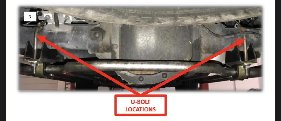

I will note for others performing this install….
The picture in the instructions show the u-bolt location in a different location than the marketing image;
Ford F-150 Anti-Sway bars questions 6DB7E7FE-9985-4FD4-B458-9338F9F8CD1B
Ford F-150 Anti-Sway bars questions BA2A7BDE-8A6D-42FD-AF30-46DC1A832ED2
Also, the images don’t depict the muffler heat shield. Maybe this was added for 2023? It is a hard interference tho.
Maybe I did something wrong, and I haven’t owned the truck long enough to discern a difference in driving attitude, but I’m not really happy. Didn’t seem worth the time and money.
Ford F-150 Anti-Sway bars questions 6db7e7fe-9985-4fd4-b458-9338f9f8cd1b-jpeg
Ford F-150 Anti-Sway bars questions ba2a7bde-8a6d-42fd-af30-46dc1a832ed2-jpeg
Again, very valuable information, and great pic!
I am particularly interested in your comments and picture regarding the placement of the U-bolts, as I anticipate this to be a very real point on contention with my install. I may have to rethink this...
