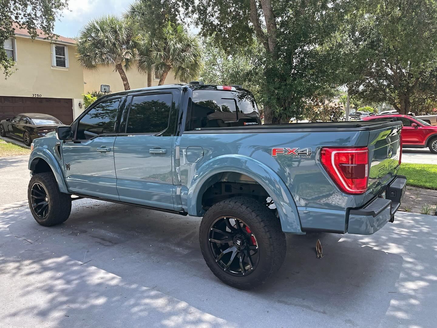

Still waiting for ladder type bars... I just need to be patient.
Nice ride btw! I emulated the rocky ridge build in almost every way; lift, wheel size/spacing, fox shocks, and RR grill ?. I kept stock wheels for now ?.

Nice setup! Can’t wait to see what rims and tire setup you go with? And I’m trying to have that same patience for the traction bars before I add my Ford Performance Whipple. My next mod will be Boost Auto Tow mirrors. I’ll be installing myself. ?

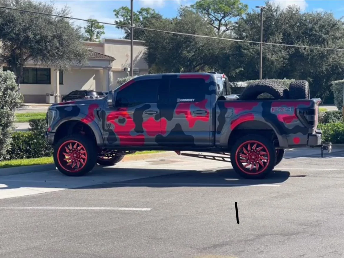

I just found this guy on Instagram that ran Kaotic Concepts Traction Bars on his 2021 Rocky Ridge! I myself have a 2023 Rocky Ridge and will be ordering mines very soon because I don’t think there’s a difference in the truck frame work from 2021 to 2023. I hope this helps you. Here’s the link to Kaotic Concepts. They have 2 designs and does not come powder coated. Comes only in raw metal look. Here’s 2 pictures of his truck.
https://kaoticconcepts.com/collections/f150

That's a wild truck! Thanks for the info! (y)
After doing more research and speaking with them over the phone. I’ve decided to go with Up Country Fab’s ladder style traction bars. They powder coat and Kaotic Concepts does not. When I called around to different companies who powder coat in my area, it came out cheaper to just let Up Country Fab do it. So I will be color matching my traction bars with my truck. They have plenty of options. I’ll be ordering mines within the next month.
https://tractionbars.com/products/ford-f150-ucf-bolt-on-fabricated-traction-bar-kit-1
