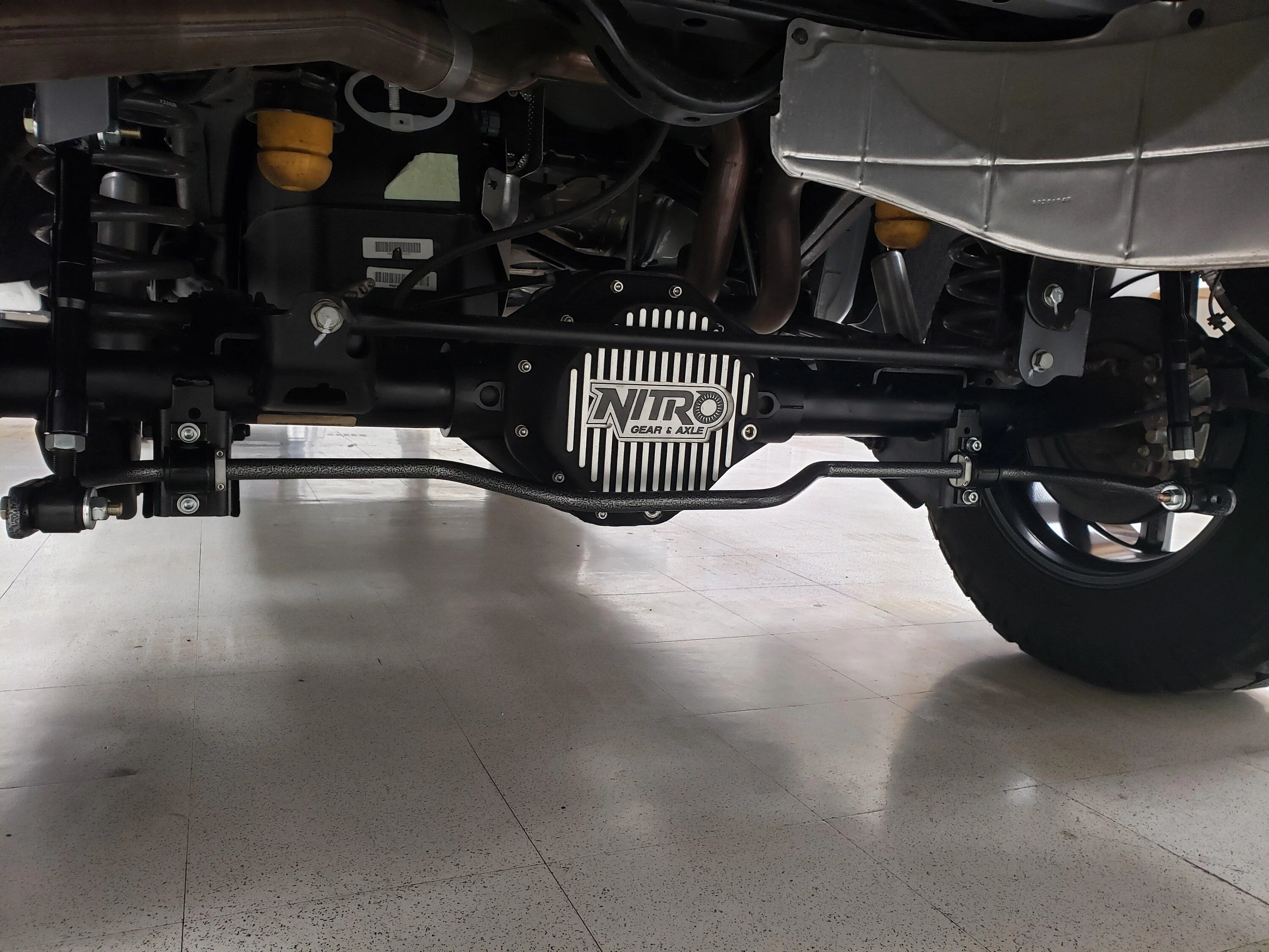

These are my rear links for my Belltech rear sway bar.I used the Belltech links that came with the kit and just modified them to fit my application perfectly.Here are some pictures that may help any one else who is thinking of going this route.
