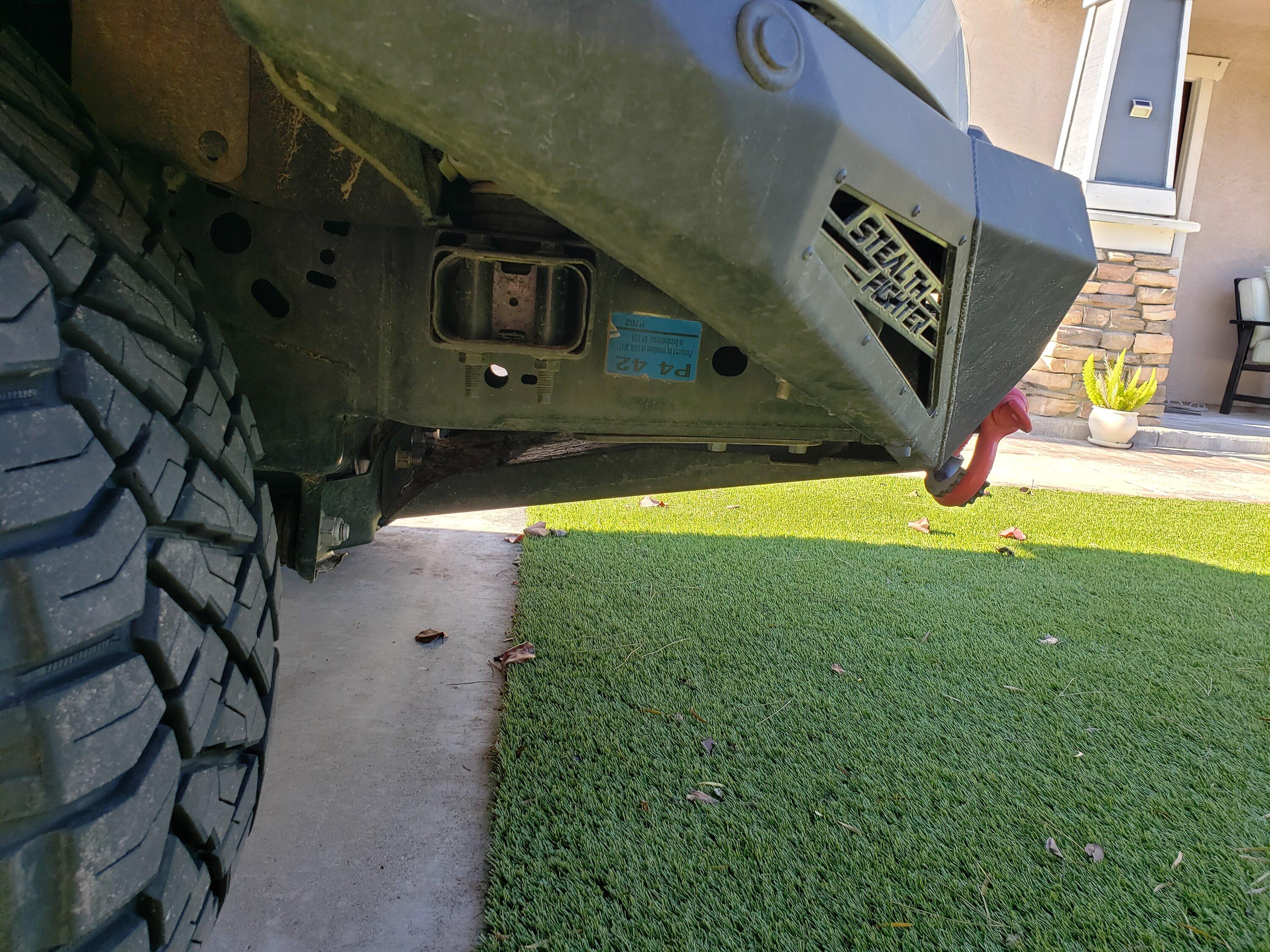

Ford F-150 Anyone remove crash bars? 20230127_104256
Ford F-150 Anyone remove crash bars? 20230127_145448
