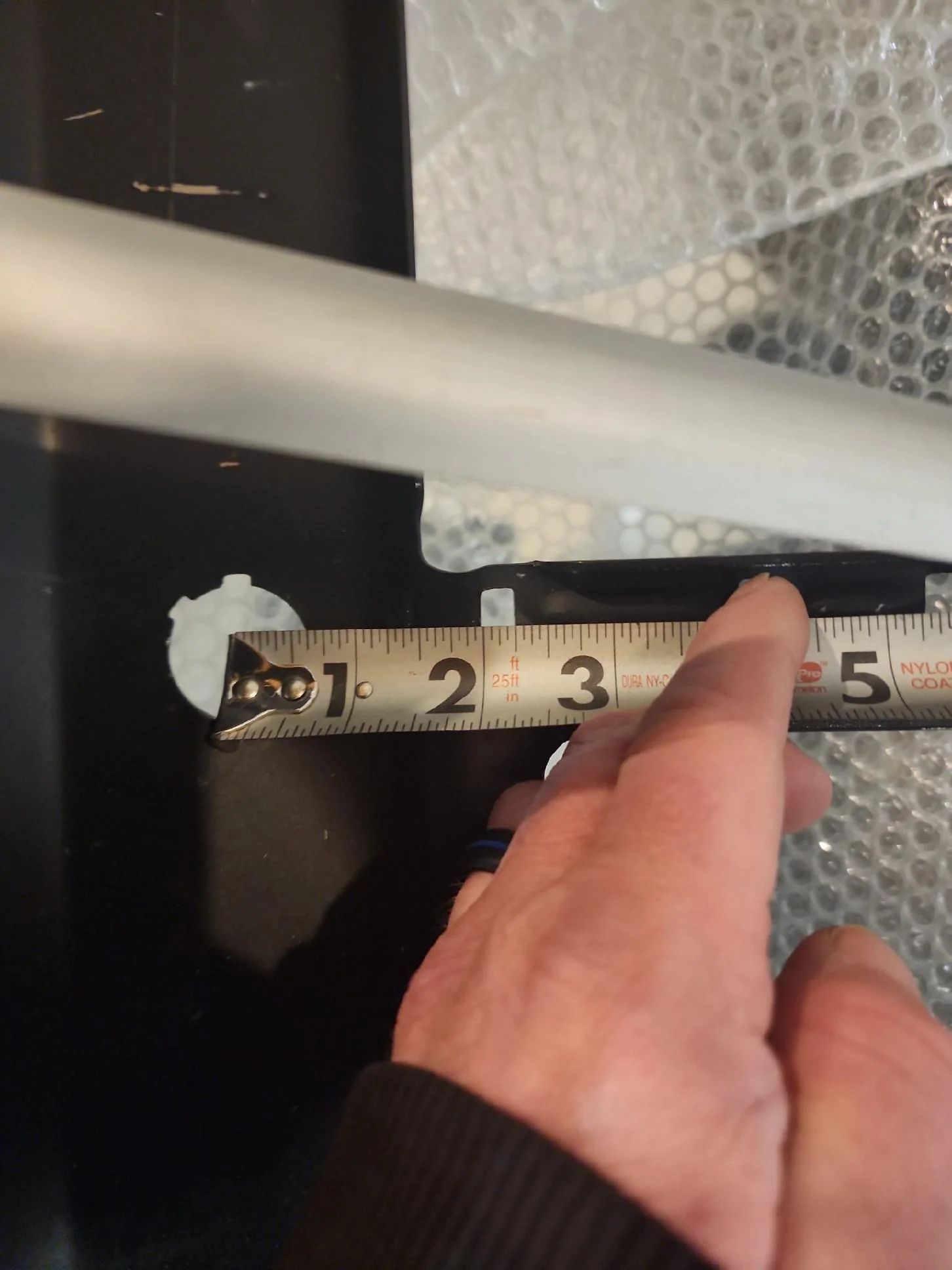

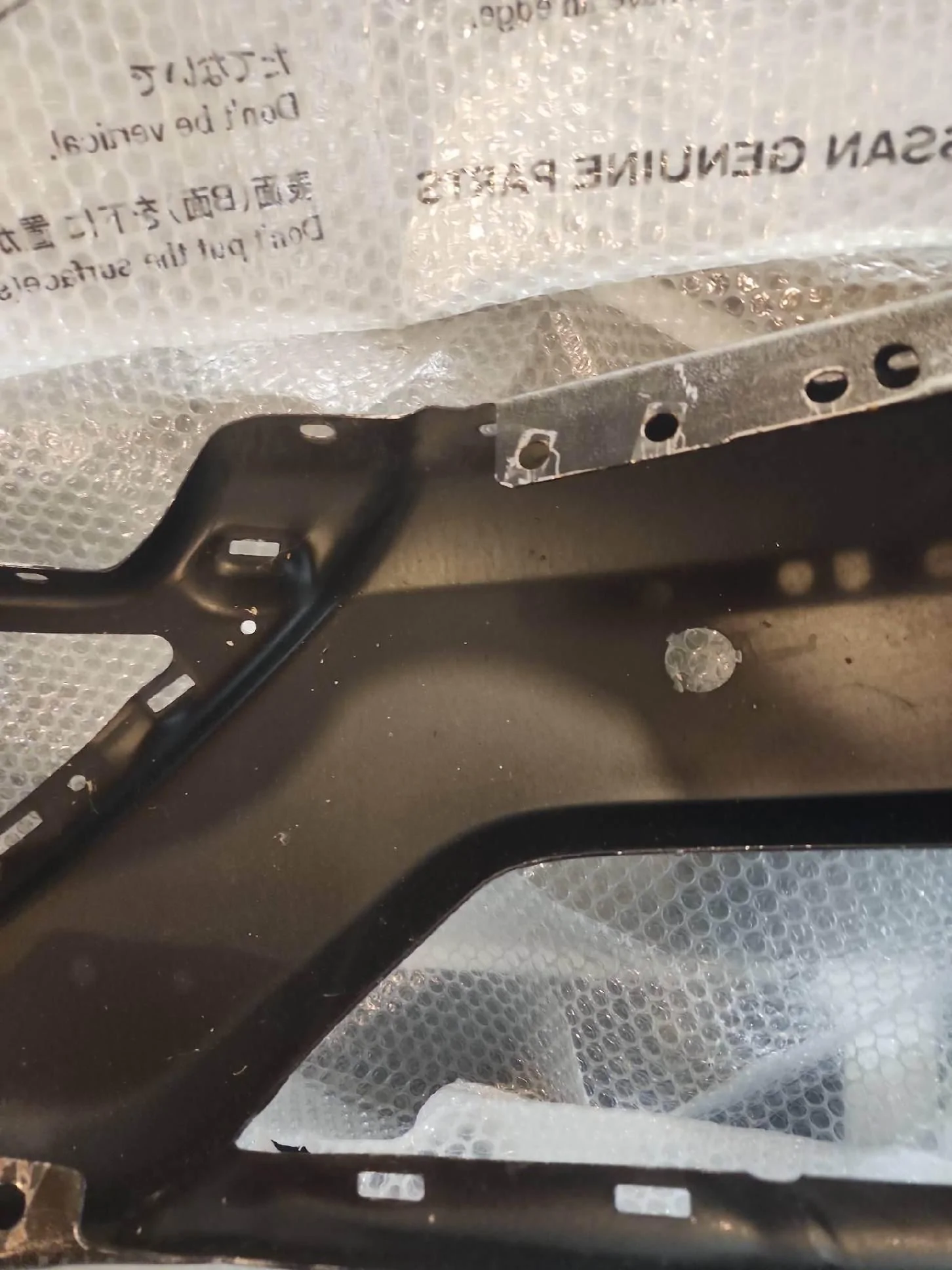

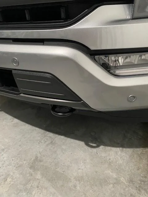

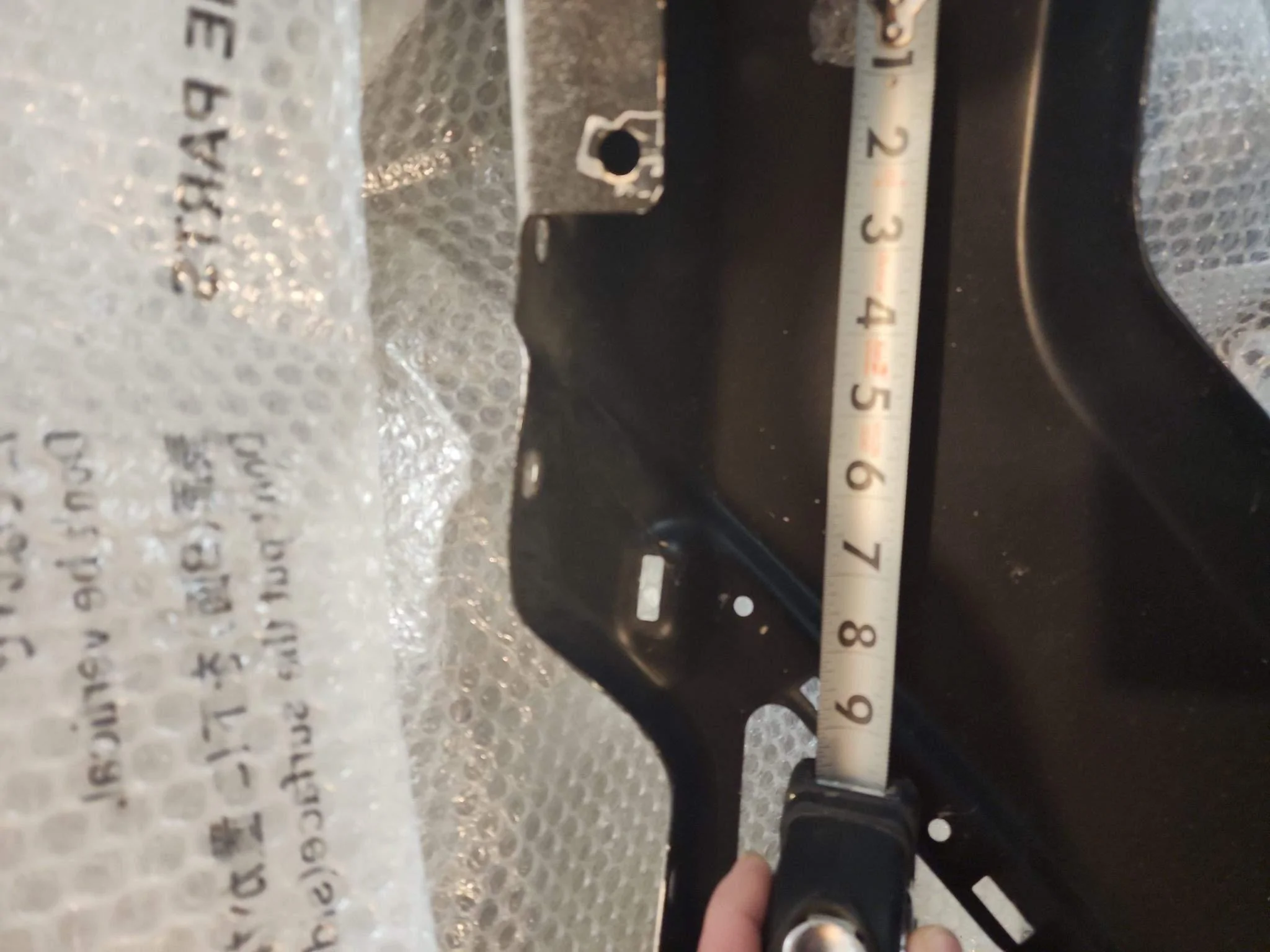

What did you use as a guide to drill your bumper? Or did you purchase a bumper with holes?

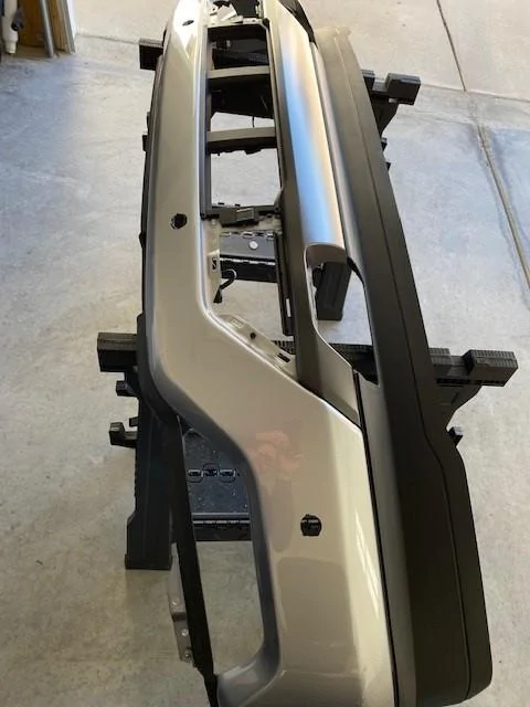

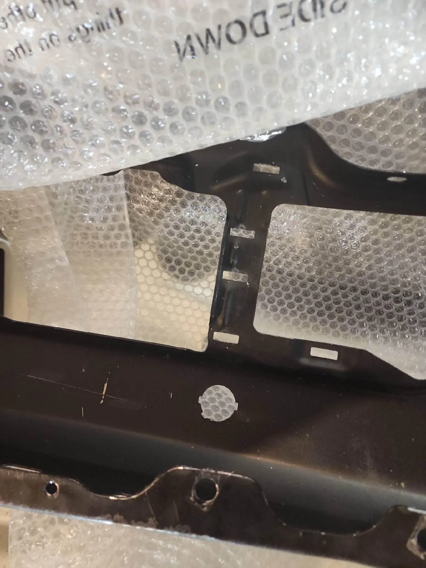

I like that you can’t tell I drilled my own holes. Haha
@Puffy929 was kind enough to send me these.

which got me close side to side and a perfect reference for the up and down.
I had the new harness in and clipped where it was gonna live and those pigtails are only so long so that helped with locating as well. I used a 1/2” conduit hole saw then a uni bit until they were the right diameter. The OP said he shaved the plastic on the retainer but I used a dremel and actually made all the notches referencing ebay bumper pictures to get the orientation correct. Once the hole is the right size, you can set the retainer in there and mark the notches if that’s the route you wanna go.
Awesome, thank you for this. I also plan to dremel for the alignment tabs so that they are "clocked" correctly. We shall see how that goes. I painted them last weekend, so hopefully I can get them installed this weekend.

i can’t take all the credit, the measurements came from a bumper with factory sensor holes that @Puffy929 sent me which is also why the holes look perfect. Mine look like a crackhead chewed through the bumper. Haha

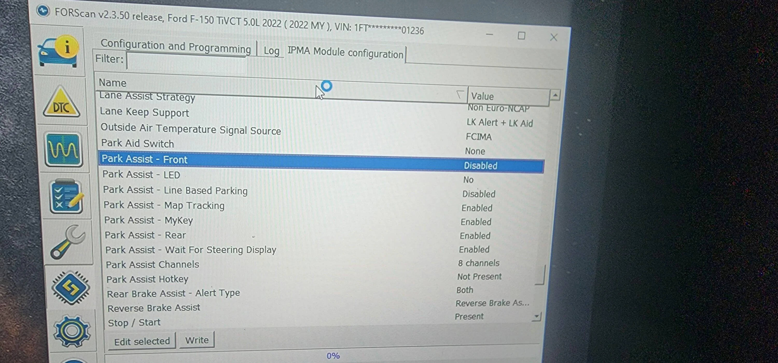

Here is what I changed on top of what has already been shared.

That’s the line I was missing. I had the code for 8 sensors but that “front” was disabled. Working now, thanks!
Any time. Glad I could be of assistance.
