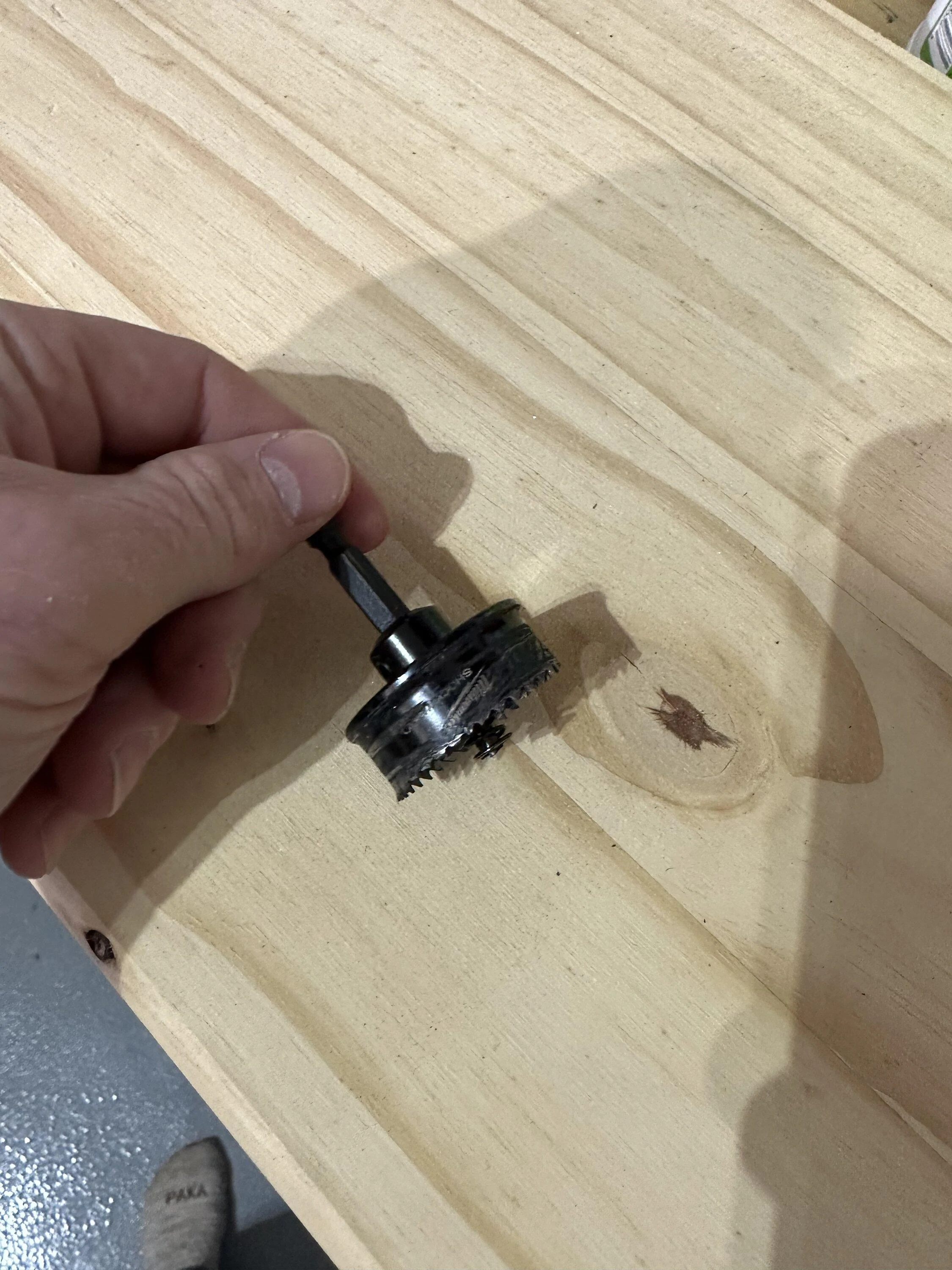

@Omodan (or anyone) - can then recommend a particular drill bit? I tried a Milwaukee bi-metal and it was walking a lot making the hole what looks like was going to be too big.
I used a 1/4" drill bit as a starter hole, then switched to a step bit. I believe it was the 1" size that worked for me.
Thanks. .... you know what brand? I was going to order the Nieko one on amazon (amazon says I already bought it in 2019 but I have no idea where it is. I was just worried that the milwaukee metal compatible whole saw bit didnt drill for nothing. Dont want to get caught 3 steps into the step bit cause then I cant go back :)
I went all out and bought the Harbor Freight “Hercules” bits. I know, big spender but it did the trick.
Awsome... I was just super nervious as my larger 1-1/4 metal hole saw plus some walking and it was getting really close to being too big. It also jerked a bit when pilot broke through and somehow put a little mark maybe 1/16 long outside of what should be covered by the retainer. Still not sure how it happened. I took it easy tonight and decide to 'just' pin some connectors for the 5 and the 6th front sensor.
I did cach my f'up on video - spent like 20 minutes measuring making sure I had the exact spot and then whipped out the drill like it was the first time I used it before. I really should have grabbed a helper to hold the bumper instead wasnt really thinking about it bidning and wavying the drill all over the place. Plus should have added some cutting oil and maybe swapped to another drill that has a second handle and goes slower. Will post it later.
I used a Milwaukee hole punch set (4 bits) that had a center tap that held the bit in place. It worked real well for me. The set ranged in sizes from 3/4“ to 1&1/2”. Think it cost me about $35. The center hole punch really helped as it would otherwise have shifted a lot while trying to punch the larger hole.
The center punch on the bit, pictured below, sheered off on a separate job I did. it had no issues on my bumper though.
