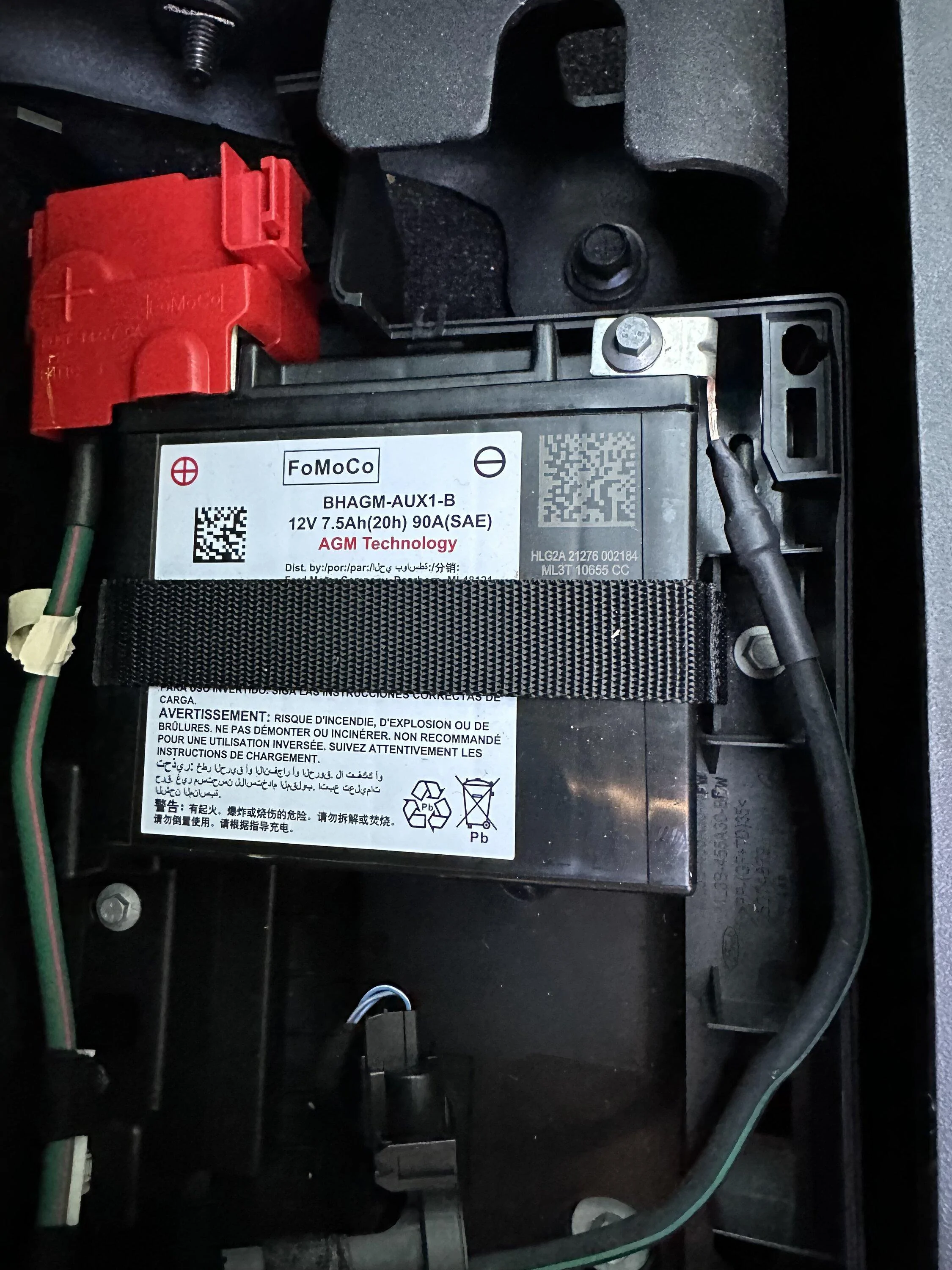

Well... Is your purpose to run 12VDC things engine and generator off? If so you might consider two things. 1st is a battery disconnect that separates the engine off stuff from the rest of the truck 12VDC system when the engine is shut down (& I don't mean a low volts disconnect). GM made one of these for their trucks like the Suburban (I had this on mine). Second, given what you speak of for usage you should put in a deep cycle battery. I had one of these as a second battery on my Suburban and ran separate wiring for the things I ran engine off, like a cooler. While they make deep cycle AGM batteries, what you will really need is a regular flooded cell deep cycle battery since it'll have greater capacity. Having a low volts disconnect on the deep cycle battery, in addition to the engine off disconnect, is a good idea. If you really deep cycle that battery you can reverse a cell and when that happens the battery is gone.
Diligenthunter
Taylor
May 7, 2022
248
116
Delaware
2022 F150
Definitely recommend just upgrading the battery under the rear passenger seat, the non power boost have two battery’s here so there’s plenty of room for a bigger one.
I was wondering if adding a second OEM battery into the tray and in parallel to the first would provide additional Ah to mitigate the issues of not being able to start and/or run 12VDC electronics/ports longer. Any thoughts?
You’d be able to double your AH. I was leaning towards replacing mine with a larger one at some point.
Battery dimensions I took when I had the cover off.
Dimensions are if the battery was standing up not laying on it’s side.
H
4.75 could go 1.5 inch taller before hitting the noise suppression thing.

This battery, that's not currently available, will fit in the box if you cut up its internals. I have this battery for testing
https://www.amazon.com/gp/product/B0C3CZQCKP/ref=ppx_yo_dt_b_asin_title_o05_s00?ie=UTF8&psc=1
Here's the BMS's logic in operation. This was back in april or may. Key on, key fob in-vehicle, hvac blower setting 5, this is what the truck's BMS does (above batt connected, keep in mind below 13.4v it's consuming the LFP for all vehicle loads ~50a)...
Mods to box to fit batt
Ford F-150 Adding a second battery to a 2021 F150 Hybrid 1698794387442
Ford F-150 Adding a second battery to a 2021 F150 Hybrid 1698794408246
Ford F-150 Adding a second battery to a 2021 F150 Hybrid 1698794428655
Ford F-150 Adding a second battery to a 2021 F150 Hybrid 1698794448078
lid
Ford F-150 Adding a second battery to a 2021 F150 Hybrid 1698794493330
Results, fits with lid closed
Ford F-150 Adding a second battery to a 2021 F150 Hybrid 1698794602142
Even this 'tiny' LFP is comperable to a 60ah lead acid battery in terms of usable energy it can deliver. This like installing an 8x larger aux batt vs the 7ah AGM.
