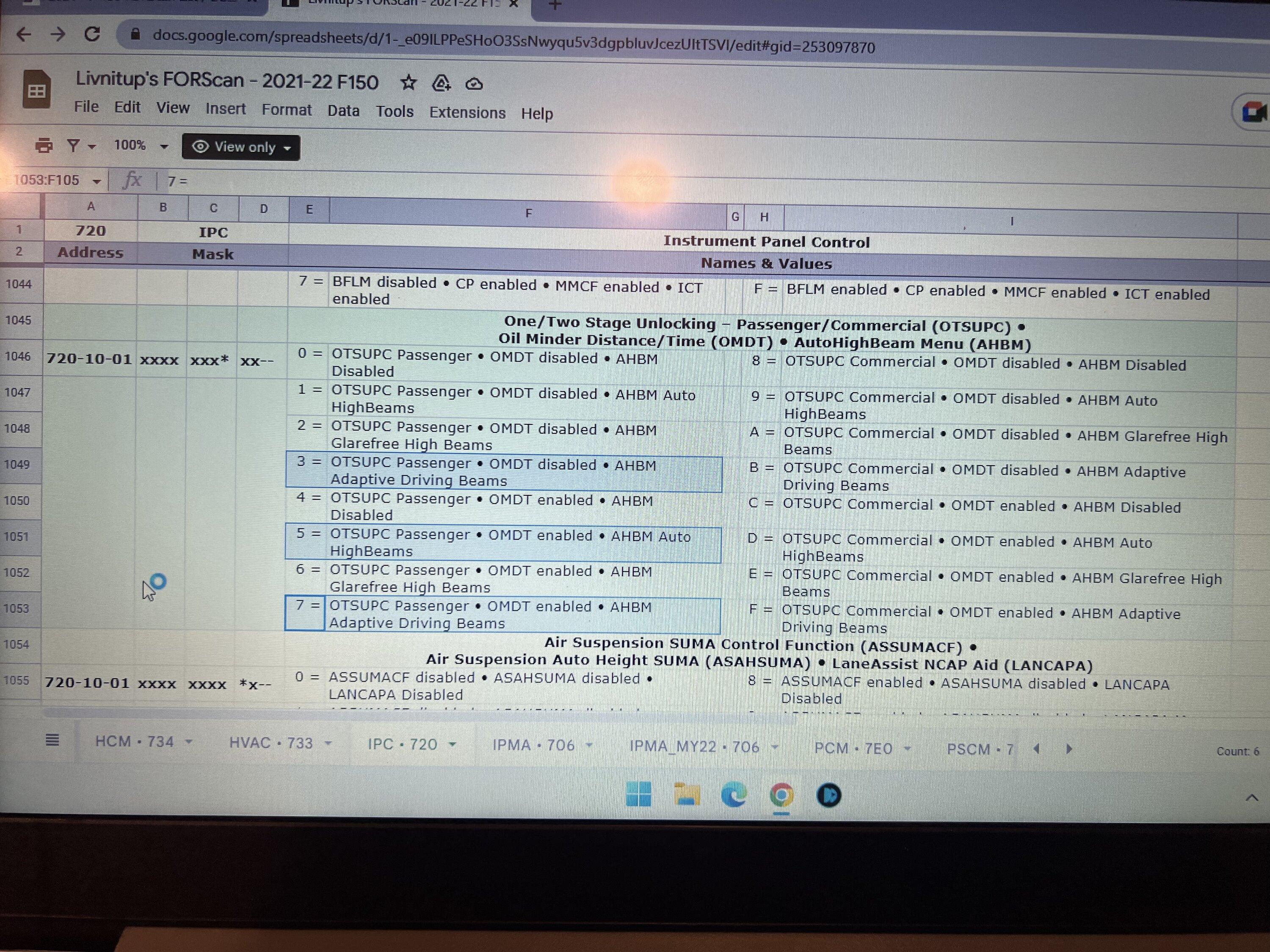

I changed everything as show on page 1 and there are problems. A couple of the changes give me checksum errors when I write the HCM and SCCM MODULES. I am able to get the glare free option in Sync and the green headlight icon but the SCCM is throwing codes. If I revert everything back to the original as builds the codes go away
My truck is a diesel if that might change any options. The IPC setting shown on 724-10-01 of xxxx xxx3 turns off the oil minder that is currently active on my truck with 0B18 0065 00C0. Should mine be xxxx xxx7? I included all my as-built entry's with the change circled.
For your first post: Are you referring to the forscan pop up for check sum error that says write yes or no?
Second question: yes 7 appears to be the correct value based on your OEM as-built.
I will take a look at your as-built once I get back to my computer.

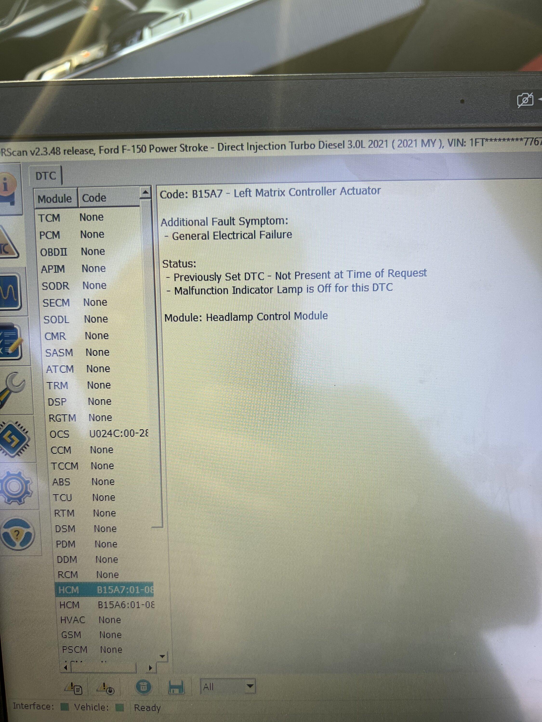

Plugged in Forscan to make sure everything was ok after the ota updates and found new DTC codes. Anyone know what this truck is unhappy about? Everything seems to be working fine other than these codes.
Most likely it’s a spurious DTC as a result of the modules resetting after the OTA. I would clear it and see if it comes back before doing anything else. It’s not uncommon to find random DTCs on these trucks when you run a scan, particularly after updates (manual or OTA).
Sounds good. I had a random seat module DTC also that I cleared. I will check again next weekend. Love the glare free headlights and don't want to go back to the old ways due to problems. I wonder what Ford would do if you wanted a problem fixed with the glare free in Texas.
