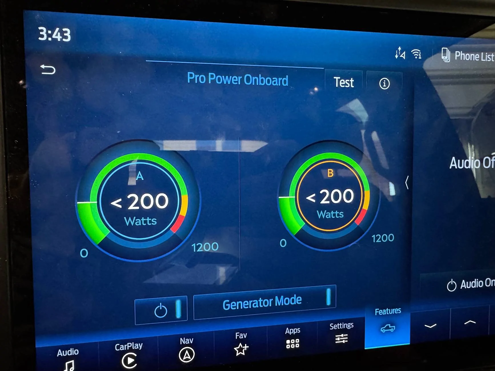

The 24's "bars" are in there too now, but the dials look better IMO
This is an example, don't use the value/s
Here's if you play with bars, not worth it IMO, there's another setting that deals with variables in the bars
Is there another setting to show the full 3600?
Ford F-150 7.2kw Inverter images IMG_1285
There's another value for the PCM that might have an impact (I update my posts to avoid long threads so go back a page). I have lots of changes in my APIM so comparing asbuilts in my truck may or may not be useful. You might try making the PCM change and disconnecting your 12v batts for a full truck reboot. Someone else only needed to change the PTTB value, but subsequent updates may have added values somewhere else.

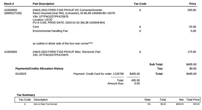

Take a look at car-part.com, Ford Truck-F150, Power Inverter (Hybrid), frame mounted (rear RH),(converter), ID ML38-14G649-BH.
I see a few on there sub $400. I also asked the yard that had mine if it still had the power outlet box in the rear, so he pulled that as well.

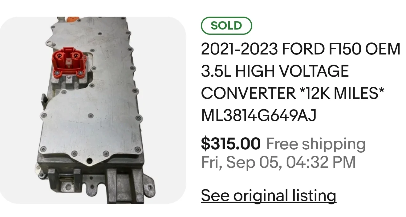

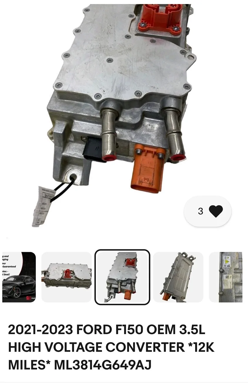

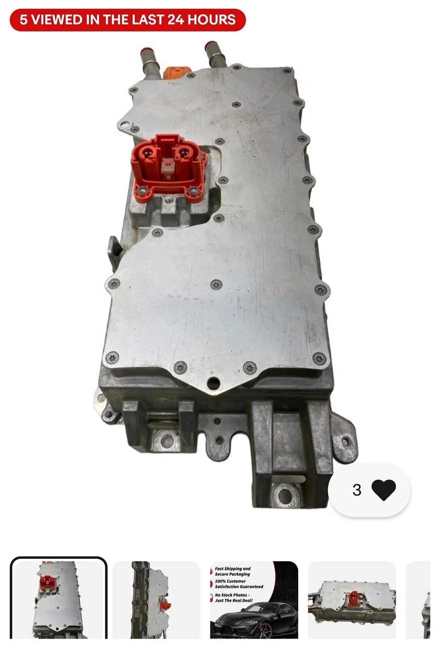

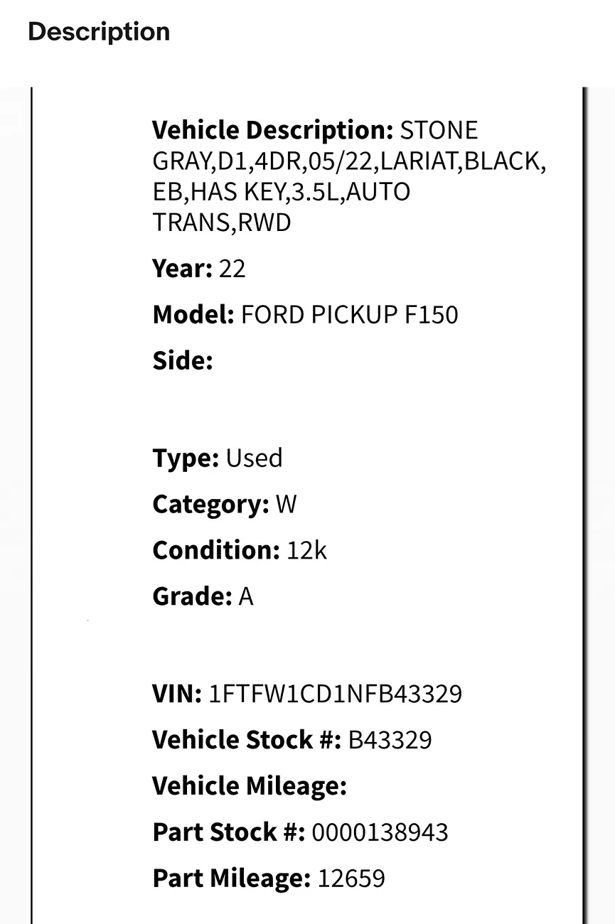

So I got caught up In some promotion coupon crap and panic bout this one. I got it for on sale for what I thought was a fair price of 275.00.
now I see I could have done better..but hey whater.
Anyone know if this is the 7.2 inverter I Intended to get for replacing the one in my 2025 lariet?
