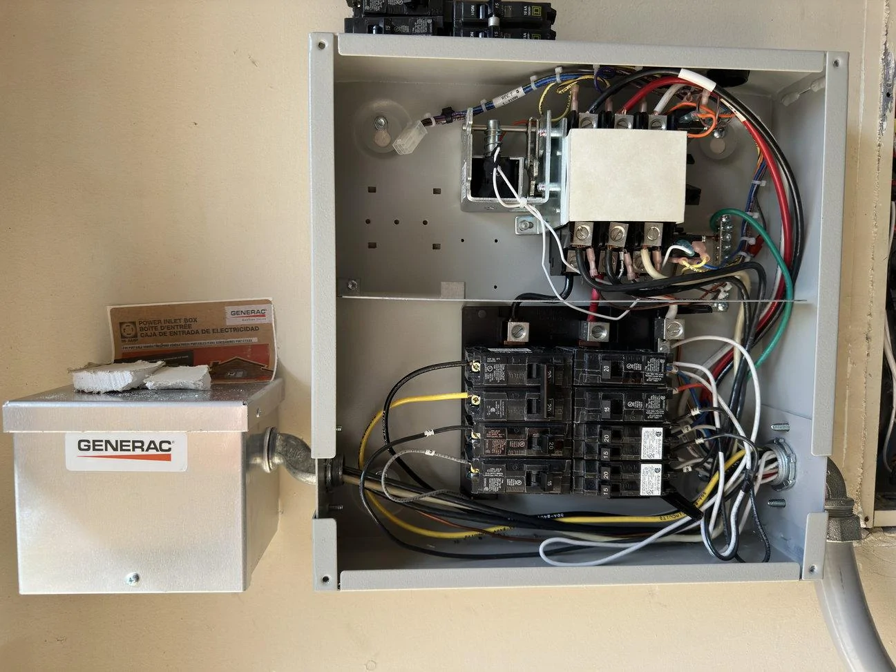

I know that there are some threads about this. I am just posting this to show my experience and what I did.
Here are the parts needed:
Generac 6854: https://a.co/d/i7HMHUV
GearIT 30-amp generator extension cord: https://a.co/d/4PGNGsO
I did hire electrician to do the install.
EDIT: if you live on Houston or surrounding area and want installer, then PM me. I have no association with installer nor get any commission at all. This is just me passing along info.

Thanks to Beryl, I was able to use generator of PB and get actual usage stats:
At 11:30 am, when my car started generator, miles to empty was 466.
At 5:30 pm, miles to empty was 437.
In 6 hours of continuous use, 29 miles was used up with generator use.
Average use is 4.83 miles per hour.
On a full tank, I get around 600-635 miles of range.
Take the low number of 600 miles range.
600 / 4.83 = 124.22.
124.22 / 24 hrs in a day = 5.17 days.
So my truck can power my house for 5 days.
And the best part was that I can drive to gas station that has power and tank it back up! (EV would be an expensive paperweight!)

I did find the limit of the 7.2 generator.
I had the lights on in the house, fans running via active outlets, 2 Jackery units charging, 2 fridges (main big kitchen fridge + smaller fridge + freezer), and 1 central AC for master bedroom. The generator would shut down when everything was ON. Main culprit(s): the Jackery Explorer Pro 2000 drinks A LOT of juice when charging it (1560 watts continuous!)…….which my truck can do easily…..but then when the two fridges would turn on AND then the AC kicked on….overloaded my poor truck generator!
So, when charging the Jackery Pro 2000, i had to shut off the AC unit……and my truck did it with ease (along with powering everything else above). Once i finish charging the Jackery 2000, then i can run AC again. My smaller Jackery units (1000 & 1500) had no impact at all when charging them…so i could run AC and charge these smaller Jackery units. But boy, that big Jackery Pro 2000 is a juice hog!
