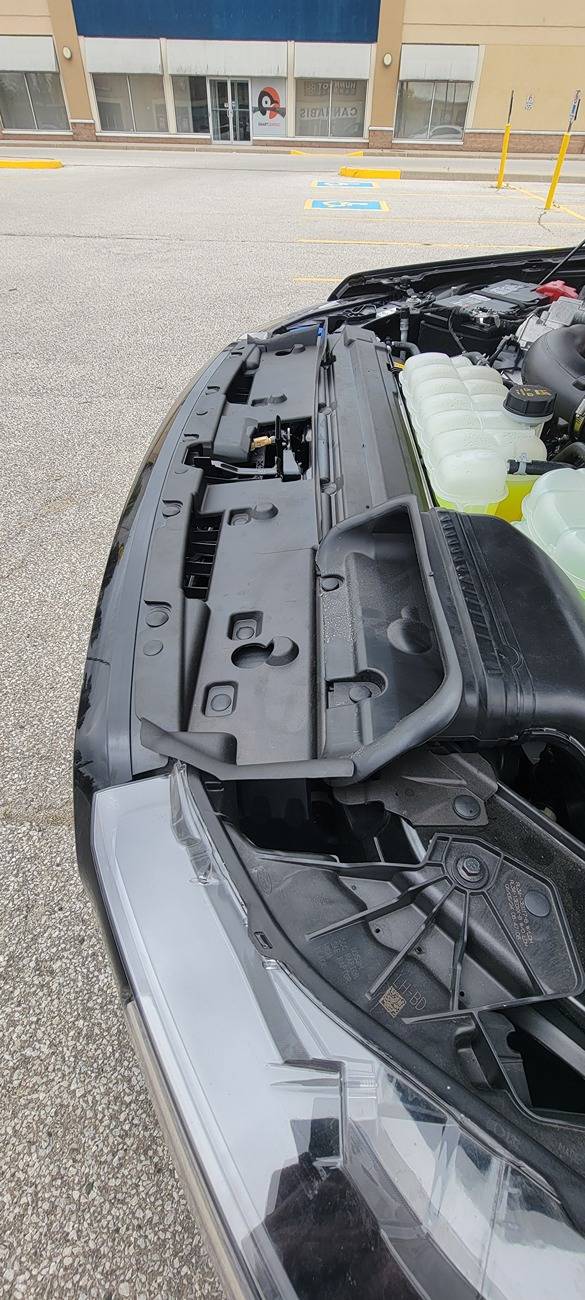

Sept 28: Got back into town, returned the loaner, and picked up the truck. Since it was Saturday, the service department was closed, but they had arranged for reception to handle the keys and paperwork.
My copy of the work order is 7 pages long, and I might post it later. Their version had a surprising amount of heft to it. Took the truck for a drive, and it felt good—no rattles, and it drove as I’d expect.
I took it out on the highway, but noticed that lane centering and BlueCruise aren’t working.
I also popped the hood to check everything and saw that the non-TSB radiator shroud is installed. I really don’t want to go through this whole process again, especially since I’m working and staying in a remote area. A breakdown there would be incredibly inconvenient, beyond anything I can put into words.
Before I head back out of town on Monday, I’ll talk with the dealer about the lane centering and see if I can just modify the shroud for now while they order the correct one.

Ooof -- cut it to avoid it again. They have to replace it so buy some airflow now.
FaaWrenchBndr
Greg
Jun 23, 2024
2,552
2,555
Denver, IN
‘24 XLT Powerboost
Cut the damn thing…….cut it NOW
Hard to believe with all this crap about the turbos, they didn’t replace the deflector with the new one. Your dealer is overwhelmed with incompetence
