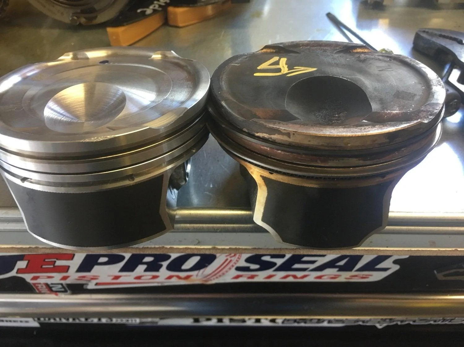

Running e85 with an aggressive tune puts the 3.5s right around 700hp. Ballsy, especially with that many miles on it. Already seen a 21 blown up with an "aggressive" e50 tune (~665hp). Not enough fuel to do it stock which would be my bet as to why it blew up. Guy was sour about it and didn't want to give more details.
The stock powerboost is already exceeding the trans rated capabilities. The mustang forums are the best place to learn about the 10r80s weak points for those interested.

Running E85 is considered to be very safe by a lot of people, but it's easy to get carried away on a forced induction setup when you have a fuel like E85 that will tolerate a lot of spark advance and boost. Not enough people consider just how substantially they are increasing cylinder pressures when they start adding timing. Our engines also run fairly tight piston ring gaps that can become problematic when you significantly increase power output and try to do long WOT pulls on the highway.
I'm trying to stay fairly conservative in my efforts to tune my truck. If the calculated torque values from the PCM are reasonably accurate, which they should be for a basically stock engine, it's very easy to hit 500HP and 600 lb-ft at the crank. I'm not sure if I want to go much further than 600 lb-ft, but I might play with slowly increasing boost pressure past the torque peak in an effort to flatten my torque curve and increase HP, but I'm already at a fairly steady 19-20psi.

Rods often get blamed when the cast piston is what let go first. 3.5 Ecoboost factory pistons aren't anything to write home about. If you are unfortunate enough to get a flawed skirt .....
Are the pistons hypereurectic? I doubt they are using cast.

3.5 Ecoboost Gen2 and Gen2 HO (Raptor)
Non Raptor is a slightly higher compression piston.
I love the Ecoboost. But Ford cheaps out big time on the pistons. They probably acquire these for no more than a few dollars their cost.
