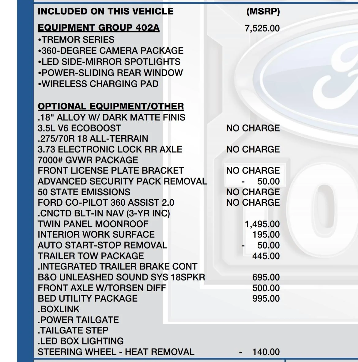

Went to install the sensor as I fully expected it to be a dummy box since my window sticker says advanced security removal and my as built files show this sensor not enabled, and low and behold I have what appears to be a legit box. Not sure why it would be installed but not activated, so I will try the Forscan changes to see what happens, and might have a module for sale.
Ford F-150 2021 F150 Advanced Security Pack IMG_4056
Ford F-150 2021 F150 Advanced Security Pack IMG_4057
B-real
Nov 14, 2022
376
292
Utah
2023 F150 Tremor 3.5
So turns out I got a $50 credit simply for Ford not enabling the intrusion sensor. Made the Forscan changes and everything works. Looks like I have a sensor available if someone is interested.
