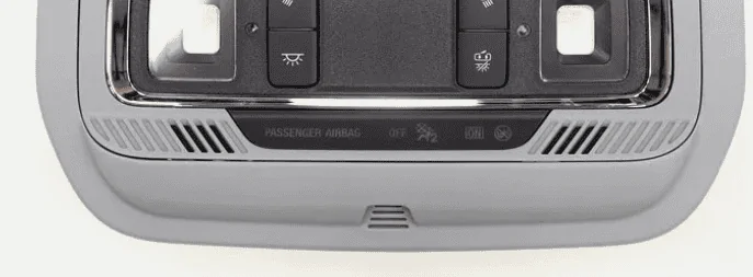

My 2023 Lariat Crew had the advance security pack removed when built. I’m wanting to add it back. I’ve seen where others have simply ordered the sensor and enabled in Forscan. However, I have not seen any pictures or posts from anyone who was adding it back who also has the sunroof. I can order the sensor, but where the heck does the sensor “eyes” go? Since the overhead console is different with the moonroof, I don’t see any premade holes or punchouts where to put them. Anyone know where they are supposed to go?

YOu can add it. Its a module in the overhead console. I added it to my trucks

You got a picture of this or can tell me where the eyes of the sensors go? I don’t see anywhere where they can go in the overhead console.
There are three holes in the front of the overhead console. You also need to make sure you have the slits in the overhead console
Thank you so much! This is exactly what I was looking for. I thought those slits were for a speaker or microphone.
I have plastic trim tools. Where or how do I pull the console down to install the sensor?
