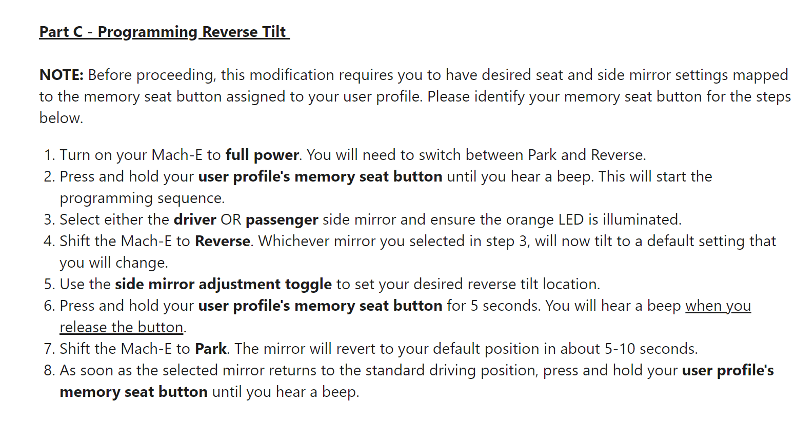

I activated the reverse tilting mirrors on bcm last night. Now under setting - vehicle - mirrors, the option is there.
The instructions say put the vehicle in reverse, and then select from the mirror adjustment panel which side mirror you want to tilt.
I tried it today and when I select the drivers side mirror, it just keeps going down and it doesn't stop. When you deactivate it, it goes back to its original position.
Passenger does the same but when you deactivate it, it starts moving outwards and keeps going till you push the opposite direction button.
Is this a fixable bug or simply can't get reverse tilting mirrors on a 75k $ truck?
??‍♂(lol ford)
This is a known issue with this mod. All of us have tried different ways to correct it. Now there is a method I havent tried and that is a programming method the Mach E guys have for it. Credit to
I just ran out at tried this on my '22. Unfortunately it did not work. Step 6 does not result in a beep. I tried 1 second up to 10 seconds. I tried bypassing step 6 and step 7 doesnt happen at all. If I press the mirror selector the mirror will go back. Then I tried step 8 and still no beep.
Tried it on my 21 lariat and unfortunately it doesn't work. Guess the door modules are not optimized for this function. Bummer
this seems......way to easy
can it be this easy? i may have to try
right now i use seat position #3 as my trailer tow backing up setting which drops the mirrors to a lower tilt, bu ti have to switch back to #1 when i drive fwd
