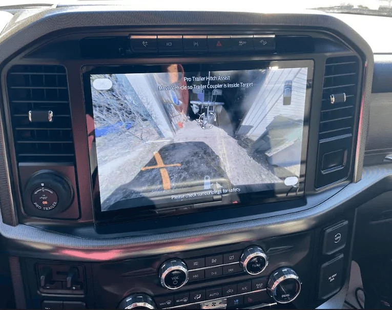

If you changed anything (lift, level, lower, heavy load in bed, wheels/tires) I'd think that the camera/IPMA calibration might need to be revisited also.
No lift, level, lower, heavy load in bed, wheels/tires. All stock running gear. Went to magnum trailers (much closer than the boat) and tried hitch assist on 2 different trailers. 4 total attempts. Each time the truck ended up a couple of inches left of the trailer. Close but no cigar.
I am wondering if some calibration is also required? I know that when the screen switches to brackets.. the hitch IS NOT in the center of the bracket. Or maybe hitch assist is marketing baloney and it doesn't work in general! Since nobody has posted on this working and I know we have 2022 and 2023s running around. And oddly, not even a search Youtube or Ford web finds anything.. the closest thing is dynamic hitch assist which is really the rear camera helping you see how to turn the wheel.
https://www.ford.com/support/how-tos/ford-technology/driver-assist-features/dynamic-hitch-assist/
Thinking about it.. I am going to get within 5 feet and then try again.. maybe the camera isn't seeing the hitch clearly at a distance. But I suspect some sort of alignment or calibration issue.

Ok.
Bingo. Trailer hitch assist works on my 2021 Job 1 Platinum.
I had some DTCs. Odd in that I did a read and a clear before I shut down when I made the original changes. But I didn't do the APIM reset. After the clear and reset and another read for new DTCs ... all good.
WARNING: Be ready to intervene and hit the brake. More testing (3X) at Magnum (lighting, shadows, contrast all about as good as it gets) resulted in the truck backing up way to fast in addition to being misaligned somewhat. If I had not hit the brakes the trailer would have smashed into the bumper.
So even though the prompts work and the truck attempts to connect I would say NOT WORKING properly is more accurate.

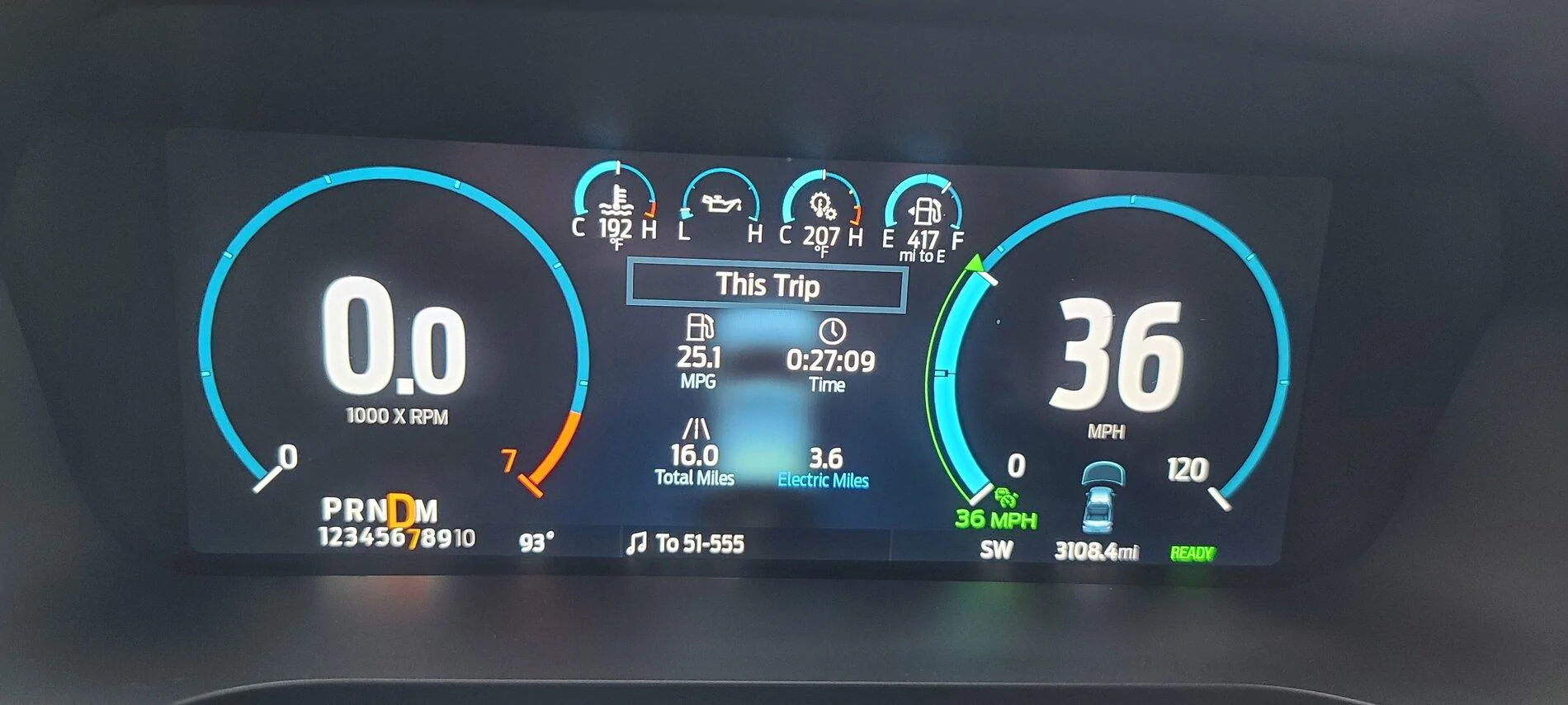

Like you, I wanted SO Badly to disable that double honk. Especially at night at home.
But just as much I want to know my REAL engine coolant and transmission temps
I'm one happy camper now! Thanks so much to you guys who figure this stuff out and generously share. I mean that!
