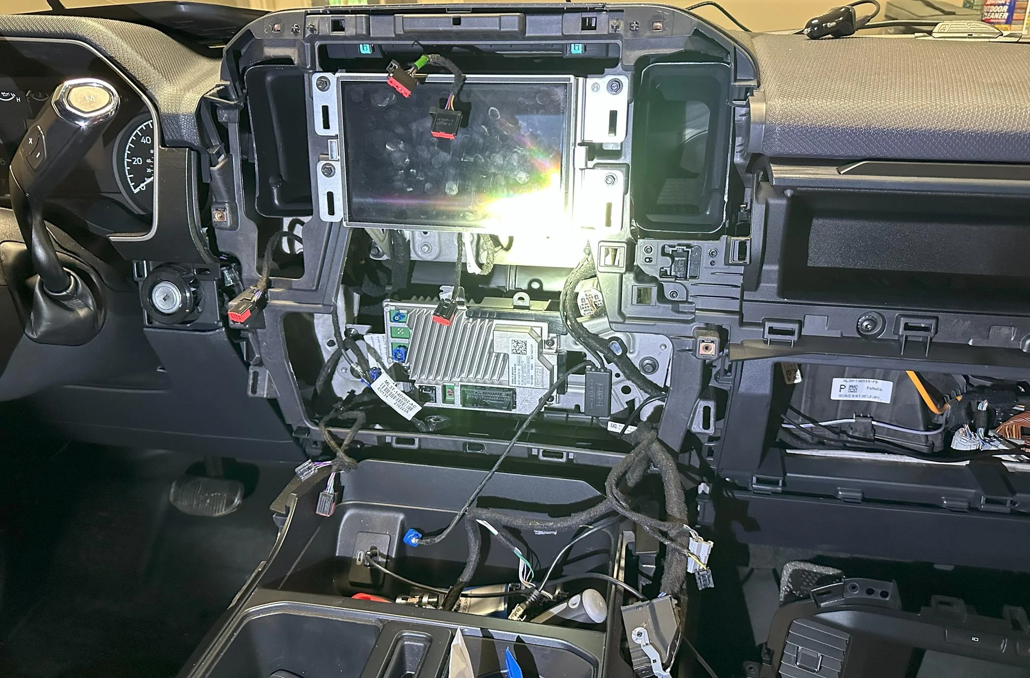

  1. Cable WPT-982 see photo 1. Pin 1 will run to fuse box in passenger kick panel. Pin 4 will run to existing ground location behind the screen upon removal. Before starting you will need to add on about 6ft of wire to pin 1 and 2-3 feet on pin 4.

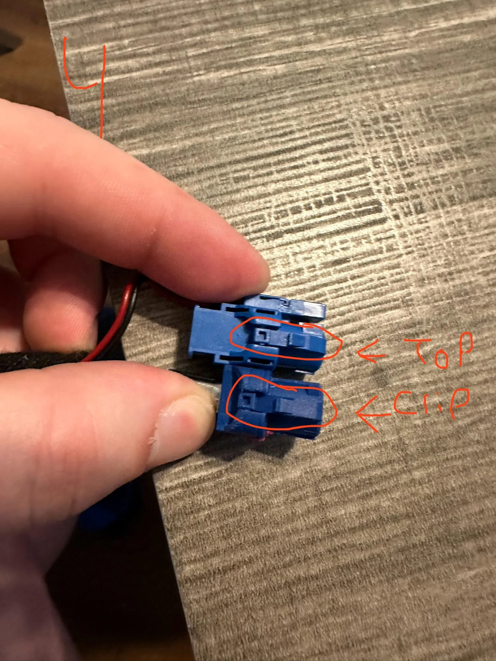

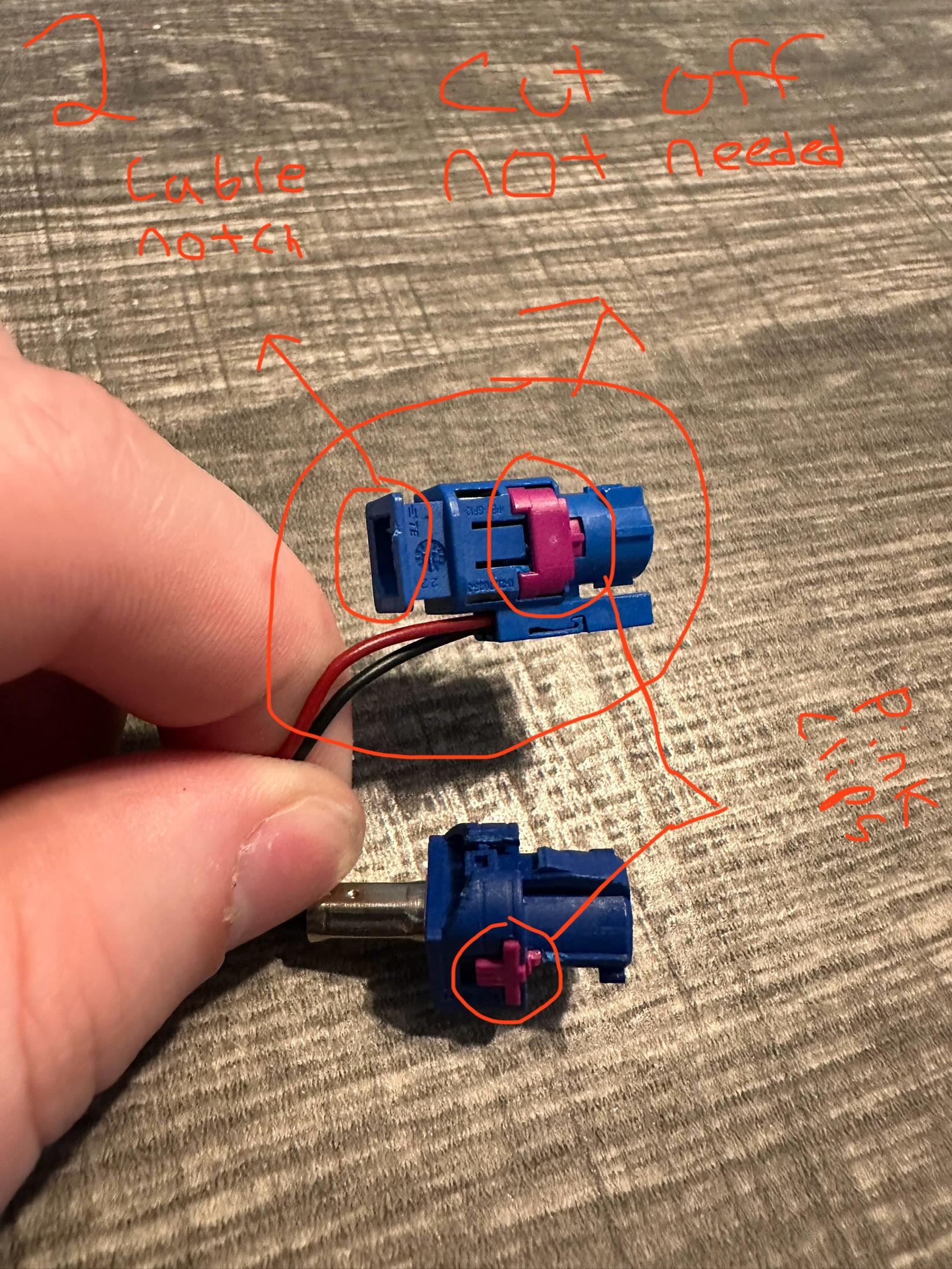

  2. Cable ML3Z14D202B (New display cable) see photos 2-4. On the new display cable I removed the pink tab and lifted the tab holding it in place, used the corner of a table while holding the tab to slide it off. It is important to remember the rotation of the pins in relation to the clip. If they don’t plug in exactly right on the APIM the screen will not work. Cut the fabric cable wrap back a good 8 inches or so to splice on the wires that are needed, cut the red and black cables to free the blue connector piece, this blue connector will not be reused but do not throw away just yet it may be needed if you forget the orientation of the pins. Add about 6ft of wire to the red wire for passenger kick panel and 2-3ft on the black wire to run to existing ground behind the screen along with cable in step 1.

  1. Once you have the old 8” screen removed, remove glovebox by pressing in side tabs. Route the new wires that were added for the kick panel fuse box from the screen location through the glove box down into the panel.
  2. Photos 2-4. Remove the display cable from the display and APIM then remove the pink tab on the existing radio connector like done above. Remember the rotation of the pins in relation to the clip.
  3. Ground both new ground wires that were added on the ground directly behind where the screen sat. I loosened the bolt a little and wrapped the cable around the screw and tightened it back.
  4. Insert the old display blue connector that was removed in step 2 onto the new cable make sure you put it on the right way. If you forget the exact way the female connector needs to be inserted, insert the blue connector to its original cable. The original cable can only go one direction due to its design and same for the new cable with the notch that is cut out in the metal ring. The old blue connector isn’t a perfect fit for the new cable but it will give it some protection.

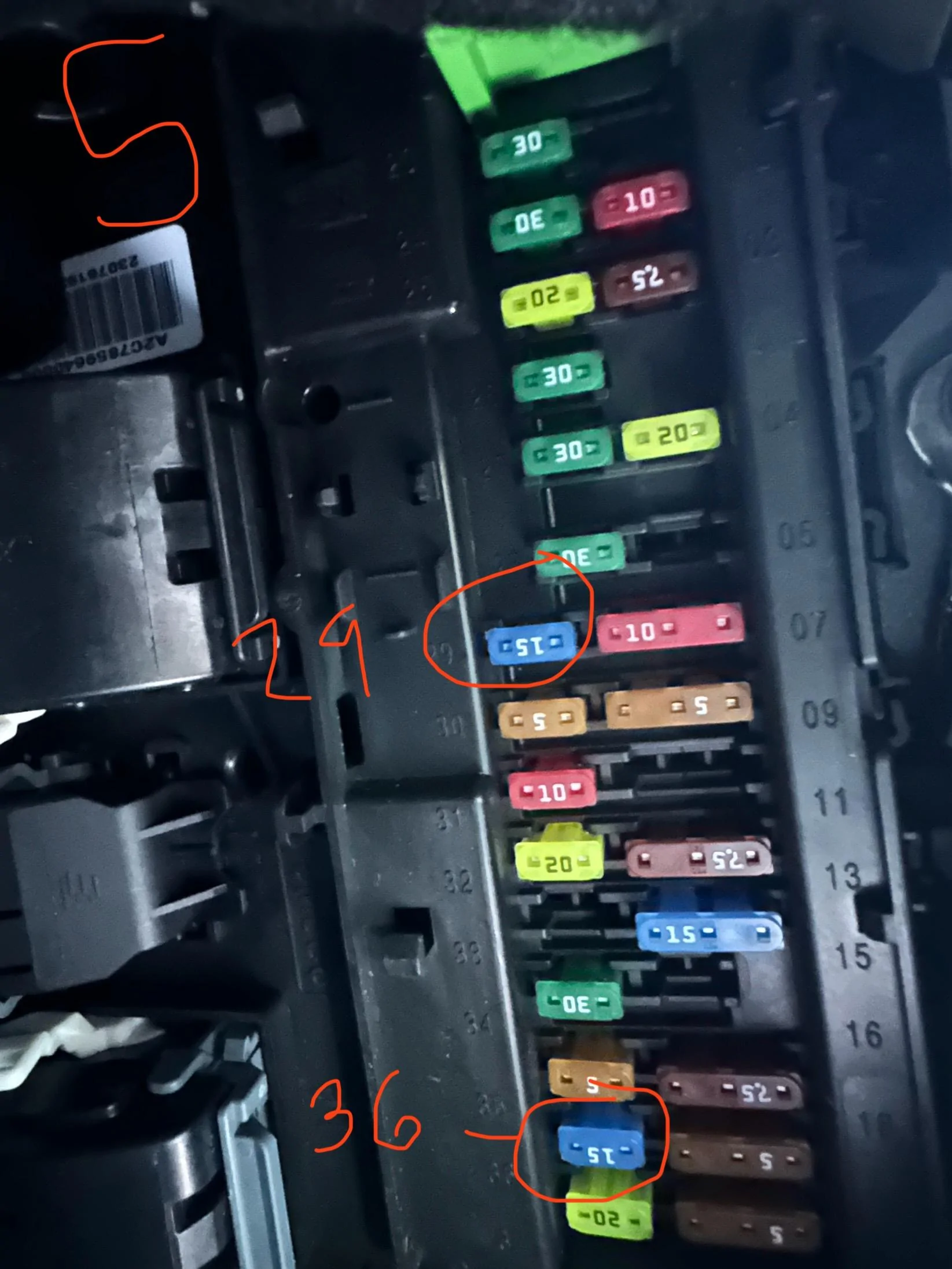

  5. Photo 5. Fuse tap, one will go in 29 other will go in 36, both should have an existing 15A. Existing fuse will go into the slot close to the fuse box for both, then add the 20A fuse in the remaining spot. Plug in the fuse tap, don’t crimp just yet insert both cables that were routed earlier, then plug in the new display cable to the APIM and to the display. Then turn truck ignition on but don’t start the engine this is to see if screen turns on.
