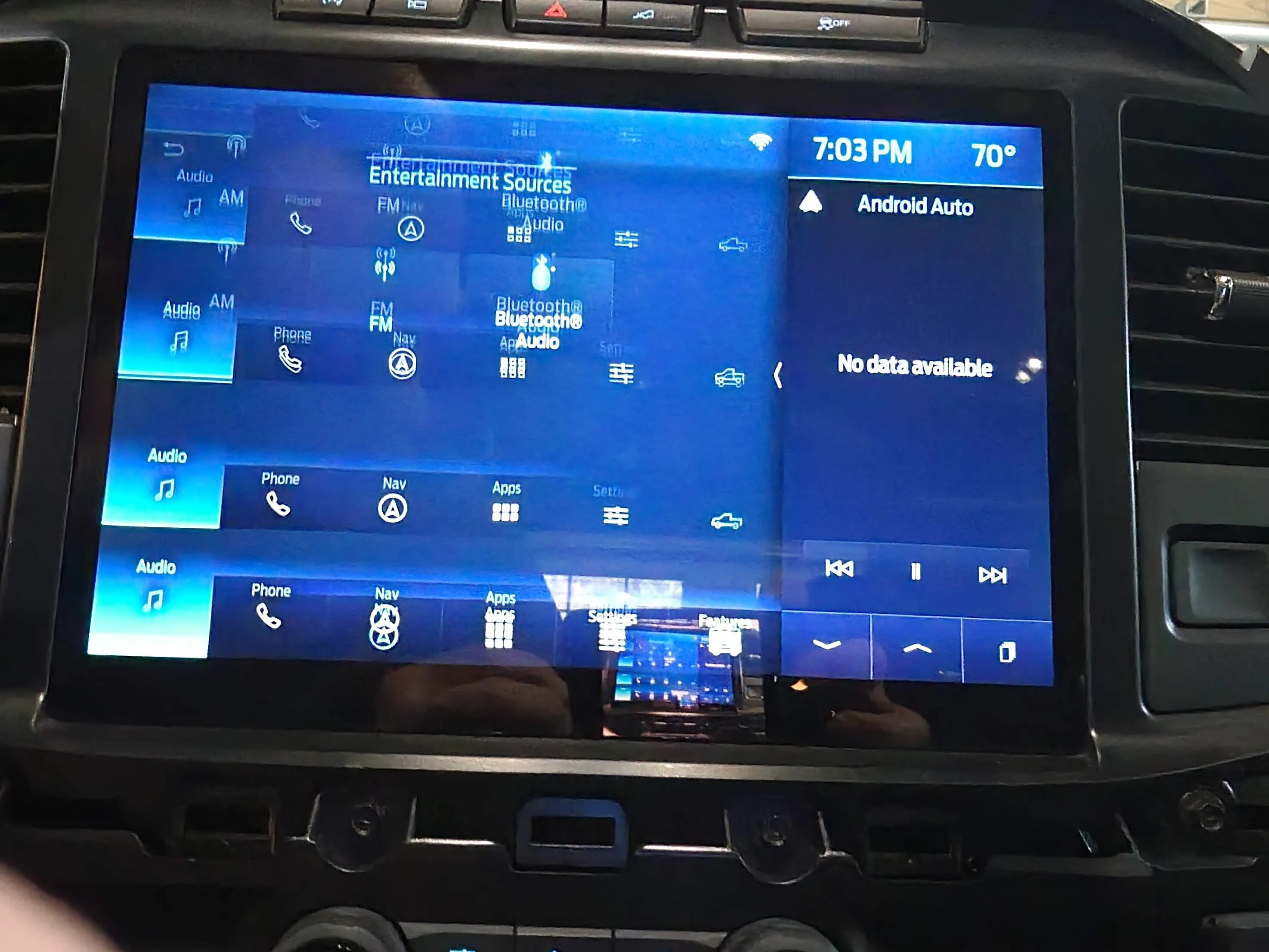

Hello I upgraded my display from 8 to 12 and have an issue with the display.
In the picture you can see the left side of the screen is the issue, the right seems to be working fine.
I think it could be a bad APIM but I wanted to check and update it first.
I have make all the changes needed with forscan and still no change.
I tried updating with FDRS and keep getting getflashactionpartnumbers.
I have tried PMI with and with out the old module.
I wanted to see if I missed anything before I replace the APIM, the APIM was new and never programmed as far as I can tell.
Thanks for any help you can give.

Have you reset the screen by holding play and ff buttons?

What forscan changes did you make ?
clmrhayden
Jan 18, 2023
Ellicott City
I used the base config attached in this thread and also tried just changing the line
Visual Design Variants (VDV)
7D0-03-01xxxxxxxxx*--0 =VDV 8" Landscape (Domain)6 =VDV 13.2" Ford (Dashcard)
1 =VDV 10" Portrait (Domain)7 =VDV 15" Portrait (Dashcard)
2 =VDV 10" Landscape (Domain)8 =VDV 10" Portrait (Dashcard)
3 =VDV 12" Landscape9 =VDV 13.2" Landscape (Domain)
4 =VDV 12" Portait (Dashcard)A =VDV 12" Landscape (Dashcard)
5 =VDV 13.2" Lincoln (Dashcard)

Ok, did you code a 3 for this one ?
