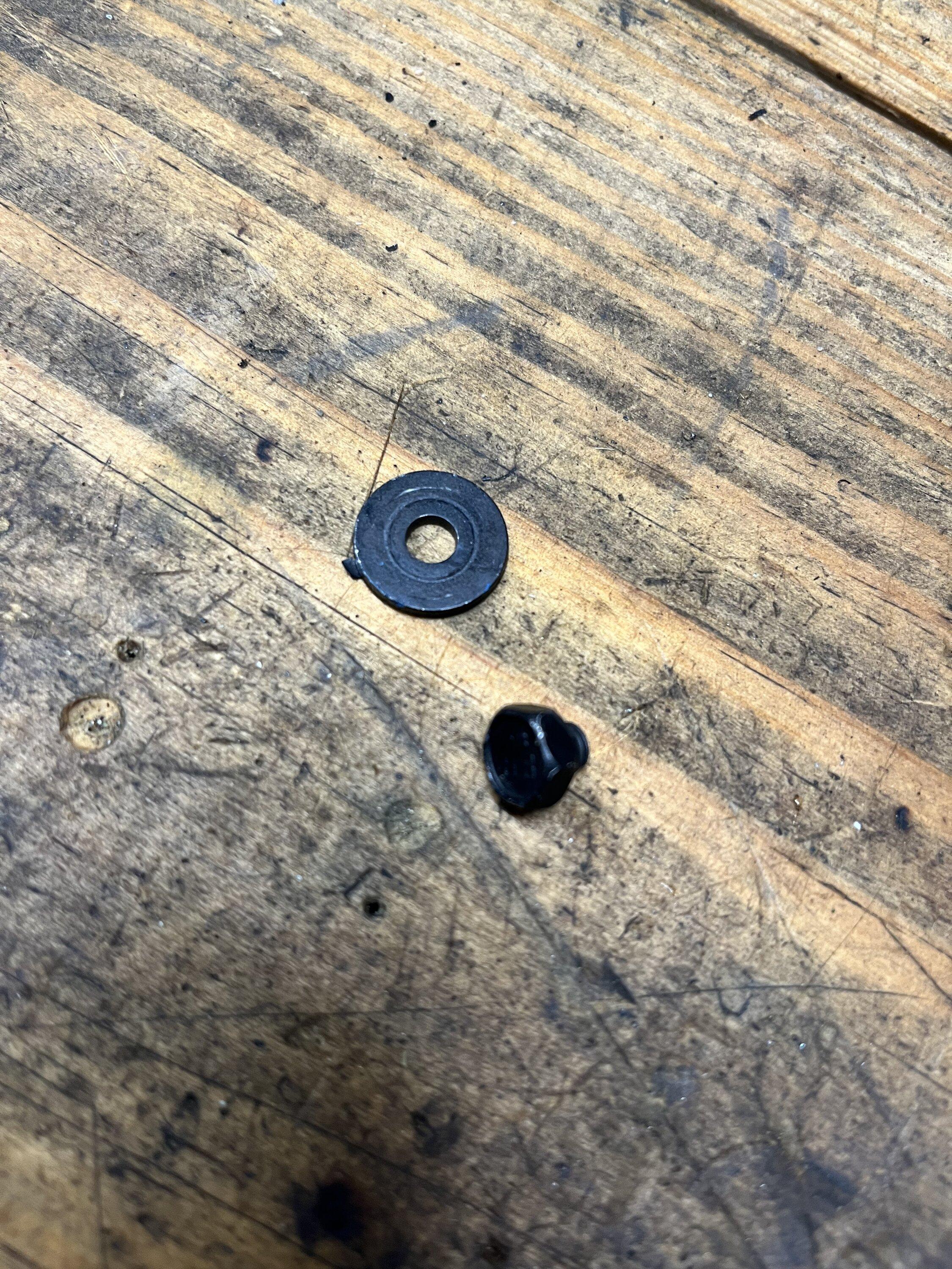

Add another. Took way too long but finally. I also snapped off two of the console bolts, the rear and middle on the passenger side. I used a 1/4” ratchet and went real slow, still snapped off.
Here’s one of them:
So, if anyone needs to know, the harness you can get plugs into the passenger side wheel well light plug.
I also found that I have the glove box light already. That was a nice surprise. I am going to buy the wheel well lights later on and have decided that I wouldn’t like the light in the console; seems overkill to me.
I too sheared off those bolts when installing my phone charging pad. Ended up drilling out the broken bolts and chasing the threads with a tap. I bought stronger bolts so this will not happed again.
