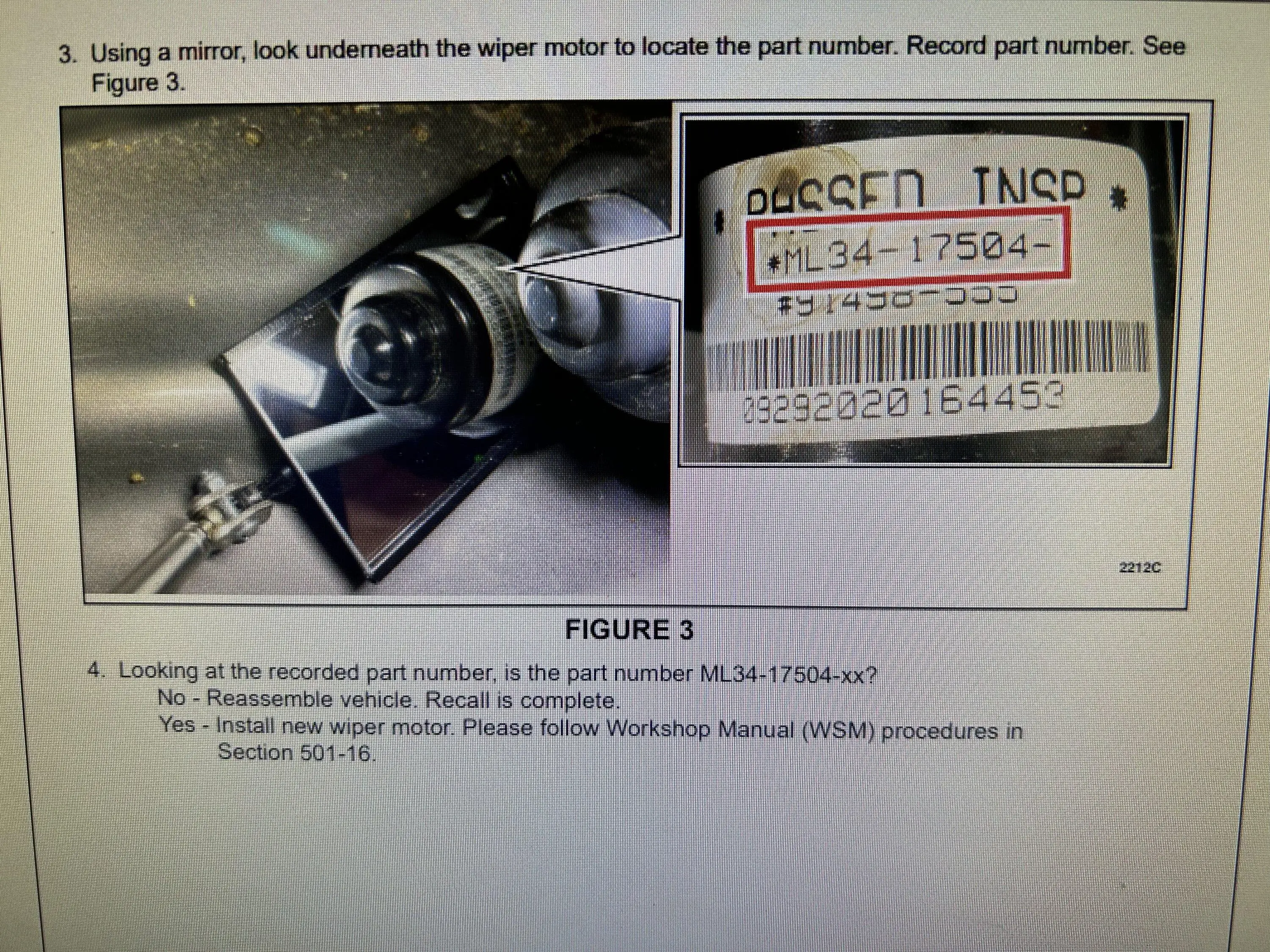

Do you have a listing of the xx? Part number suffix numbers to reference which wiper motors are recalled.
Example;
ML34-17504-AA ,AC, BA etc
It appears to be everything that starts with ML34-17504-. Not only a certain revision or range of revisions.
Is the motor easily accessable to check part #?
Example;
That’s right from ford. Suffix numbers don’t matter, as long as it starts with ML34-17504 it’s junk
Easy enough after pulling the wiper and cowl and using a mirror. No use to do it twice though, make the service appointment and have them look
