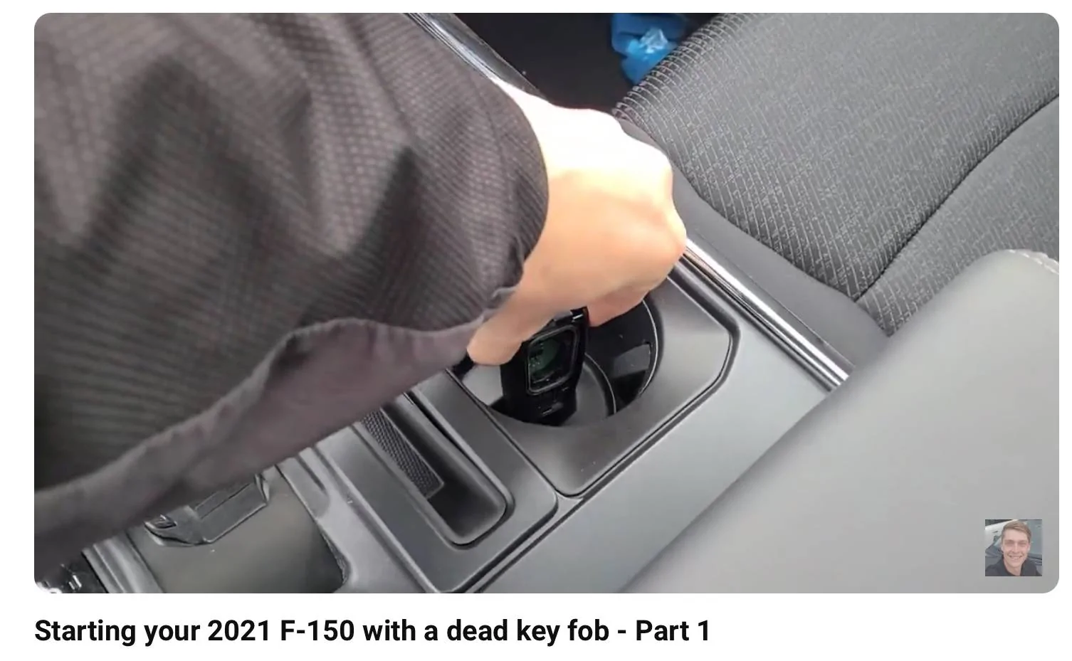

Under that mat in the bottom, is where you can insert your key to start the truck. I had to do that once: wife in car so kept it running, key in my pocket, went into a store. Truck would no longer recognize the key when I came back. Called dealer, they told me about this spot to stick the key in. Did so, and that fixed it.
Not correct. The place to install key is under one of the round cup holders (the one furthest from the dash).

Not in my '21. It's in the fold down shifter cubby.
Ford F-150 What is this for???? IMG_2965
Not what this video shows. The pic above is from a you-tube video concerning a 2021 F150. My 2024 Key Fob goes in the same place - cup holder.
