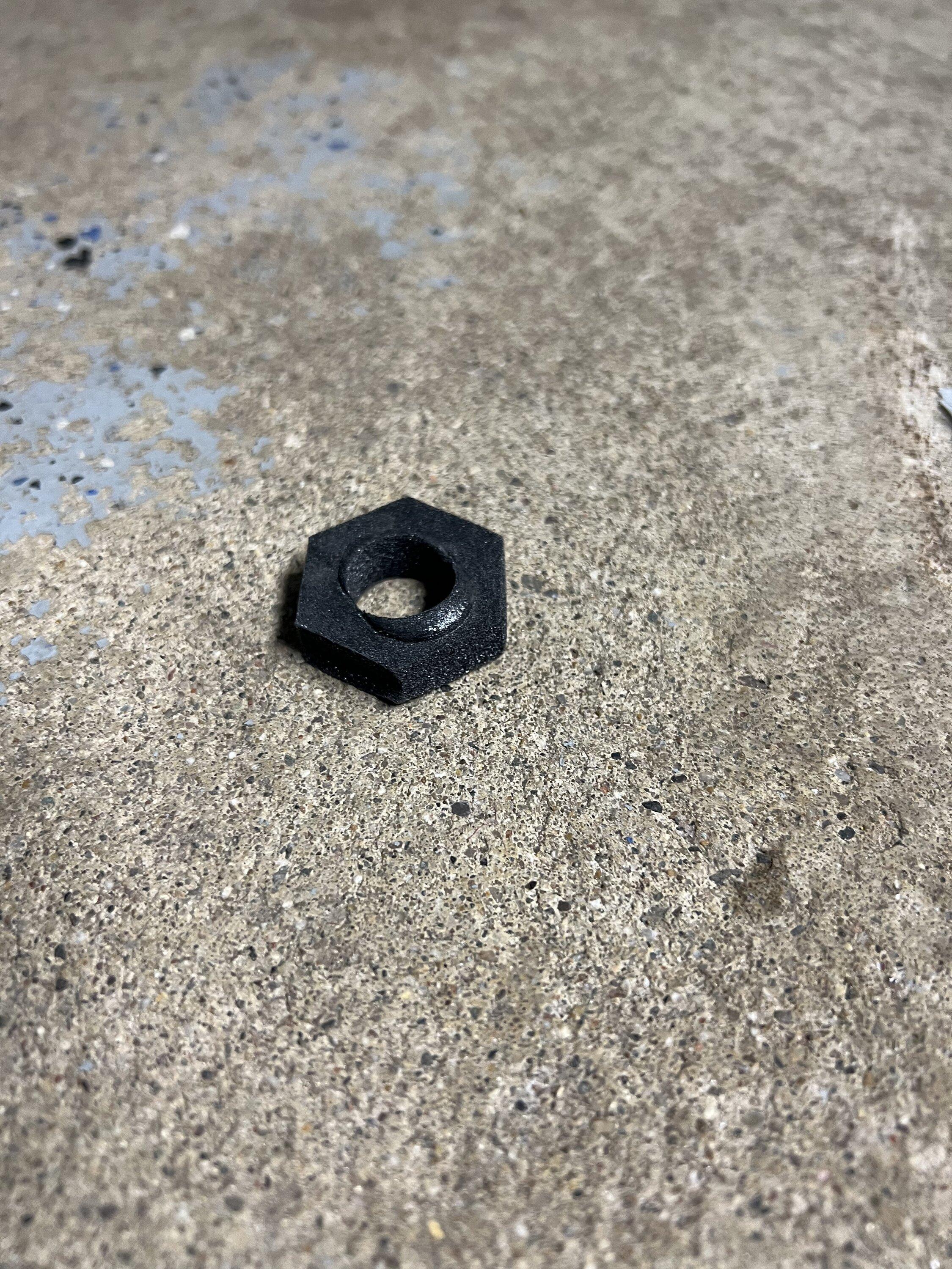

I pulled of the passenger side front door panel and two of these fell to the ground. If not obvious from the photo, they are black foam in the shape of a hex nut. Where to they go?

There are location pins moulded onto the back side of the door panel. These go over them to provide a cushion between the door panel and the door itself to prevent rattling.

Someone missed the hole...

Jmeo, THANK you. Right on the money.

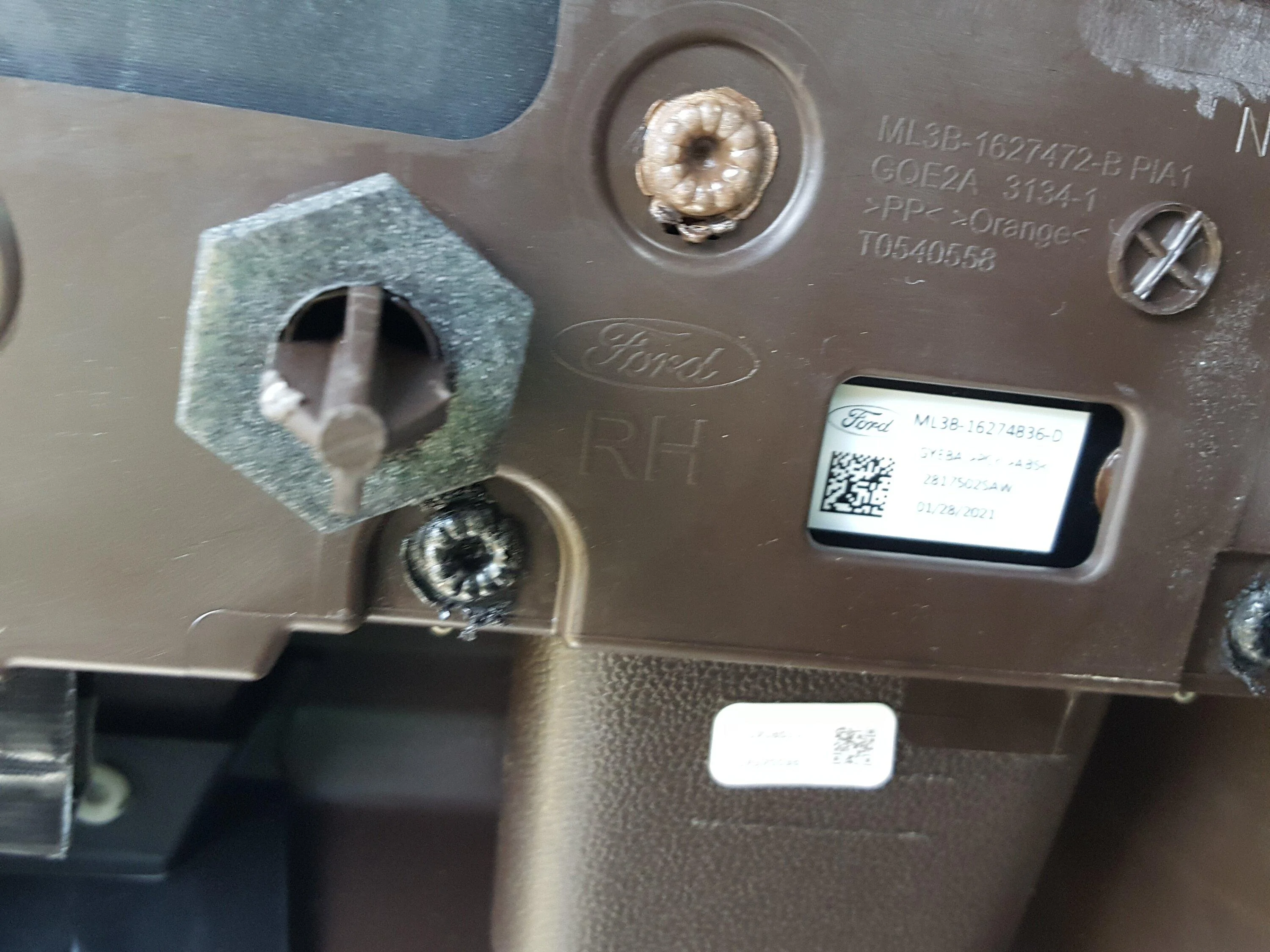

inside door panel on the pin
to soften the noises
