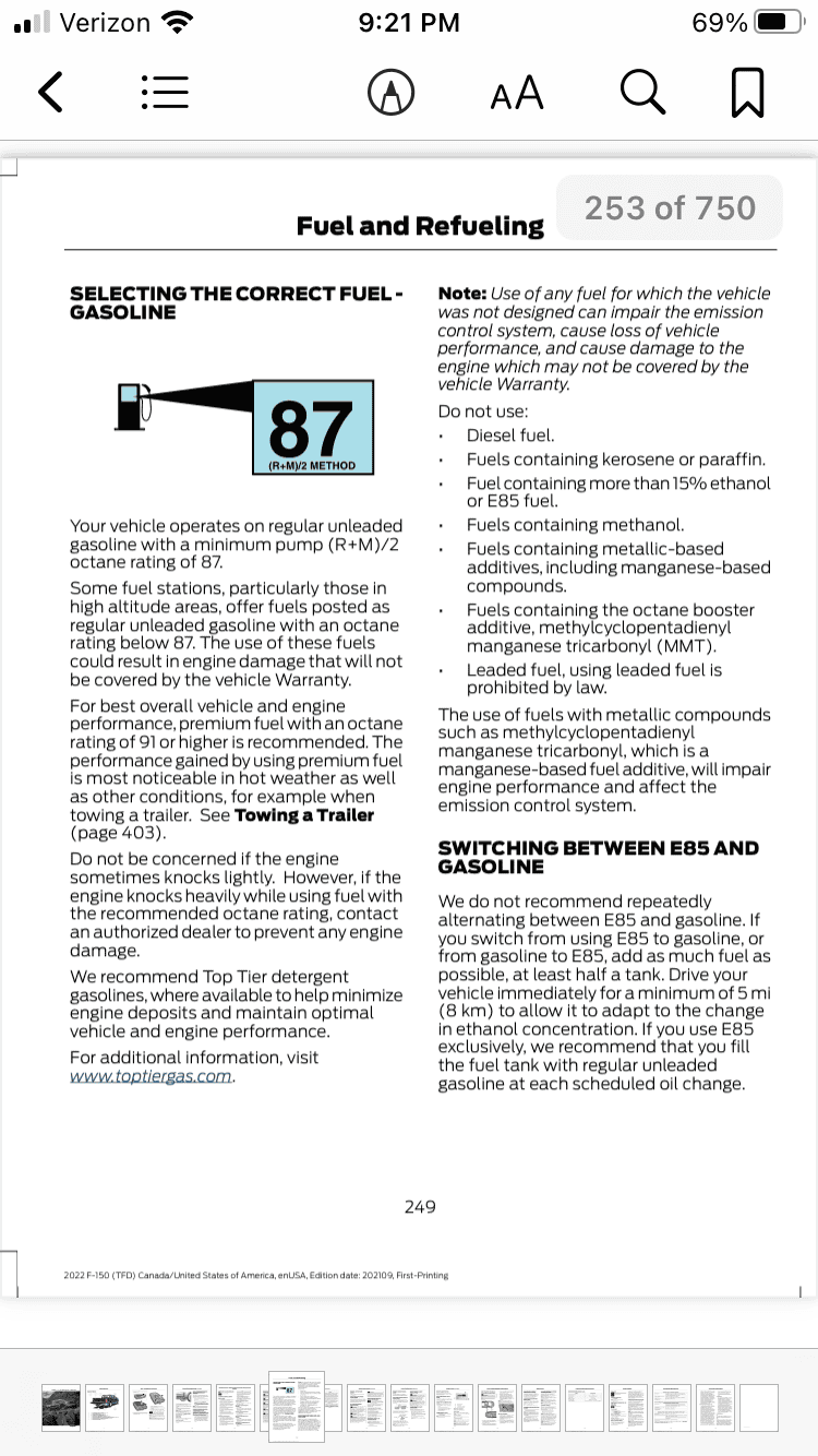

I thought that the manual says not to use E85? I recognize that when you mix it, it’s technically less than that, but it seems risky to me.
The page prior to this talks about a flex fuel vehicle, but I don’t think that my Powerboost has any of the indicators (yellow cap or bezel, etc).
“Do not use:
-Fuel containing more than 15% ethanol or E85.”
“Do not use:
It does. But I'm certain they meant by the tank full. :)
As the fella above pointed out, 5 gallons of the E85 that I pumped, combined with 25 gallons of E10, = ~E19
The tuning gurus that I trust vouched that the factory calibration (tune) is more than capable of accomodating E20.
