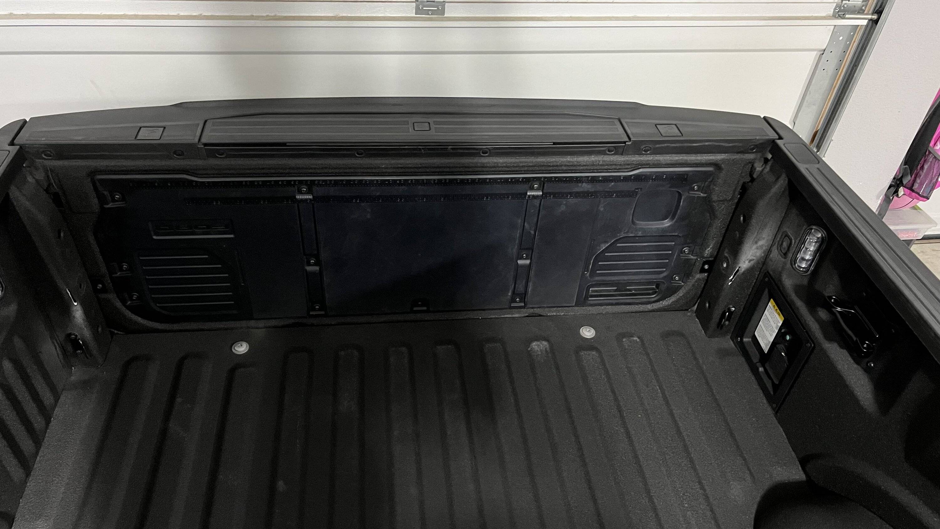

I just bought a 22 F150 and didn’t notice until I got home there were 2 identical cuts on each side of the bed near the tailgate.
I am assuming the last owner had something installed, but nothing is coming to my mind that would require these cuts. So here I am asking all of you, does anyone know of a product that requires these cuts on install? Also, is it worth fixing? What would you repair it with?

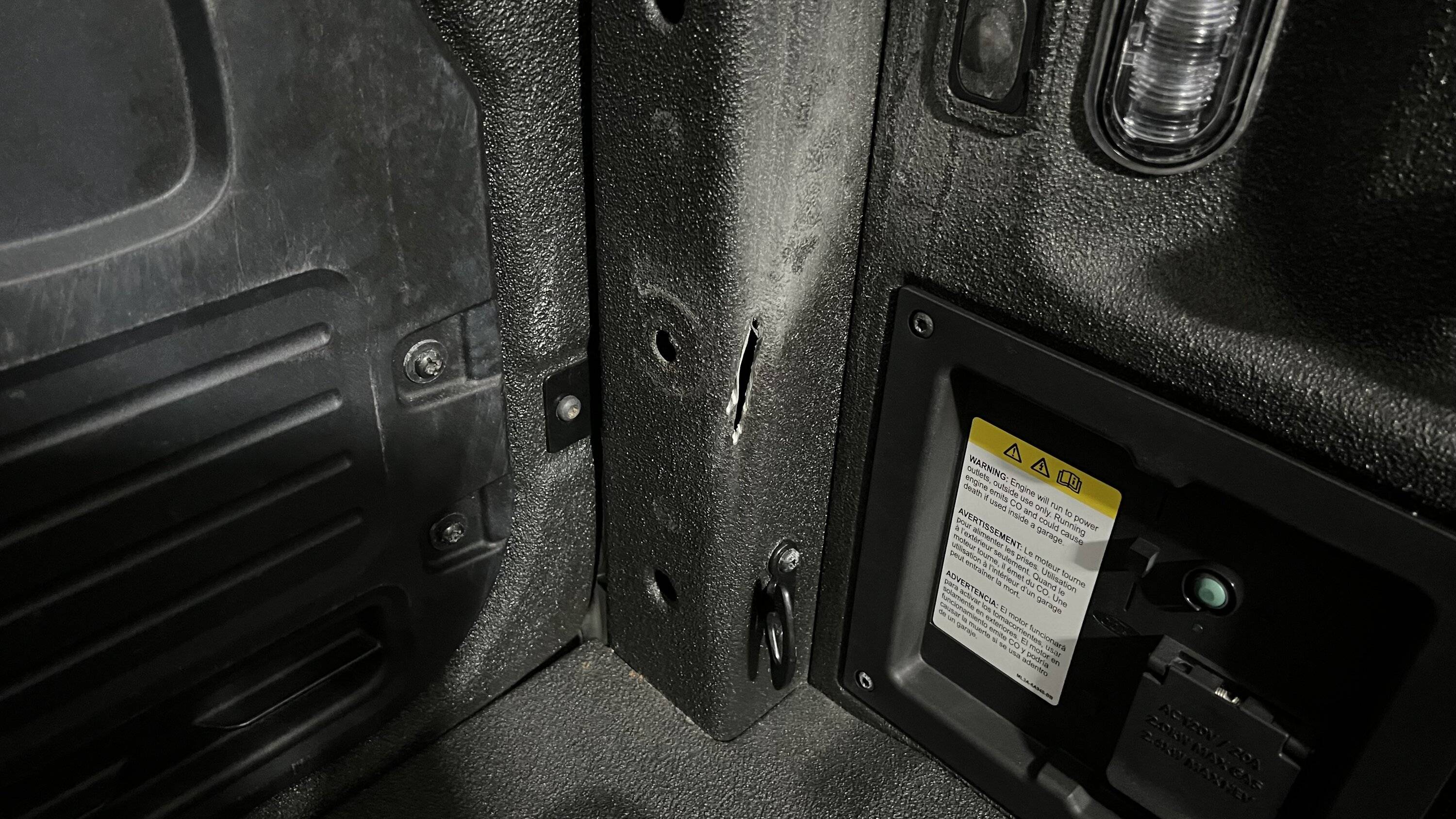

Looks like they had a bar across there? And they used the slits to put in a wrench to tighten a nut/bolt there? Odd. I'd be dissatisfied with that.

To me it look like something was mounted to the holes which are 90 degrees from the cuts. My guess is that the cuts are for insertion os either a tool to tighten a fastener or a fastener itself.
Without welding there probably is not way to fix them. But you could fill them with some JB Weld and then paint over the epoxy to hide.

No telling what it was. The grind cuts are pretty sloppy. Maybe try to remove some of the spray bed liner fill with some bindi then recoat with bed liner. Not sure how it would look but better then a couple holes
ooof -- wth?
You can access both sides by removing the taillight. To patch that I'd use JB weld "kwikweld" from the back side first, let it harden, then carefully fill in the front side to the desired texture. If you get the 2 tube variant, you can mix in a little little bit of carbon black (like 1:20 max) to part A of the mix before mixing in part B to make a nice black colored epoxy. (run a test batch first) --- Carbon black can be had for ~$5 and as its name suggests is carbon.

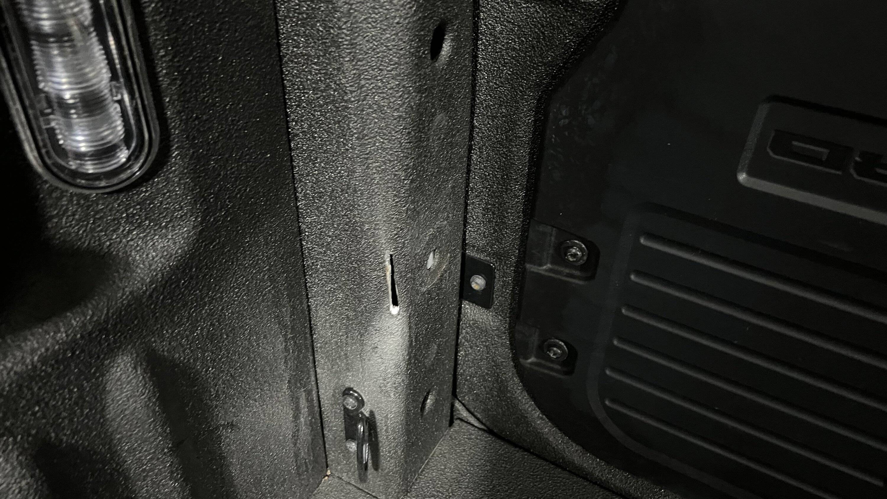

looks like the previous owner had a bed extender of some type. Looks like they were lazy and didn’t want to remove the tail lights to get to the backside of the hardware for the pivot so they cut into the bed to insert a tool or cut the bolt.
I would fill that in with JB Weld. Once tacky, you can use your finger in mimic the stippling that then can be smooth down to match the texture of the spray liner.
I would do two things. First I would draw hole at the end of those cuts, using a quarter inch drillbit. This will prevent that cut from possibly cracking in the future.
To make filling the hole a little bit easier, I would remove the tail lights. You can then apply tape of your choice to the backside of both cuts. It will make filling them with whatever you decide to use much easier.

Thanks for everyone’s opinions on this one! I’ll look into your suggestions on the fix. Also, thanks for pointing out I can get to the backside by removing the tail lights, that should allow me to make it look a bit better when I try and repair it.

Caulk it with black silicone. Doesn't look like it will affect structural integrity. Repairing it with a weld will require repairing the bedliner also.
