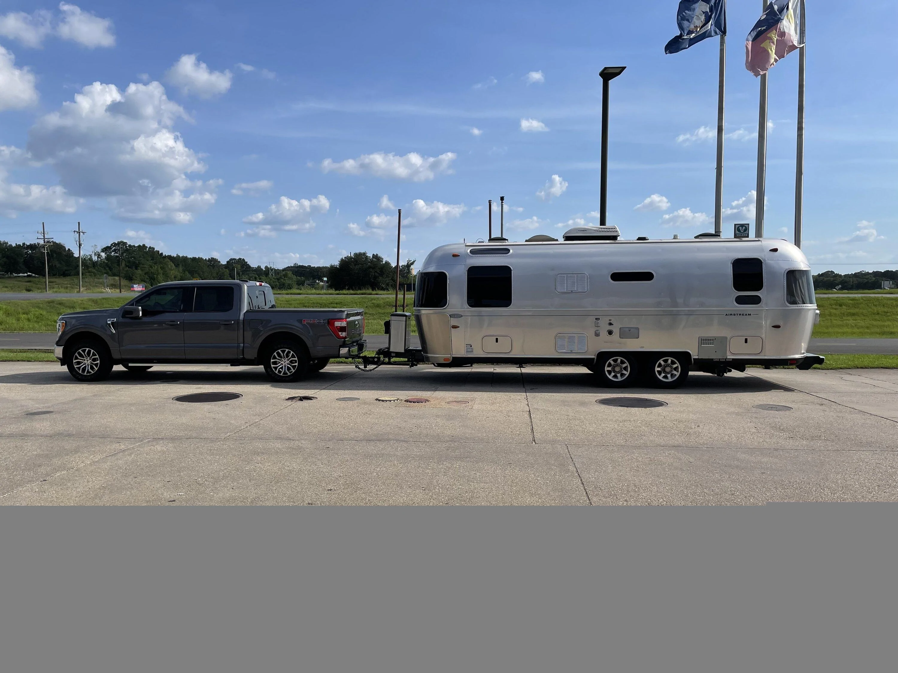

I saw this post last night and didn't get a chance to respond but you made the correct choice and picked the hitch I would recommend. It eliminates sway AND you don't need the fancy new "Pro-Access Tailgate" to get into the bed when hooked up. The hitch sits back far enough to drop the tailgate all the way without hitting anything. Plus, it tells you the weight you have on the tongue of your truck so you can perfectly dial in the appropriate load and distribute the correct amount of weight to the front axle as well as shift any weight in the trailer if necessary. It completely takes the guess work out of setting up a WDH and to me, that's gold. On top of everything else, this hitch tows like a dream. When towing my Airstream with my '21 5.0, I saw absolutely no wiggle in the trailer and porpoising down Louisiana bridges were immediately eliminated by the hitch.
In short, this is the only WDH I'd own.
