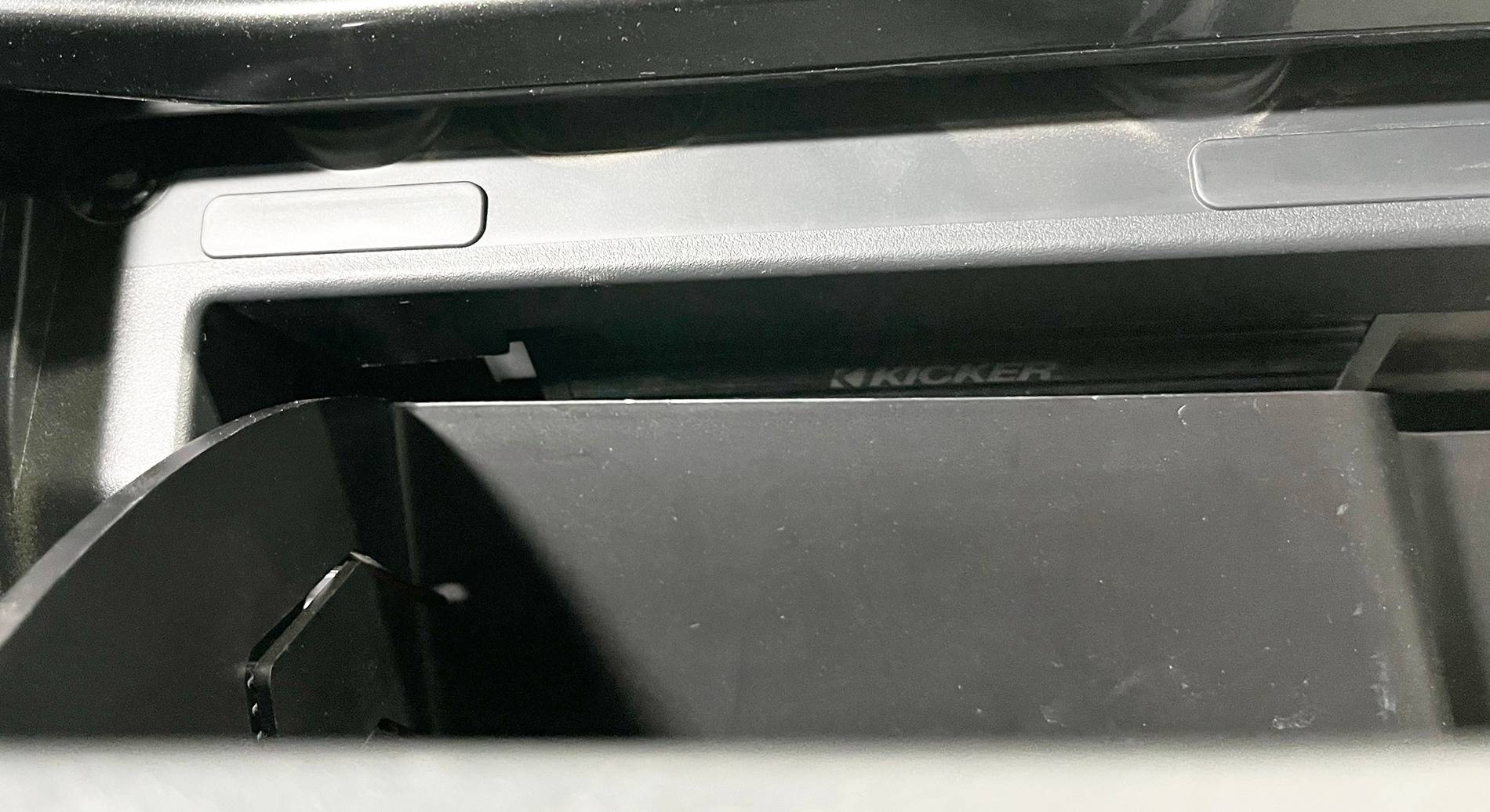

Ok yeah mounting the key was way easier than I thought, this is starting to become a pattern. So grateful for all these folks making harnesses and such great info posted here, this speaker upgrade has been a blast because of it. I'm sneaking away to fiddle on it every moment I get.
As @TexasTruck posted here, I mounted in what I thought was the exact same location however I didn't have to trim anything at all and the glove box opens & closes fully without any interference. Mine is an XLT so maybe higher trims have more stuff back there to get in the way? Not sure but that was a nice surprise. Here is a close-up of the location. I used velcro and just angled and pulled it against the upper compartment while tucking it into the fascia that the main glove box stops on.
Here it is fully open, you can kind of see the logo and such back in there.
