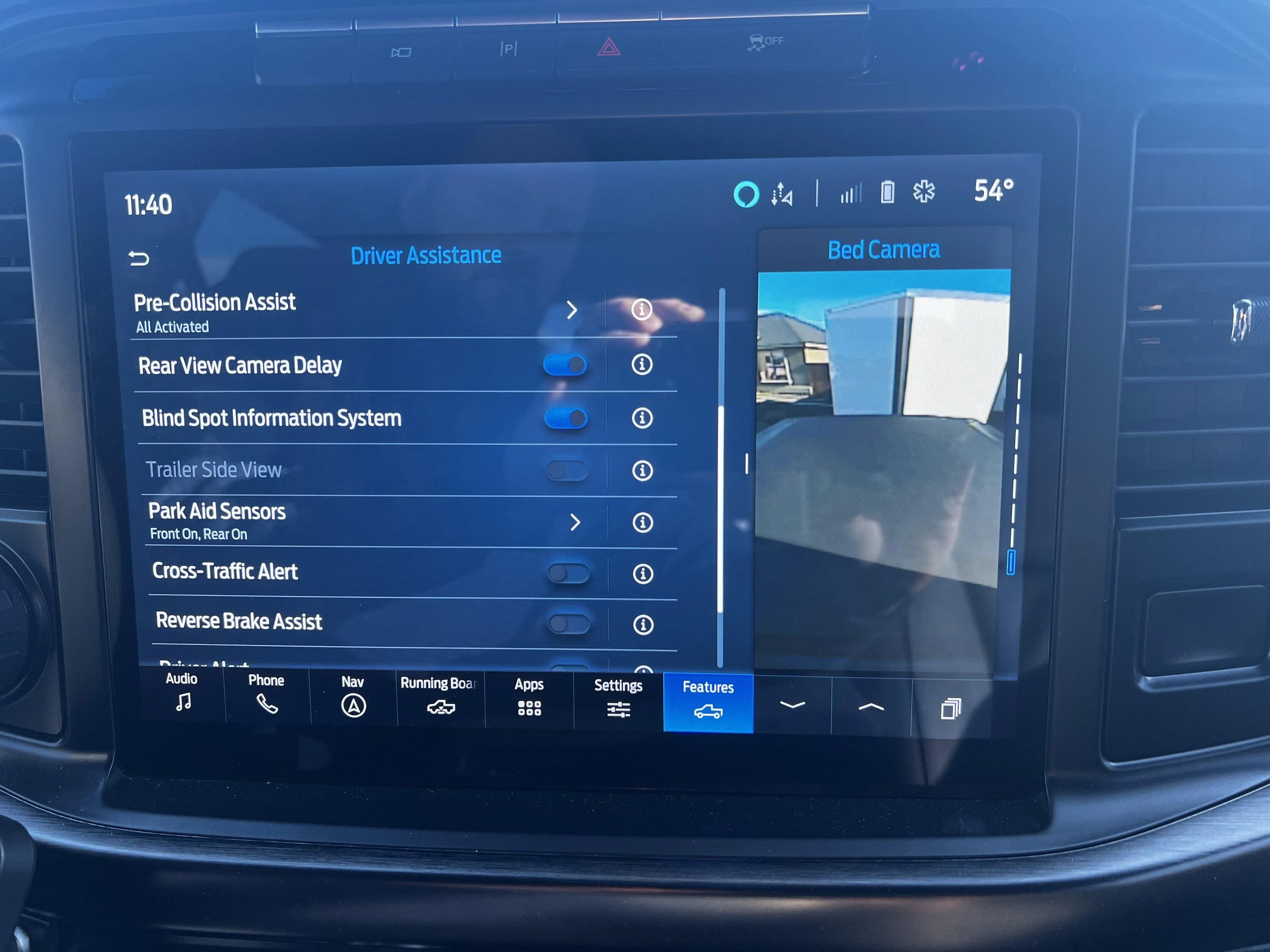

Ford F-150 Turn Signal Cameras??? IMG_1880
Curse you trailer side view button not available.
Come on SantaRuge, we all want signal cams and BlueCruise 1.99 for Christmas!
i’m pretty sure trailer has to be connected in order to toggle the trailer side view.
DK4
Jan 23, 2022
333
382
Truck
how come it is showing up in your head unit then? i must be missing an important detail or two.
It’s there because I did Forscan changes to add it on there. Problem is my truck just isn’t capable of actually doing it because my truck is an ancient 2022.
I think everything is described in this very thread. Or spread out in the forum possible.
My trailer is connected in that pic btw if you look close in the bed cam view.
We should get it soon.

Naw. We need an IPMA update from SantaRuge. Unless you have a 23.
I have the IPMA files for an EcoBoost, but I do not have the knowledge on how to install it. If your truck is an EB, I can send them to you if you're the "f*ck around and find out" kinda person. If you brick the truck, I won't be able to help.

I actually have an ipma with 2023 files on it for my 2022. I did that to get BC 1.2.
Do you think it's possible that this works on my EB?
I'm gun shy to screw with my truck after last months bricking.
BTW I'm testing out the Comma 3X with openpilot. It doesn't require any changes to the trucks soft/firmware. So far it's a step back in some ways and a step forward in someways compared to BC 1.2
Then yes. All you need to do is the two FORScan changes that @B-real mentioned in the first page of this thread, and go to the menu in the touchscreen to toggle the feature on. Just remember: Until someone figures out a work-around, it only works with a trailer hooked up.

What every ones updates looking like I heard there’s a 6.8 out there now could that be the one lol?
No. 6.8.0 is an IPC update.
Still need the IPMA update to hit before the Forscan changes will work.
It is coming... Eventually.
I have the necessary Forscan changes on my truck already so I'll see if it works when they finally drop IPMA via OTA.
