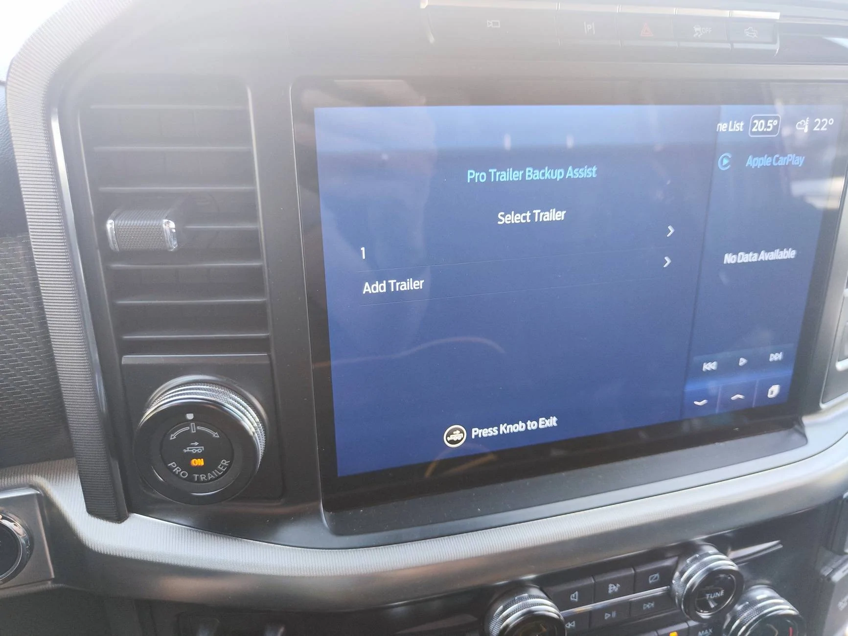

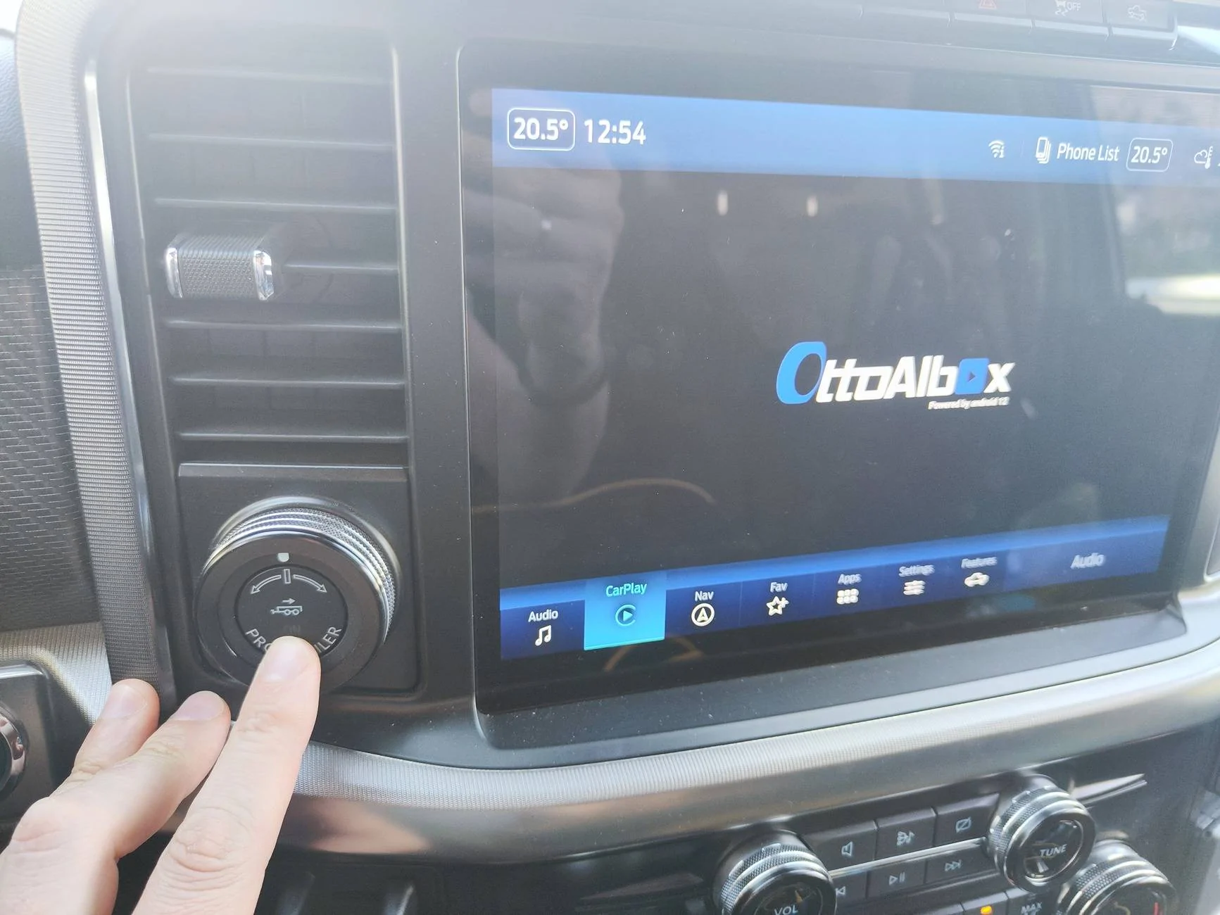

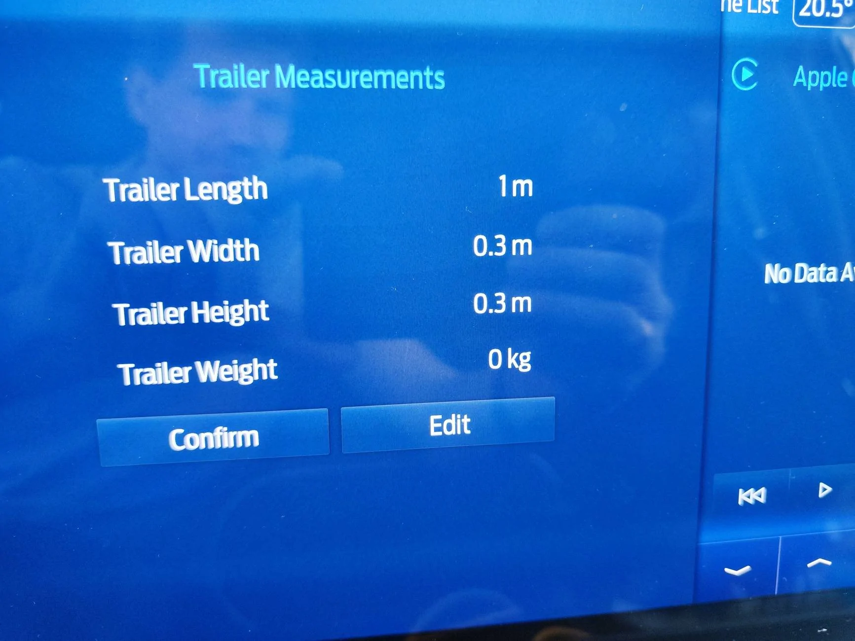

Hello,
I've been reading and following this threat for a while driving 2023 f150 raptor.
Cameras in motion, wide cameras with a button click - all worked fine after config with FDRS and forscan.
I came across info to wire resistors on 4pin trailer connector to emulate the trailer. I connected 4 cheapest 100Ohm resistors between 3 wires and 4th ground. Naturally they burned immediately, but that didn't make my ford think that trailer isn't there. He this trailer is there.
Minimum length, weight of the trailer, lost rear park sensors (keeps saying trailer is connected and sensors are disabled once I put in reverse), but side view cameras started to work on sync4 screen.
It has been 2 days I'm driving with it, cannot say I enjoy and get used to looking to mirror and then central screen, but if you want to try - that's the way to go.

Hello,
Thanks for posting this! I could never get my tiny LED bike rack lights to make this work. Research lead me to believe the LED's just did not offer resistance to make the truck think something was working properly. I then thought about cutting the LED lights and attaching some regular bulb lights to see if that would work. It looks like it might. However I never got motivated enough to go through the work. I may try again someday.
