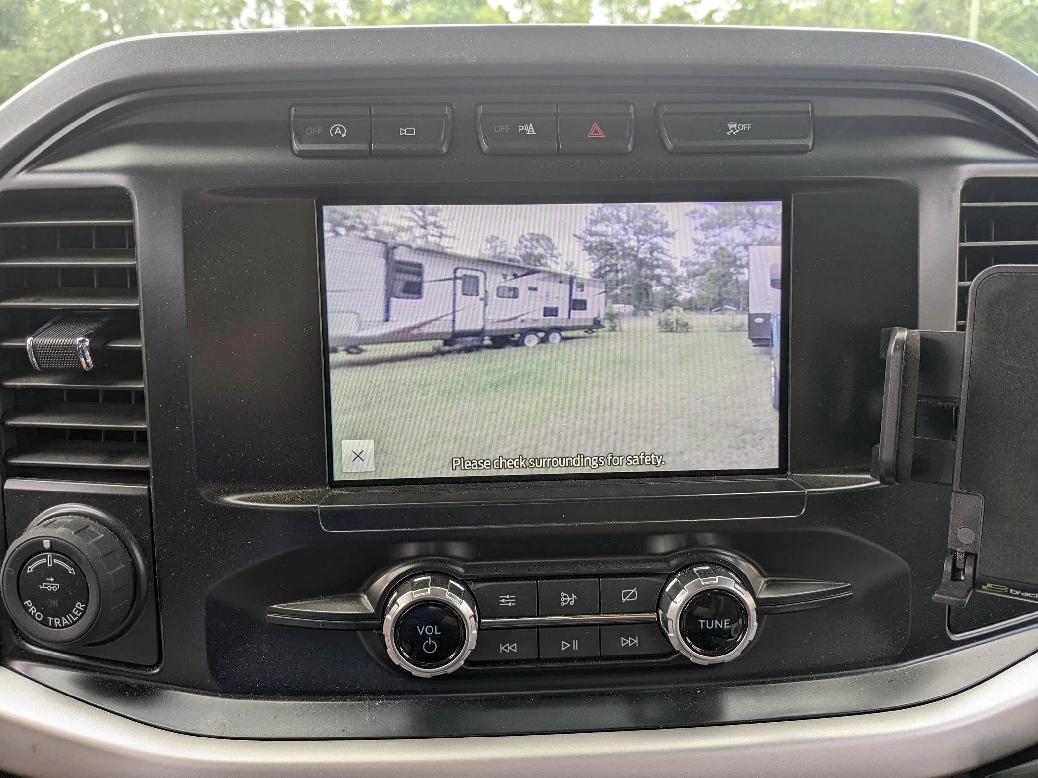

I successfully added trailer side view to my '21 J1 XLT HDPP using FDRS and one of the Mongoose cables @rugedraw so graciously lends out.
It's impressive. It works whenever the blinker is on, whether temporary for lane change or engaged for a corner turn. It returns to the previous screen when the blinker turns off but I've seen it stay on the 360 view after the turn view. I haven't determined the conditions for that event.
The bottom pic is the hard-wired Ford trailer camera. It doesn't have IR lighting like the Furrion it will replace but I have bright LED backup lights.
W/ left blinker on in storage lot

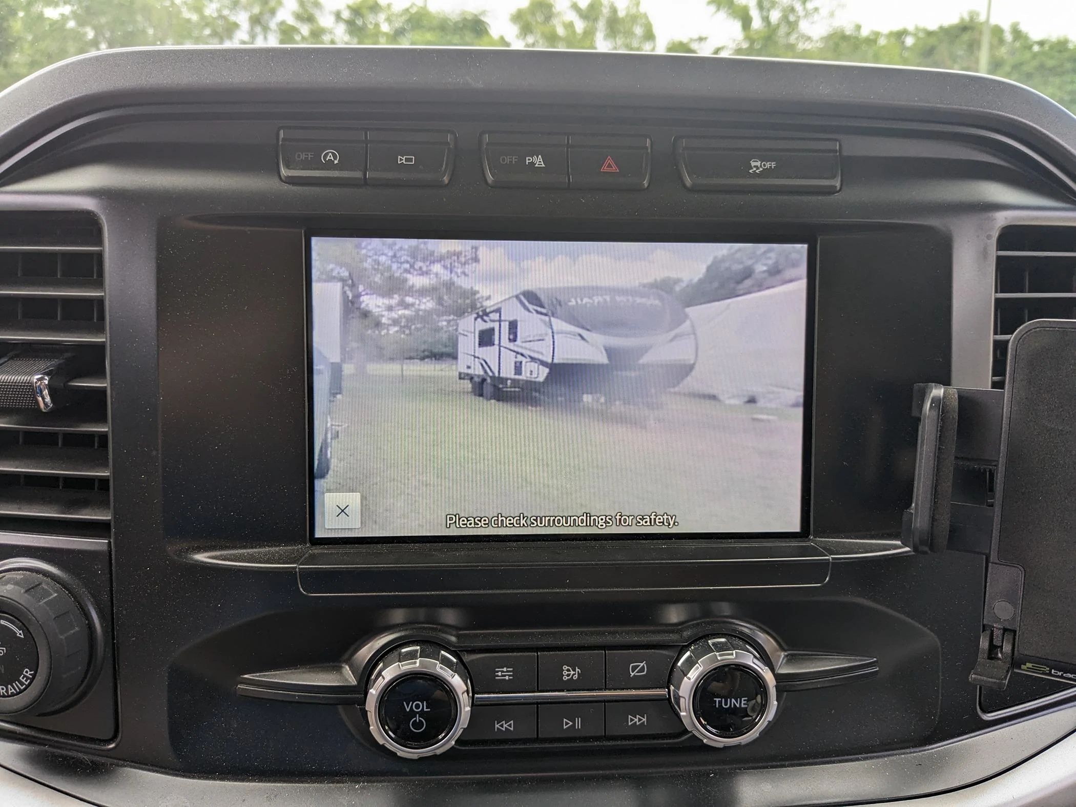

Ford F-150 Turn Signal Cameras??? 1000002836
Right blinker on storage lot.
Ford F-150 Turn Signal Cameras??? 1000002837

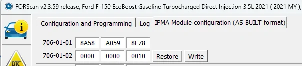

Ok, need help :)
I double checked my settings. Restarted IPMA & APIM, but still not able to enable it in the menu with trailer connected (its grayed out).
I did noticed that when I write "3" in IPMA (706-01-02) it keeps getting reset back to 0 when I re-read module after writing it. Is that normal?
