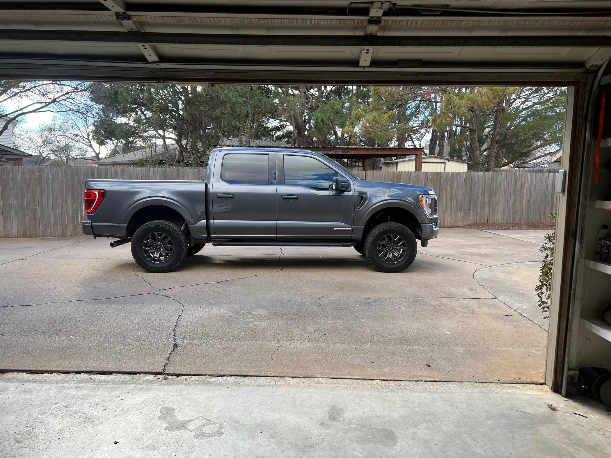

Ford F-150 Tremor suspension on Powerboost 20240330_202941

I put ICON uppers on my 2018, with Fox 2.5 DSC. I don't think I really needed to, but it was arguably helpful for the alignment fella?
ive got the UCA delta joint pro with the tubular arms, sitting in the garage.
These look great!
