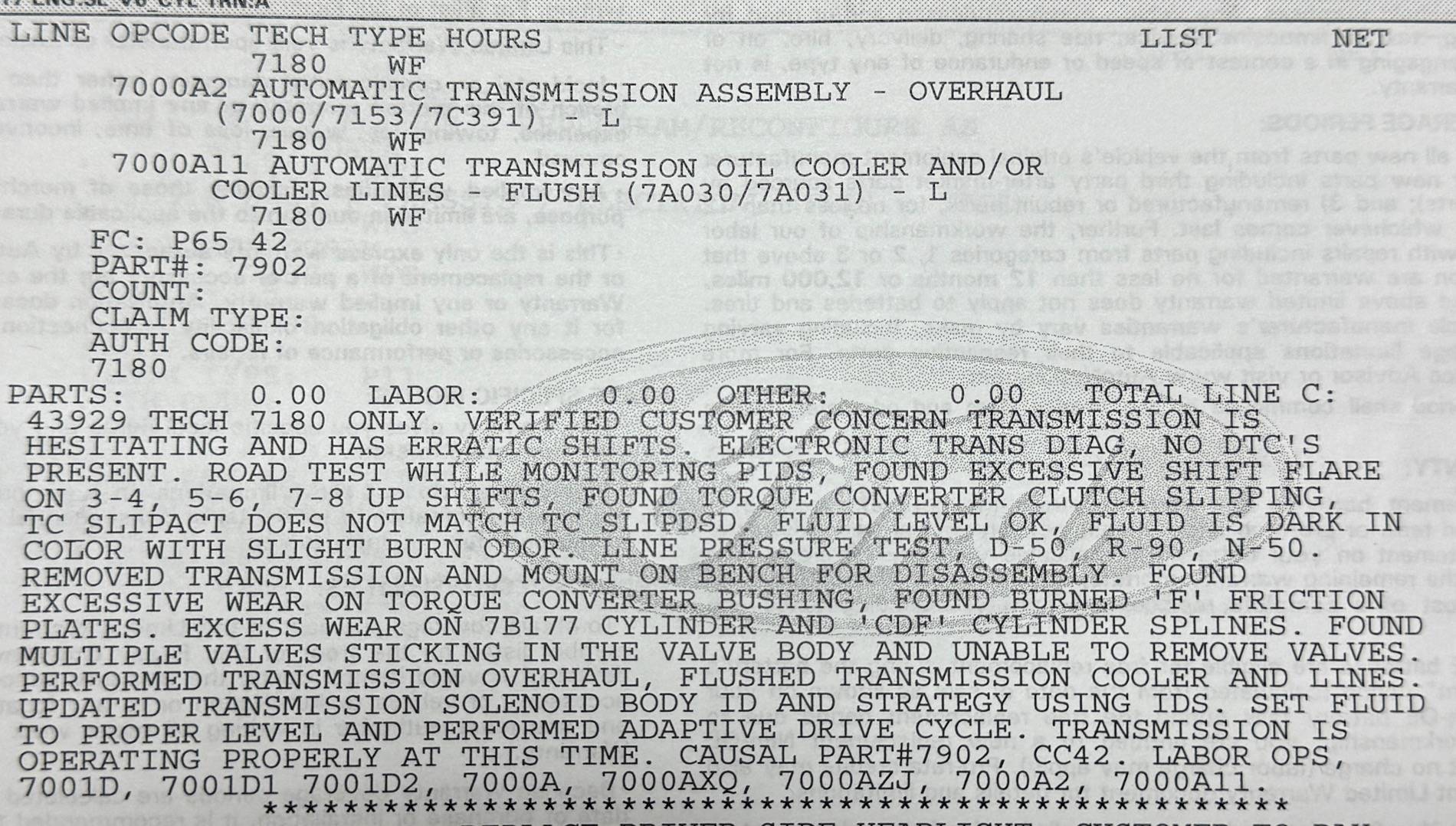

Guys Im smitten. The tech replaced the valve body and jeeeeesus its a damn good trans now. No more rough 3-4-5 bullshiiit, no more speculation, I can finally go full LOG Laid to Rest. Patrick at Groove Ford in Denver has commendations.

My truck somehow destroyed its transmission with only 42,000 miles and got all new pieces including a valve body and solenoids and drives really nice now.
My trans has been off since Day 1 of ownership and is acting extra suspicious lately at about 33,000 miles. Dealers of course can't replicate anything, so I'm kind of hoping it grenades itself soon, too.
